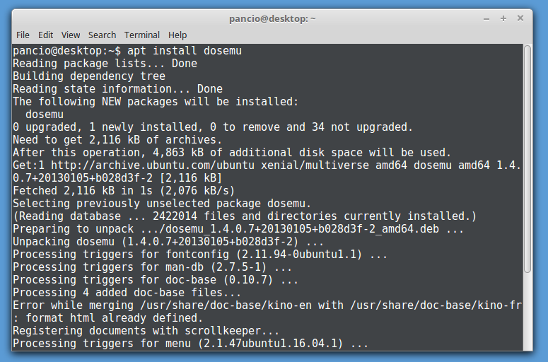

First, install 'dosemu':
apt install dosemu
<Important>
Since Linux Mint 21, dosemu package is not distributed anymore.
Please use PPA method:
sudo add-apt-repository ppa:dosemu2/ppa
sudo apt update
sudo apt install dosemu2
</Important>
DOSEMU install process

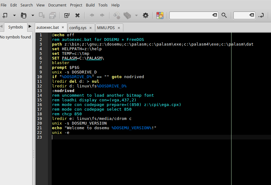

Before run PALASM you should do a few more steps:
1. Edit AUTOEXXEC.BAT file and add:
path z:\bin;z:\gnu;z:\dosemu;c:\palasm;c:\palasm\exe;c:\palasm4\exe;c:\palasm\dat
SET PALASM=C:\PALASM\
AUTOEXEC.BAT edit
AUTOEXEC.BAT edit
