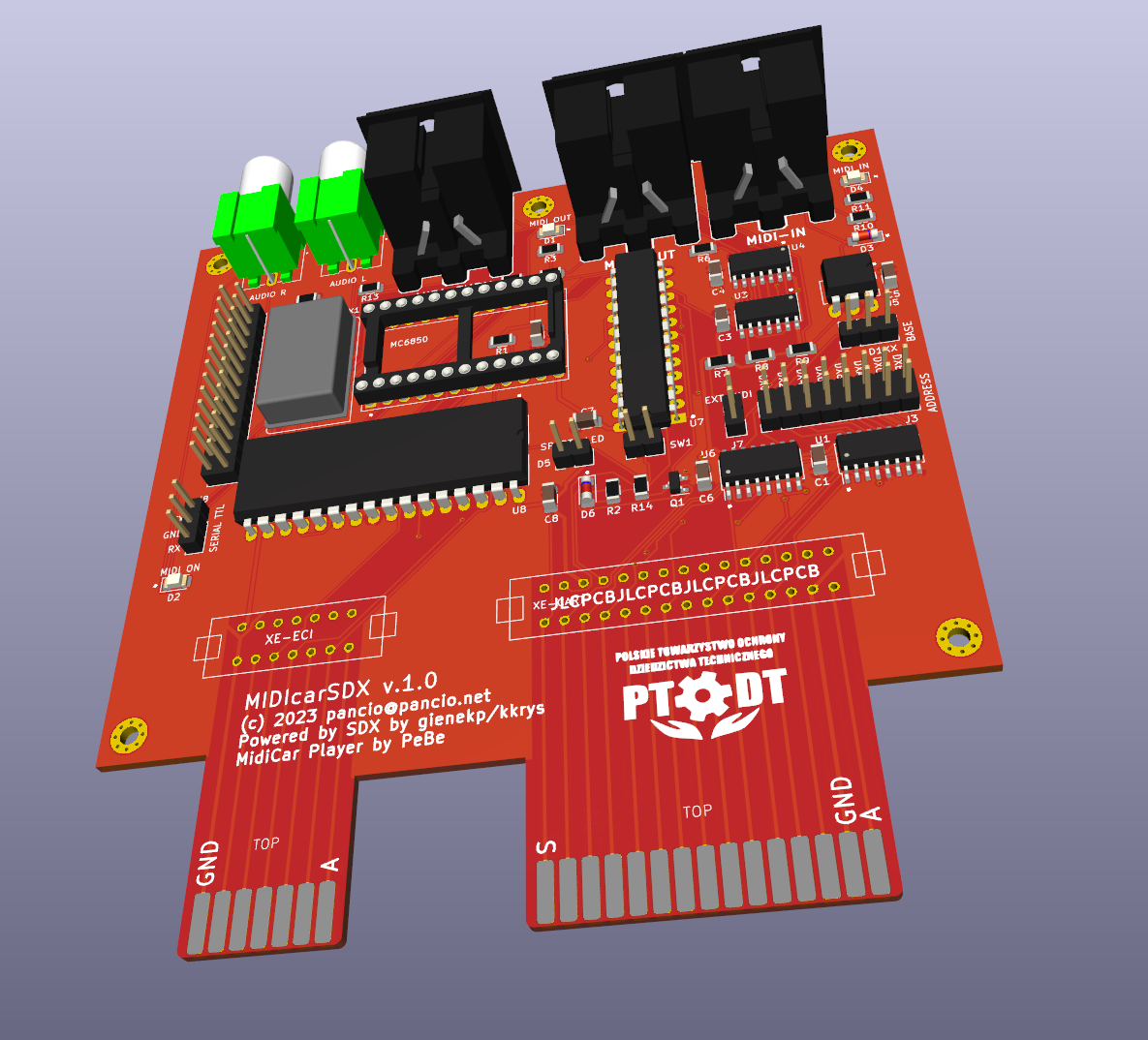

MIDIcarSDX Prototype PCB

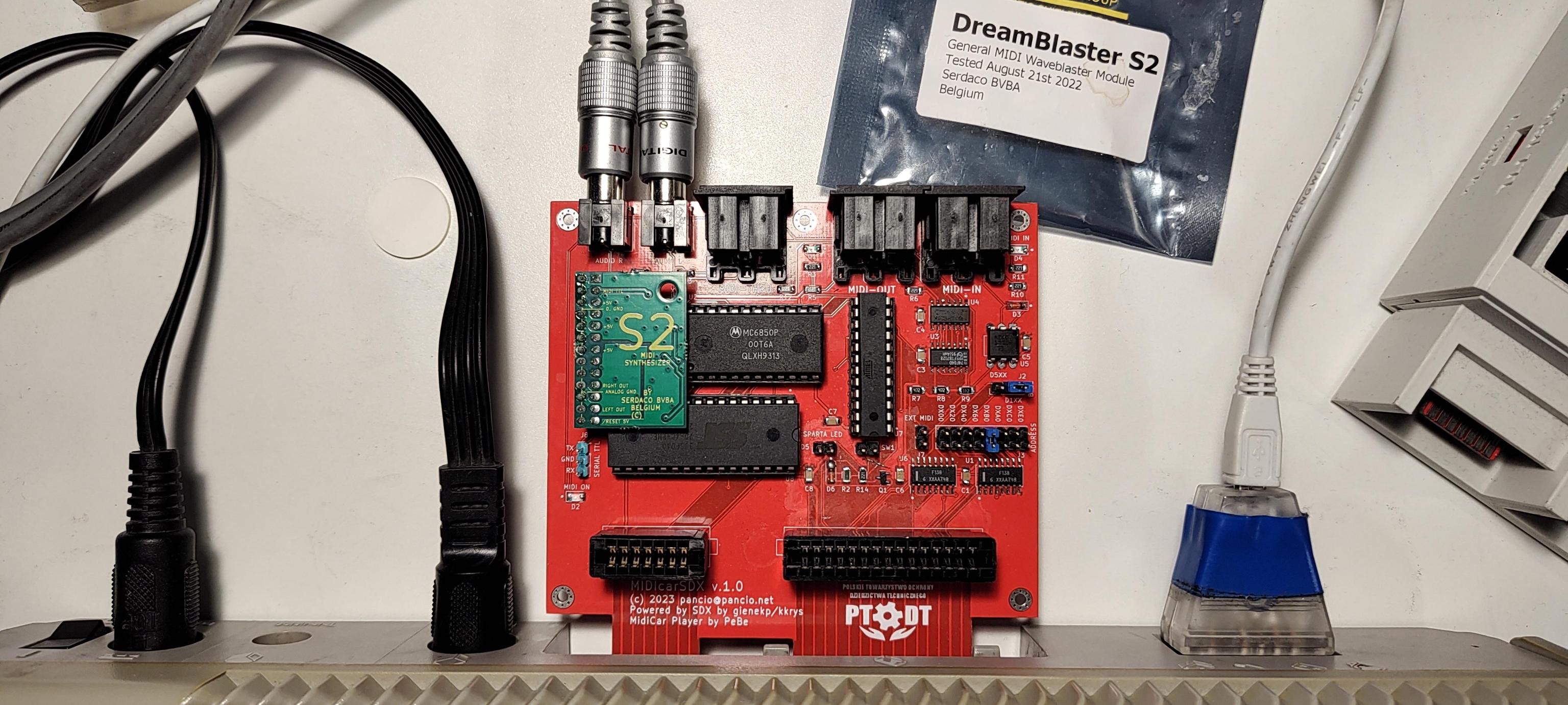

MIDIcarSDX working prototype

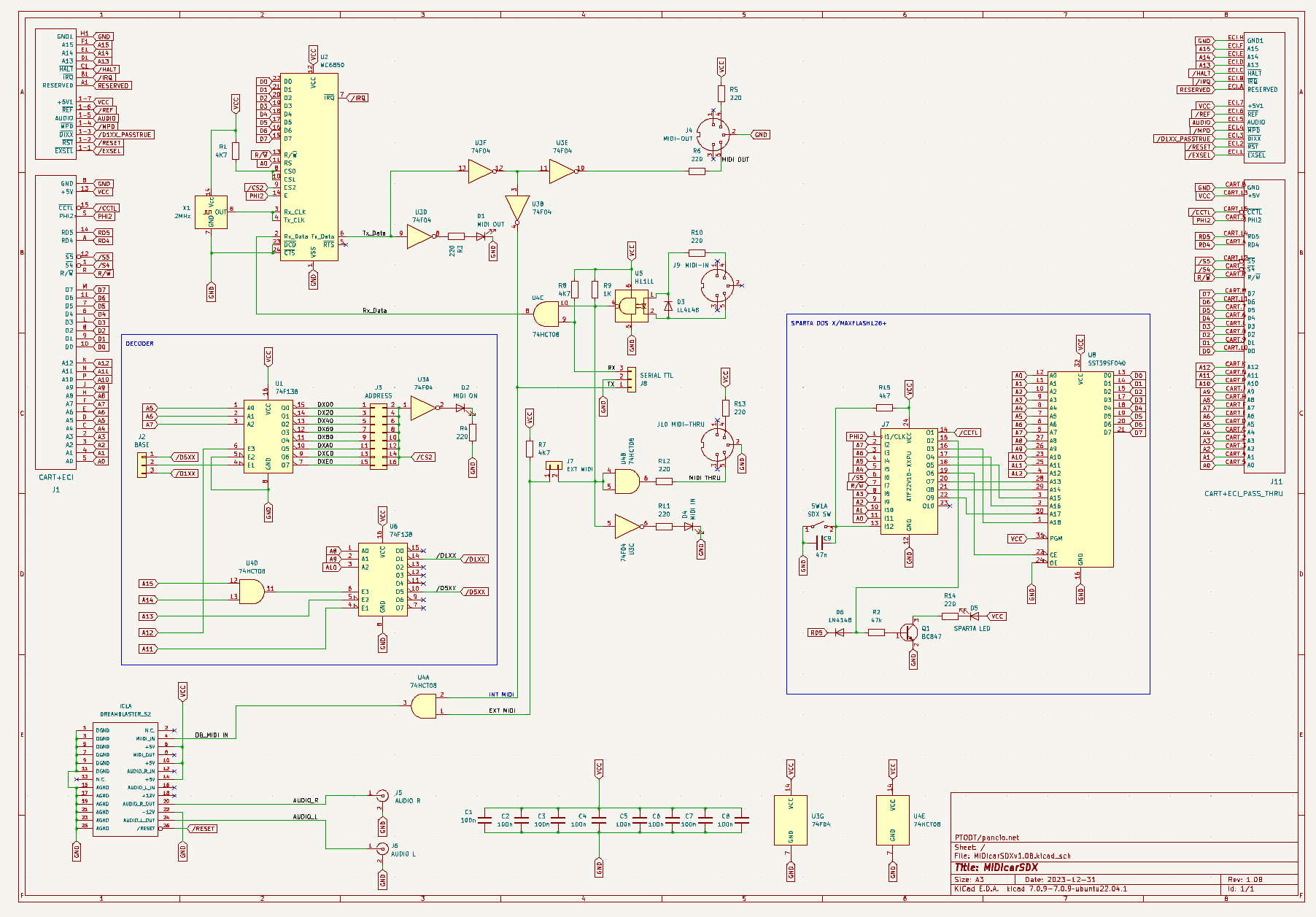

Schematic
Schematic
