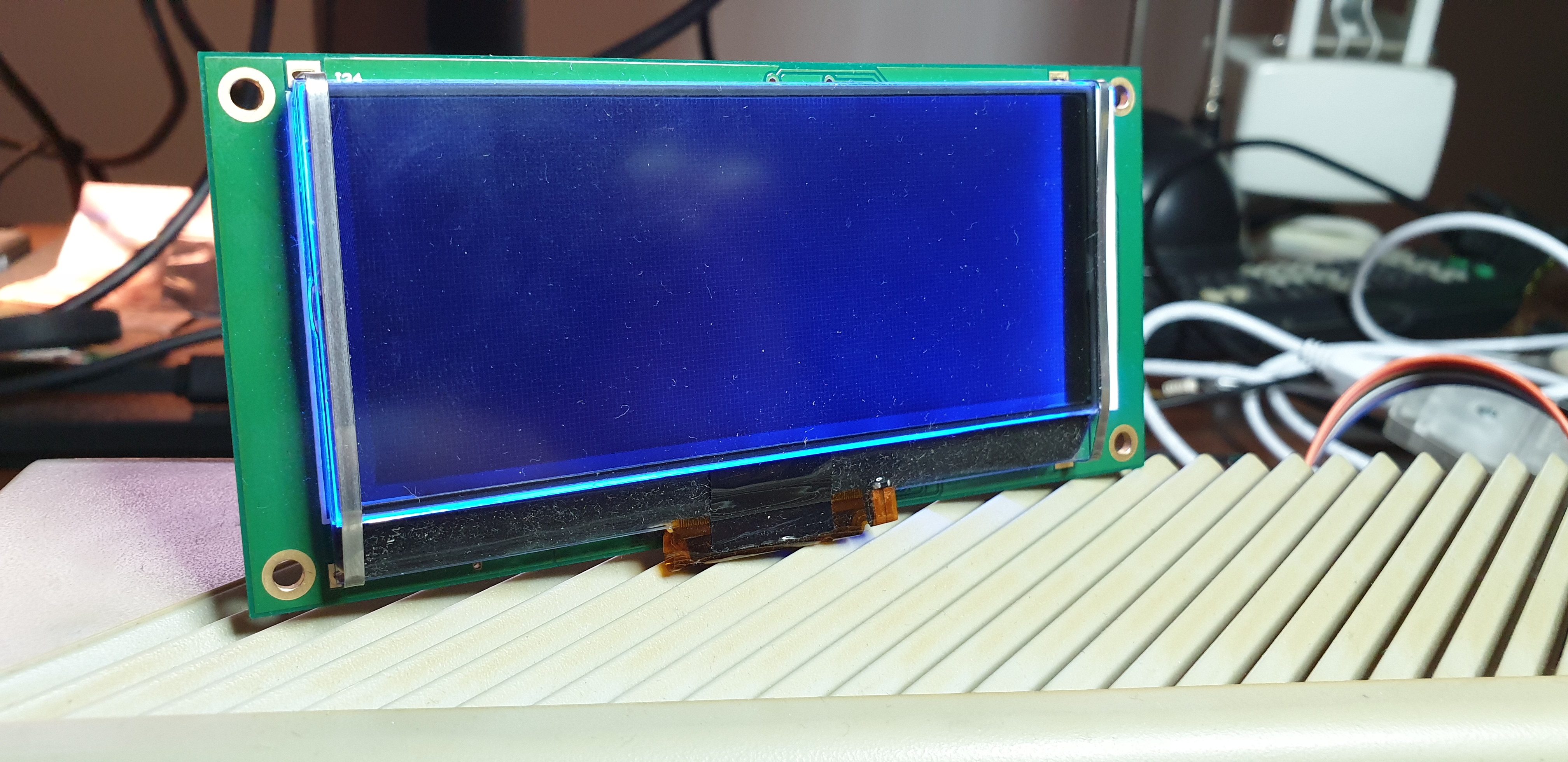

I'm glad to present the first GLCD 162x64 connected to Atari:
Blank screen S1D15705 connected to Atari

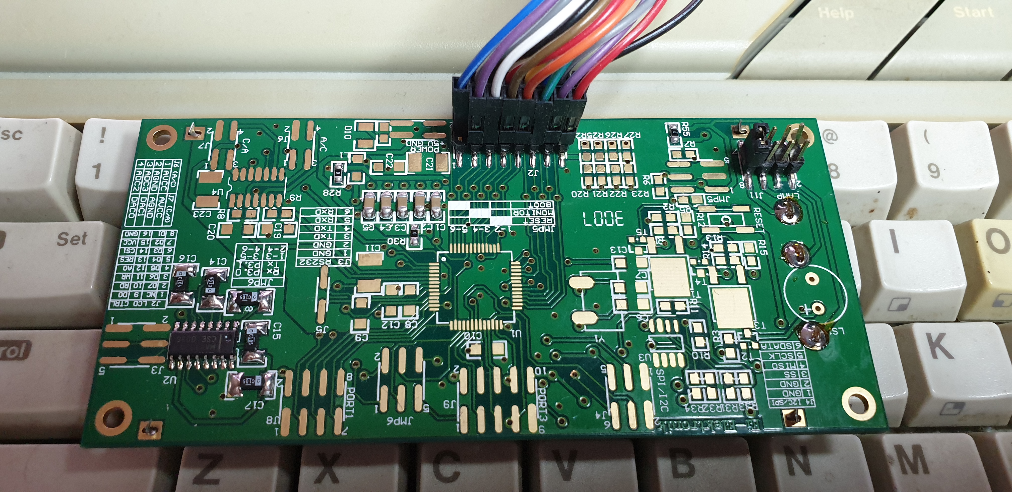

In order to connect GLCD I used both parallel ports - PORTB is a data bus and PORTA is for control signals. Actually I used only 5 signals, so rest may be use for other stuff.
PCB of S1D15705
PCB of S1D15705
Detail regarding wiring you may find in attached software.
