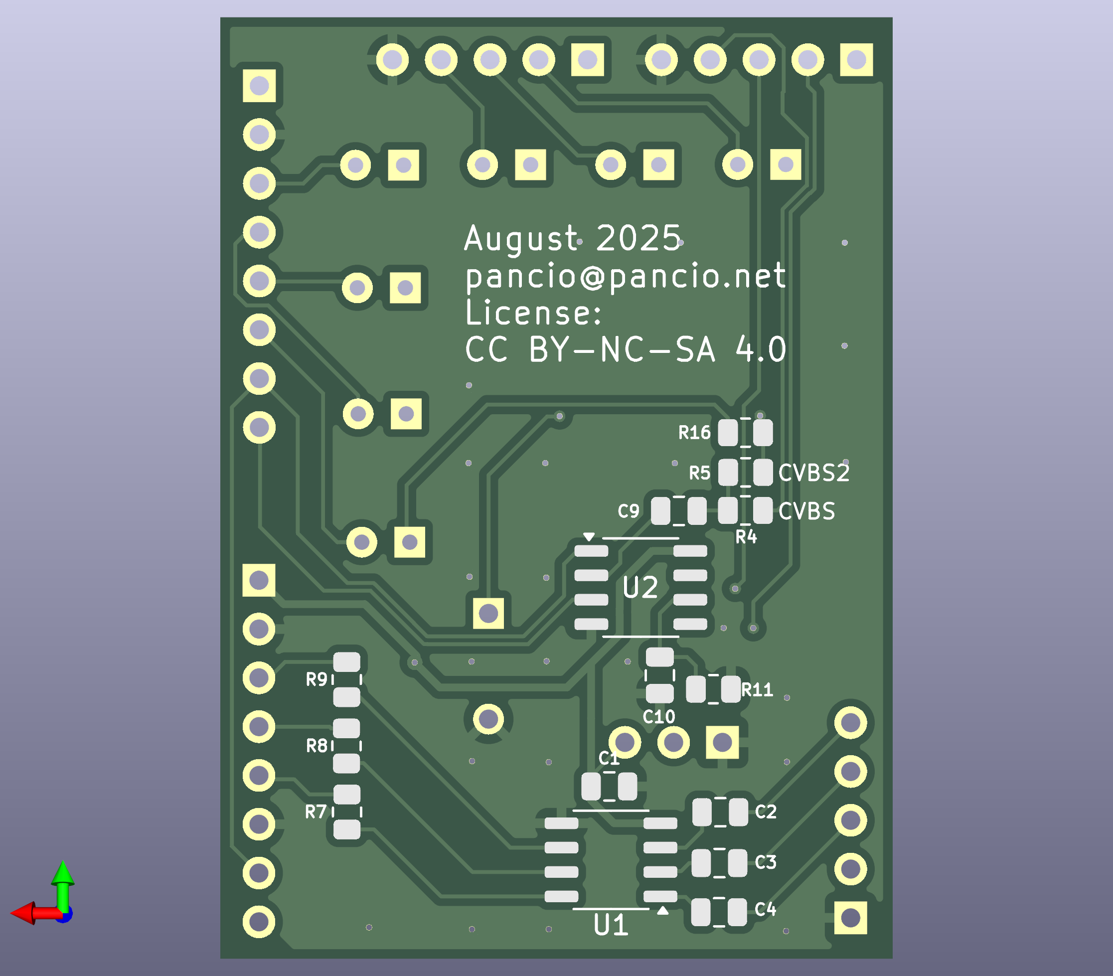

The CXA2075M simplifies board complexity because it doesn't require as many passive components as the CXA1645M. This also allows for a smaller PCB footprint and easier component placement.

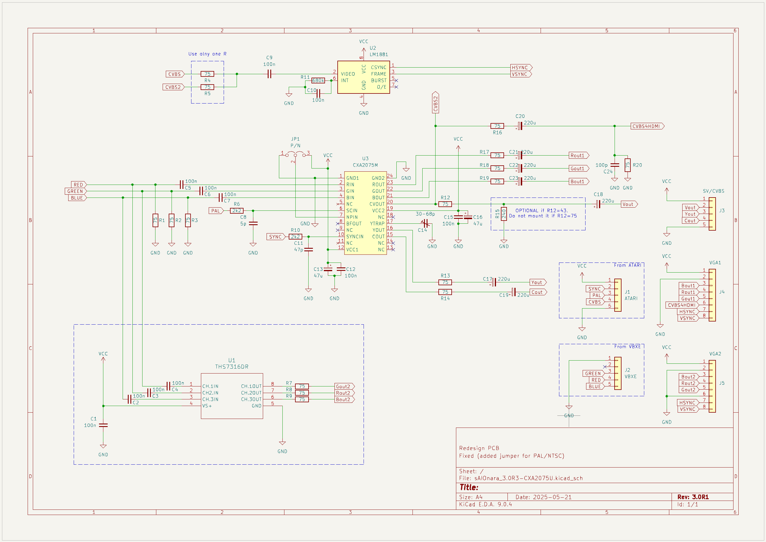

Schematic
The device structure is shown in the diagram below:
SavoNARA-2075U
SavoNARA-2075U
Board

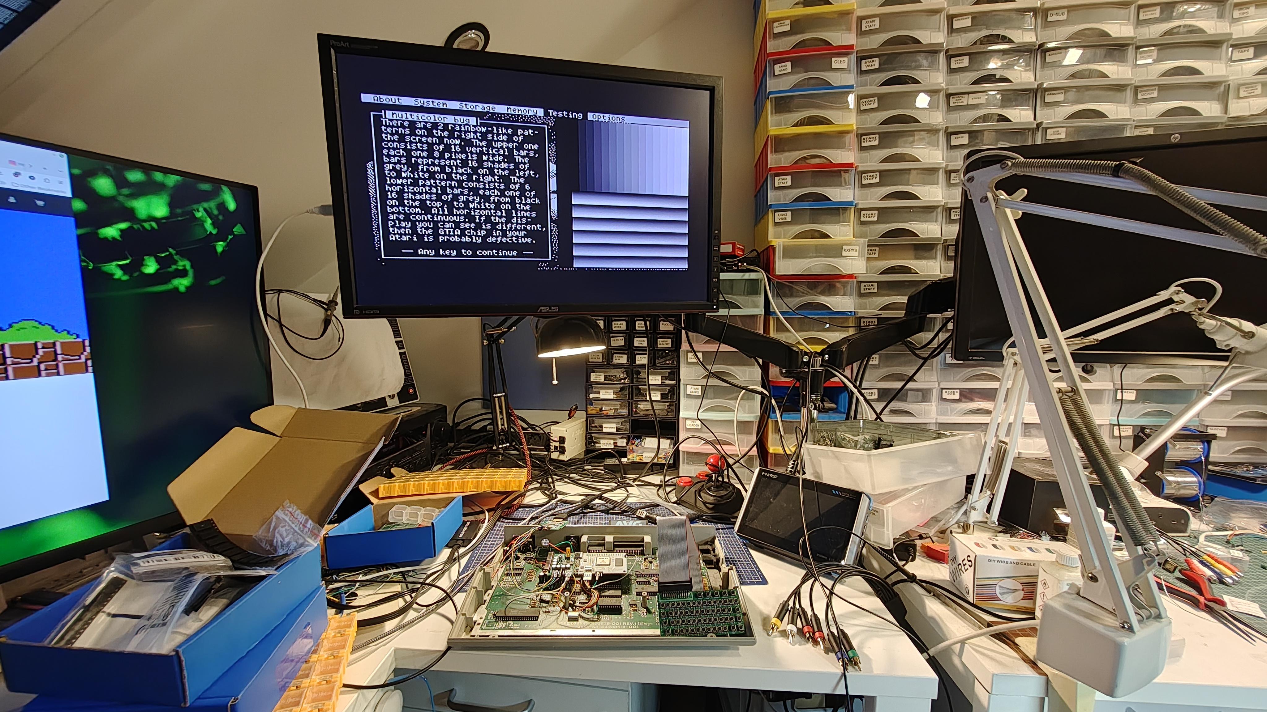

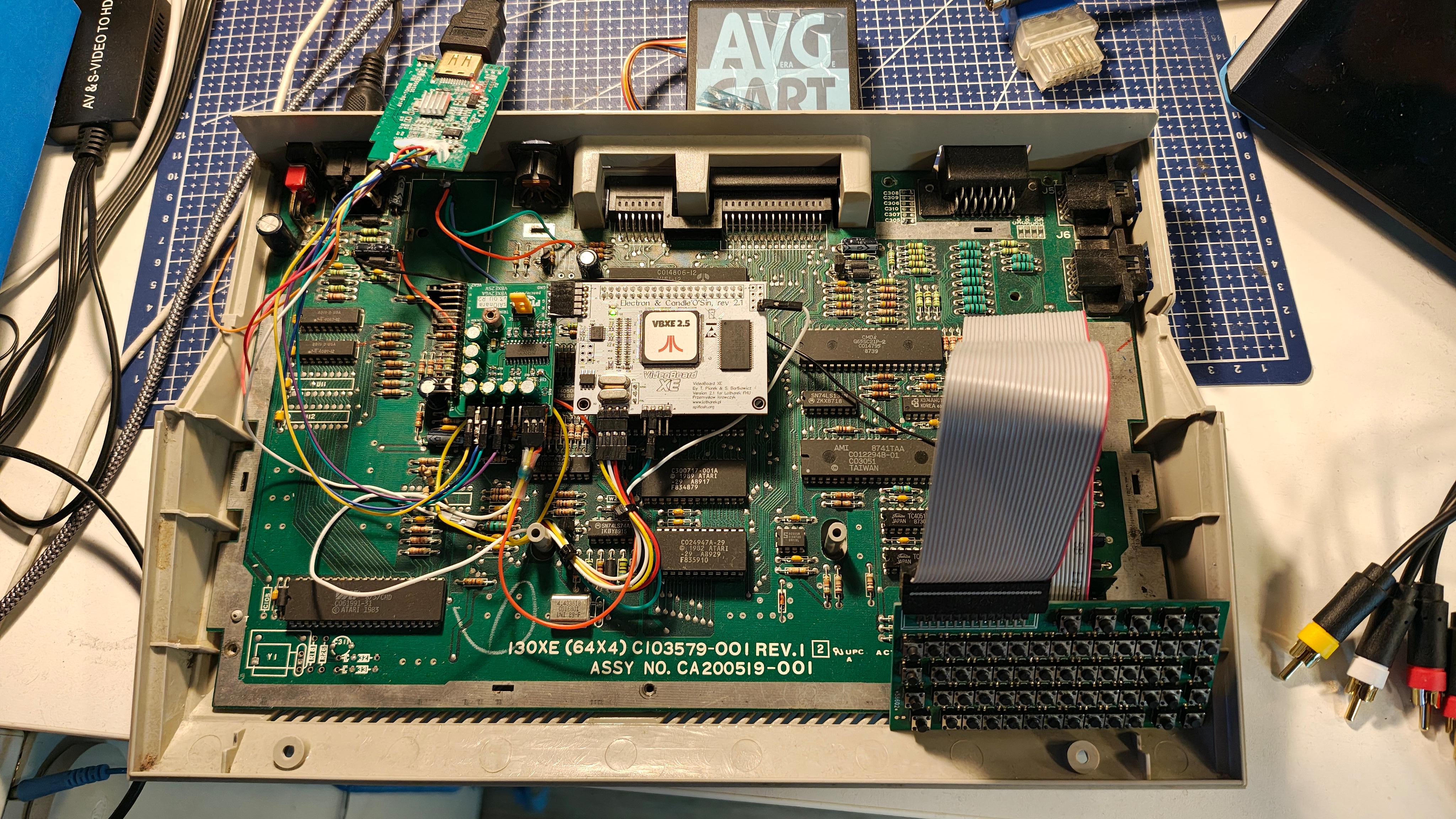

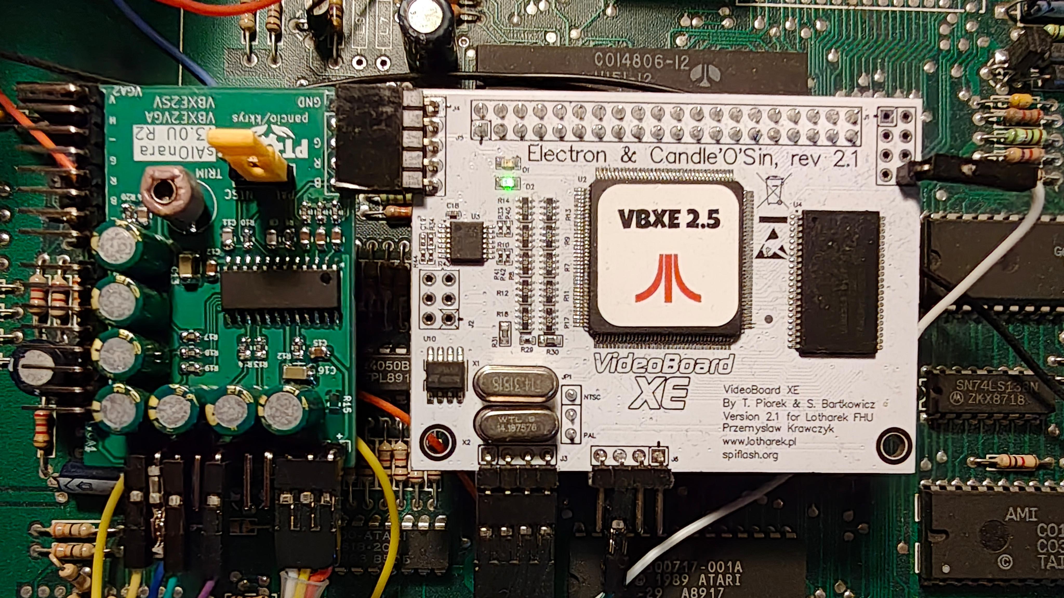

A few pictures...
