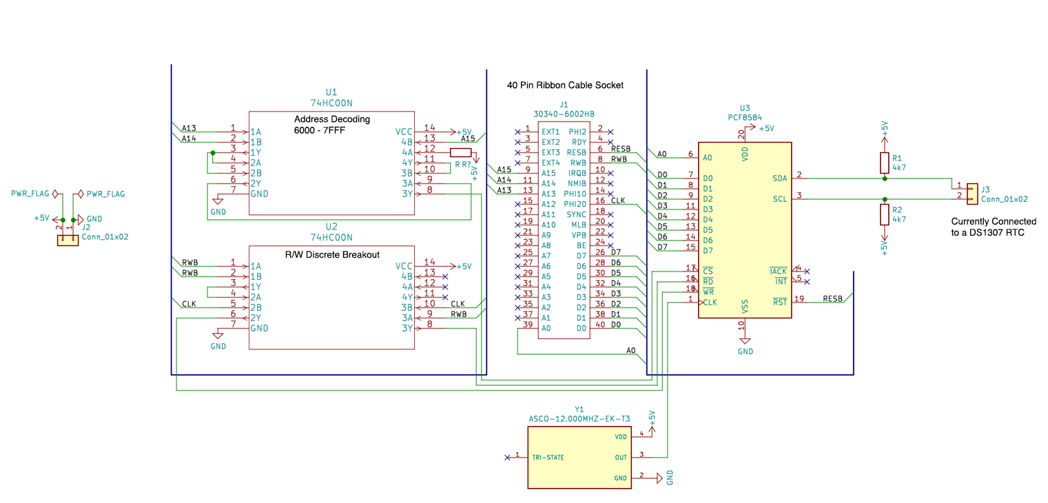

Thanks for that additional information. I've been working on this project the last month or so, and updated my schematic to reflect the changes you mentioned.
  1. Removed /INT
  1. Added a resistor when setting pin 12 high as part of the address decoding
  1. Added a 12 mhz Clock
I also got the MADS assembler running and was able to assemble your code and get it running on my 6502 computer with some minor tweaks for addressing and the new 12mhz clock. I then padded the assembled file so I could flash it to a 32K eeprom; however, I did run into a small problem with the outputted ROM file. When I would jump to subroutines, I noticed the address they were jumping to wasn't correct (off by 6), so I ran the file through a 6502 disassembler, and noticed the beginning of the file included instructions that I didn't know the origin of. I was thinking this might be something ATARI specific?

Another problem I ran into is the RESET line on the 6502 is being pulled low when connecting it to the PCF8584 RESET pin. I suspected this is because the PCF8584 RESET line is open drain, so I connected a 10K pull-up resistor to it, and then later a 4.7k resistor, but still had the same problem. I'm not sure what's going on with that, but I did resolve it with a temporary hack by running the 6502 RESET line through two NAND gates and then connecting the output of that to the PCF8584 RESET pin. I'm still rather new to the hardware side of things, so that's the best I could come up with :D
Unfortunately, even after all that, when I run the code on my computer, I'm still not seeing any output on the PCF8584 SDA and SCL lines :cry: . I connected a logic analyzer to the circuit to verify the PCF8584 is receiving the correct input, and didn't see any problems. I'm thinking it could still be a problem with my hacky RESET line "fix", or these eBay PCF chips are no good. I'm going to try purchasing some brand new surface mount versions of the PCF and see if that makes any difference.
I've attached a copy of my updated schematic. I was wondering if you could check it out and let me know if you see any problems with it :) ?

Re: A2I2C - I2C bus for Atari
Hi,

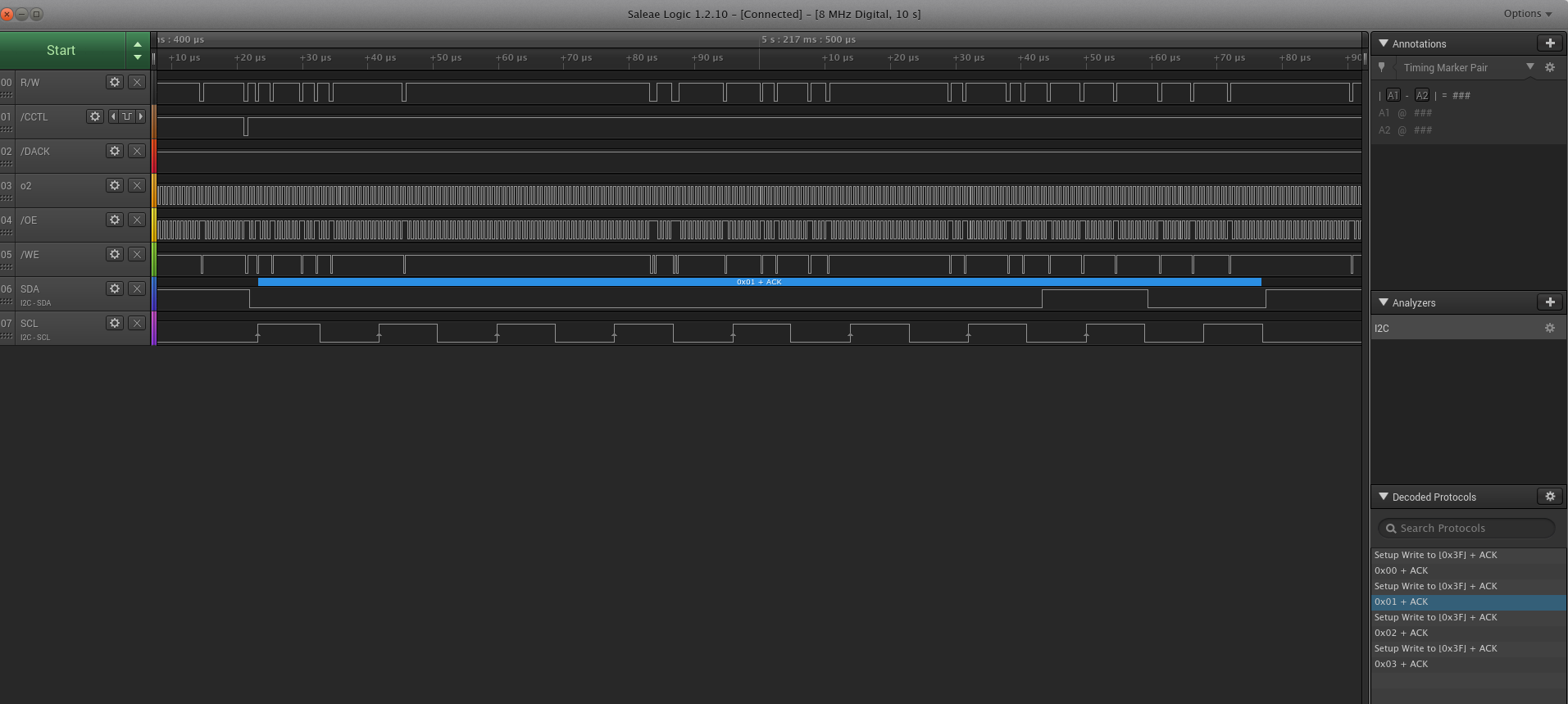

As you mentioned, the /RESET line is open drain and for normal work you need to pull-up it to Vcc thru resistor but I suppose your microcomputer system has this line pulled-up in other place. Are you sure that PCF8584 RESET pulls the line down? It's input pin, so probably PCF is damaged. I had issues run PCF in 6800 mode so I decided to use Intel mode.. You should analyse your address decoder/discrete breakout for /RD /WR /CS to be sure that time restrictions are ok e.g. using logic analyser. For example I added screenshot with timing sequence with Atari, PCF8584 and PCF8574 which may be helpfully. In case /CCTL is connected to /CS (from address decoder), O2 is clock signal from Atari (1.79MHz), Rest signals you know...

I'll analyse schematic soon...

Thanks for the timing diagram. I also have a Saleae logic analyzer, so I will wire mine up the same as yours, and check it out.
