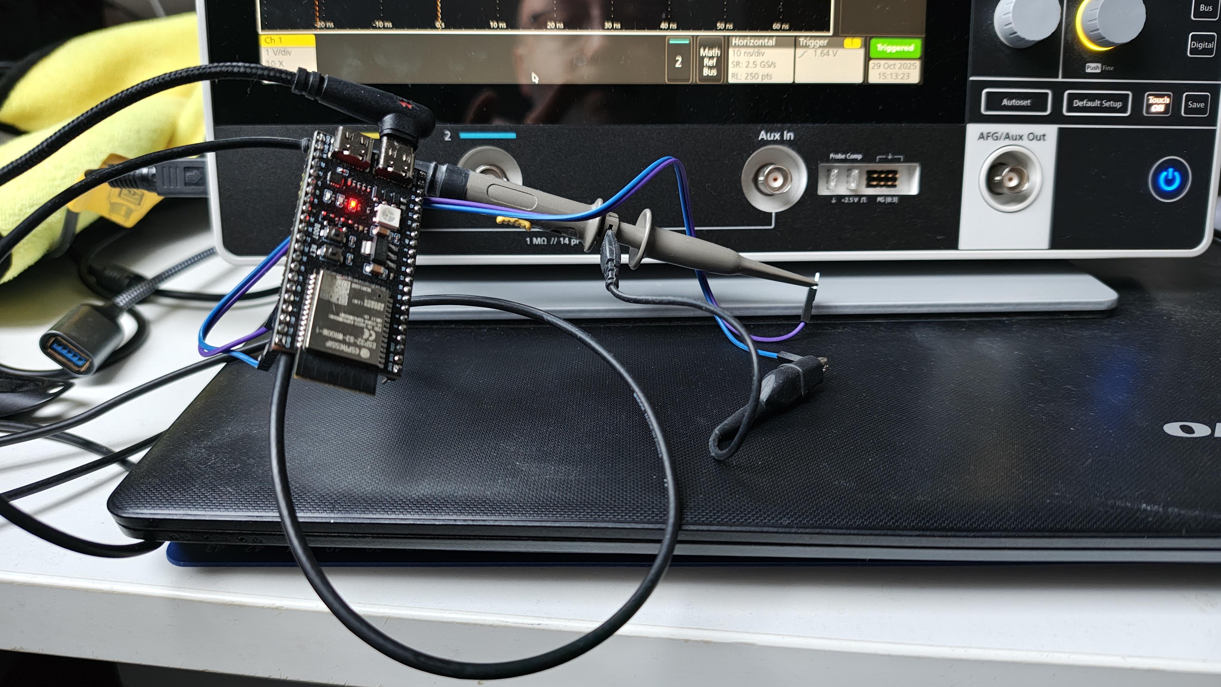

To illustrate the example, I used the DevKit-C module with the ESP32-S3 (16R8N) chip, but it can be any ESP32

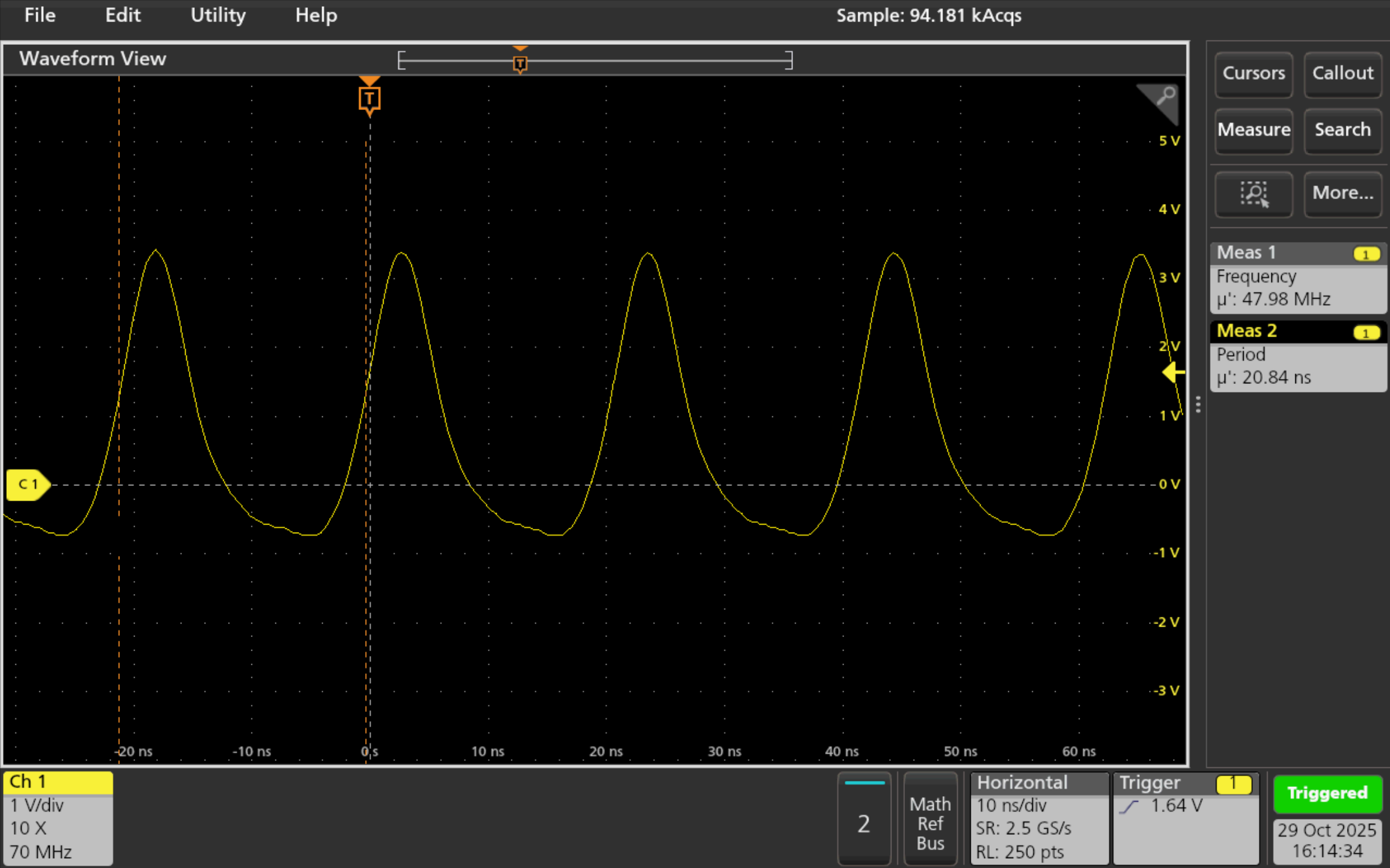

By using a dedicated GPIO and assembler, the maximum frequency achieved when toggling a single GPIO bit on the port was 48MHz at a 240MHz clock speed. Of course, this is just a proof of concept, and the actual speed will decrease significantly when we add logic to the program. However, I'd like to point out that the same task performed in Arduino code yields a maximum of 1.3MHz, while in the PlatformiO/VCS/Espressif environment, I achieved a full 8MHz. The difference is: 1.3 --> 8 -> 48MHz :-) What do you think?

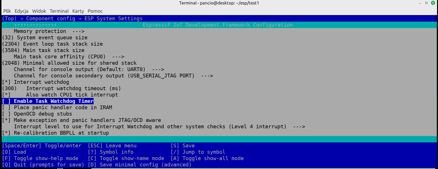

It's also worth mentioning that the ESPidf environment utilizes the FreeRTOS RTOS, which has many advantages, but also some disadvantages. The system overhead can introduce interference into your main program, for example, by sending watchdog logs to the console. You may then disable some of the FreeRTOS add-ons in 'menuconfig' e.g.:
