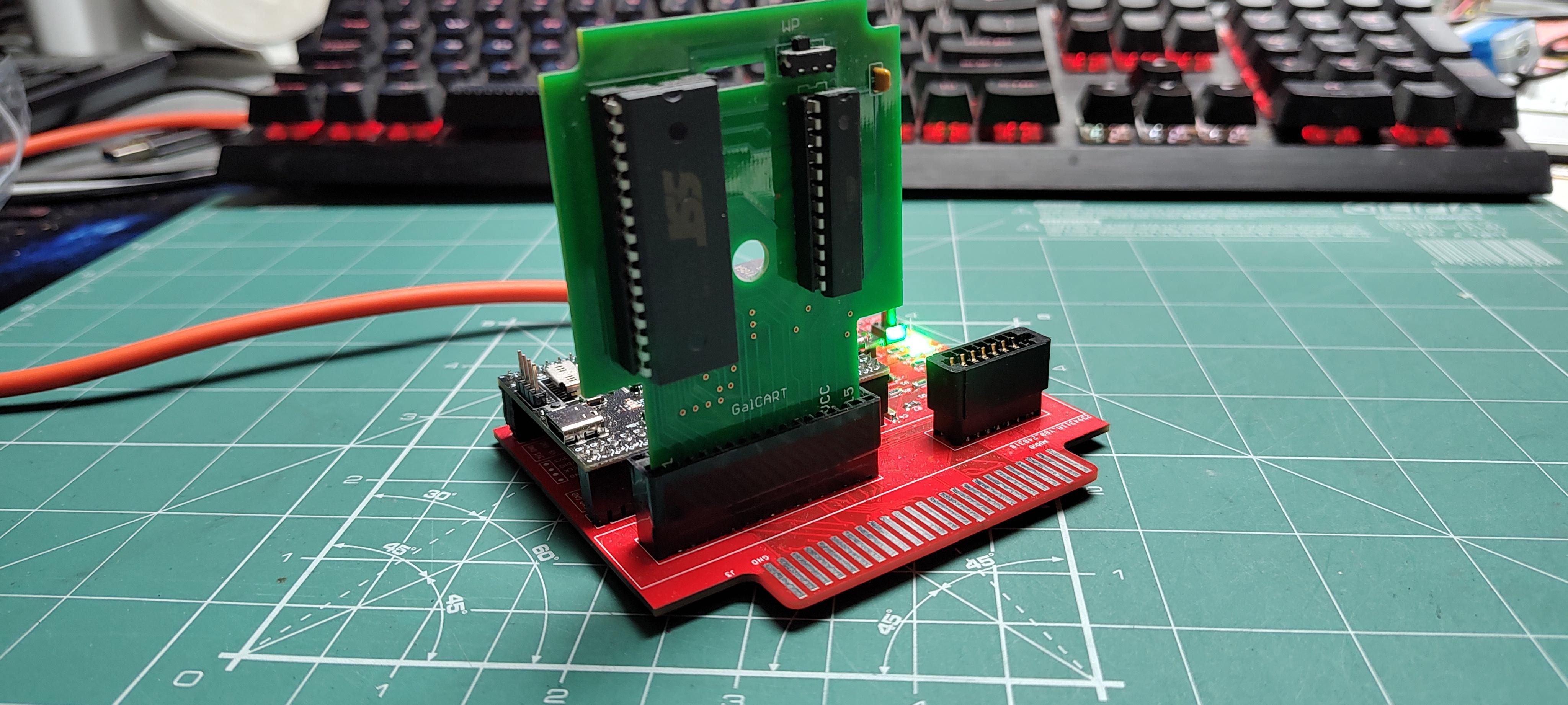

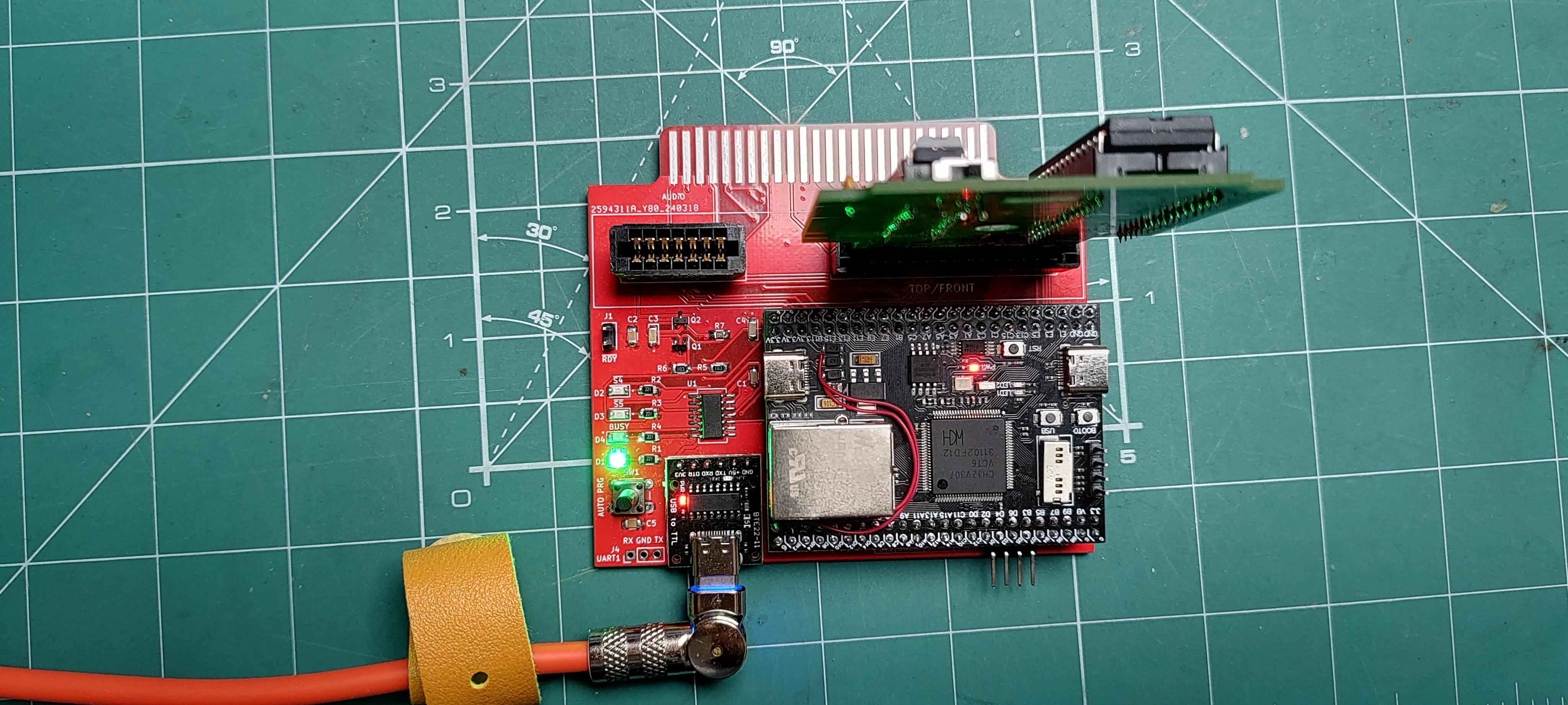

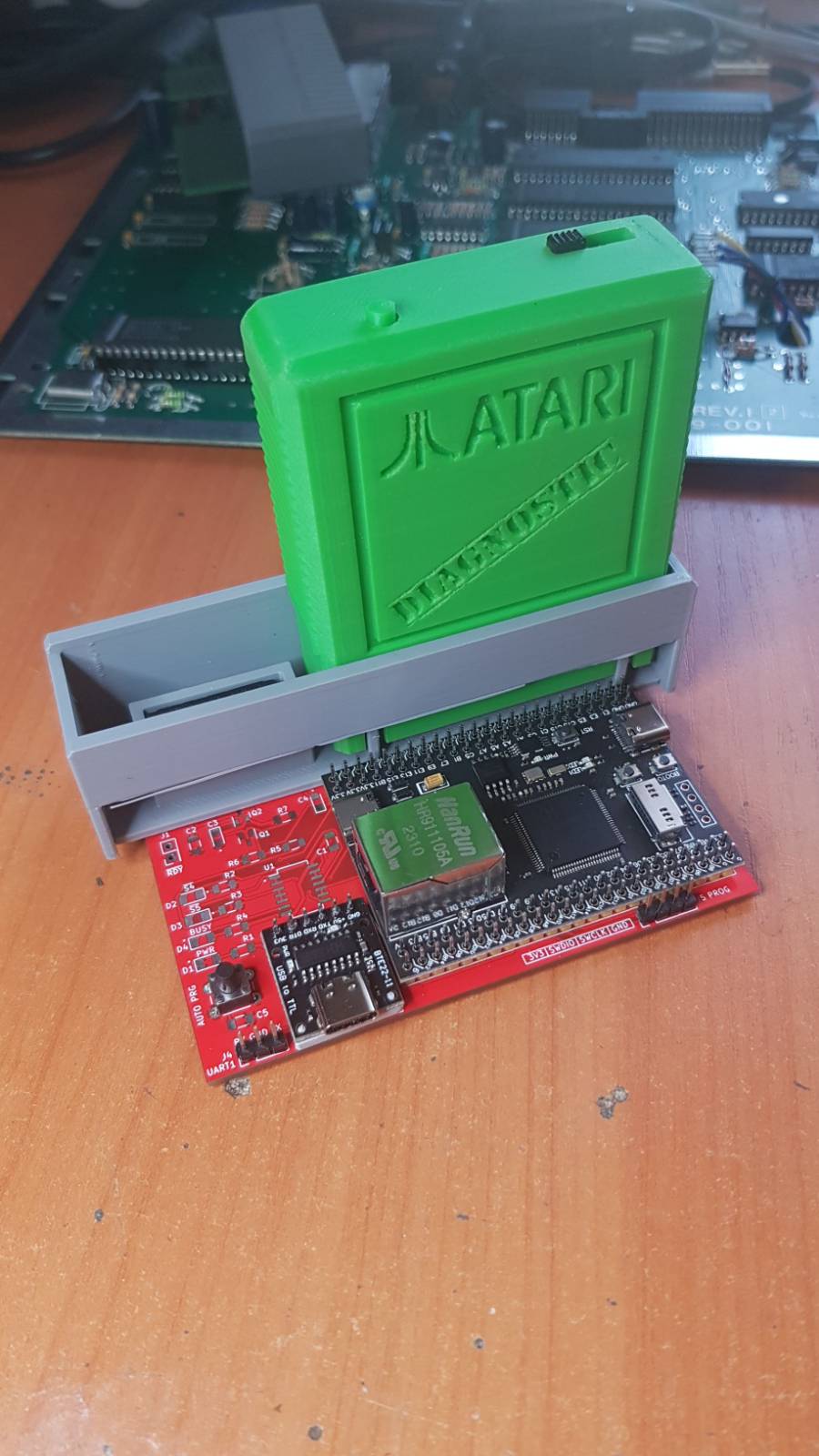

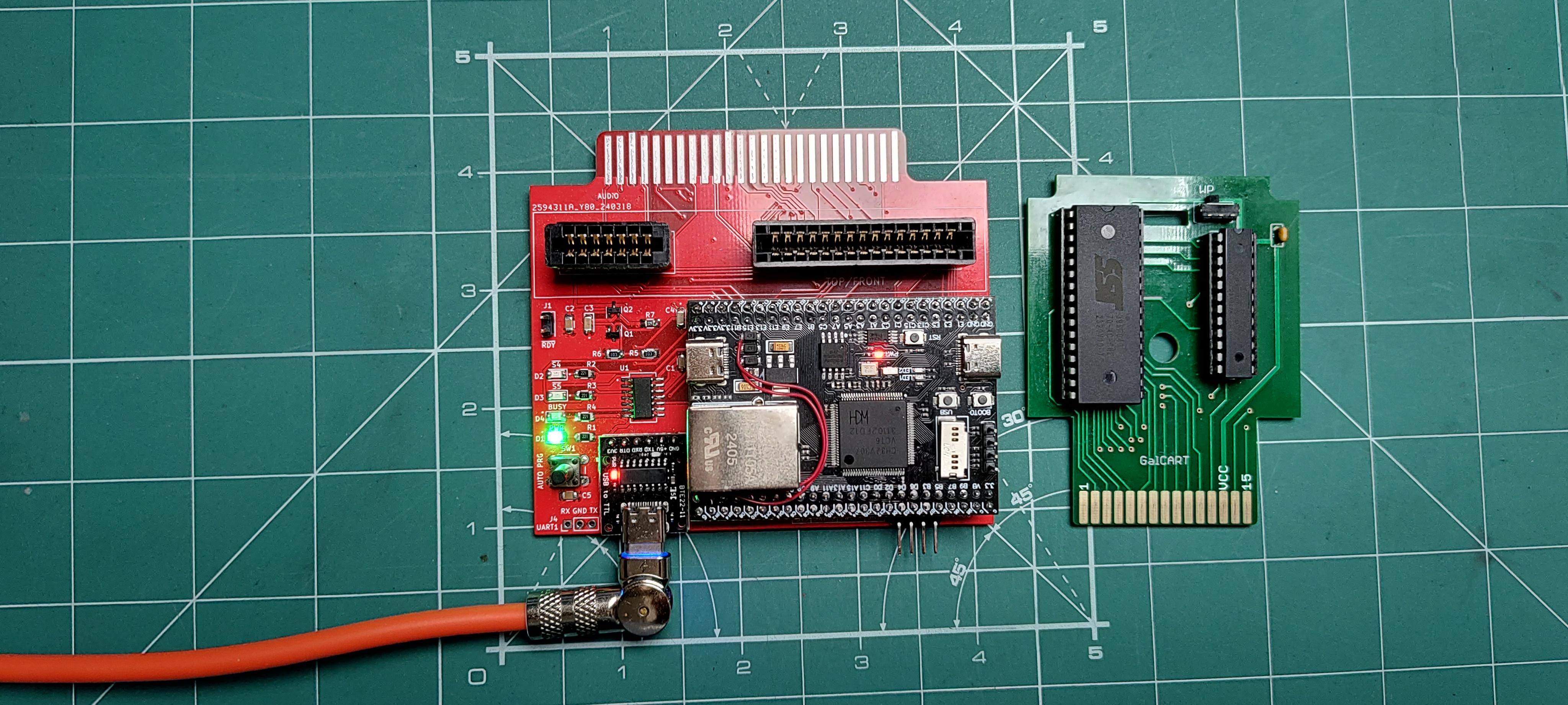

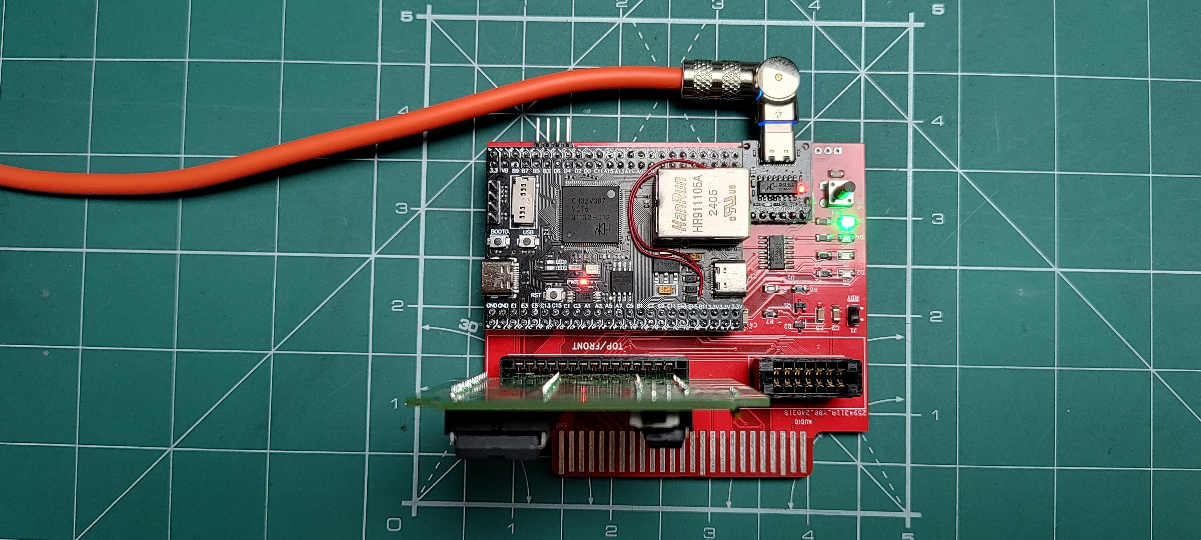

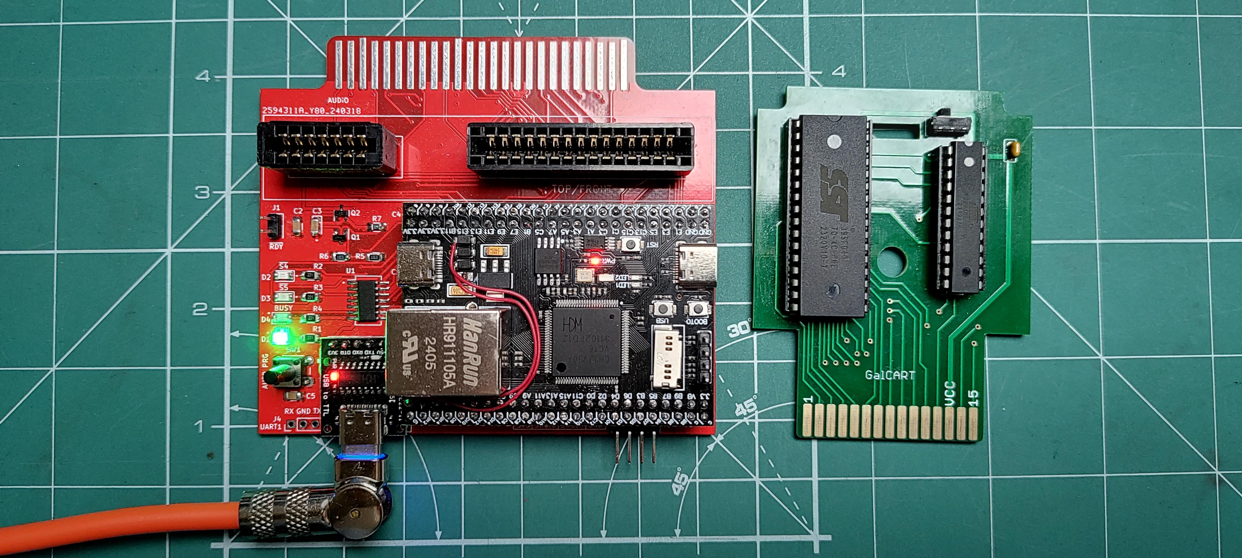

I would like to present my new VRHI device, which may be using for programming, reading and cooperation with any Atari XL/XE devices.
The main reason why I decided to build it was the need to quickly write to any cartridge, because writing to an Atari takes a very long time... The presented device can do this in a dozen or so seconds (depending on the capacity).
Additionally, we can connect any device compatible with Atari to the interface and, if the method of communication is known, we can also control it. We may to connect VHRI to a PC using a USB cable and use as debugger via serial cable (or USB). The first tests showed that transmission speeds of 2mbit are possible (reading a 512KB cartridge takes about ~3s), but we are working to use USB as a faster interface.

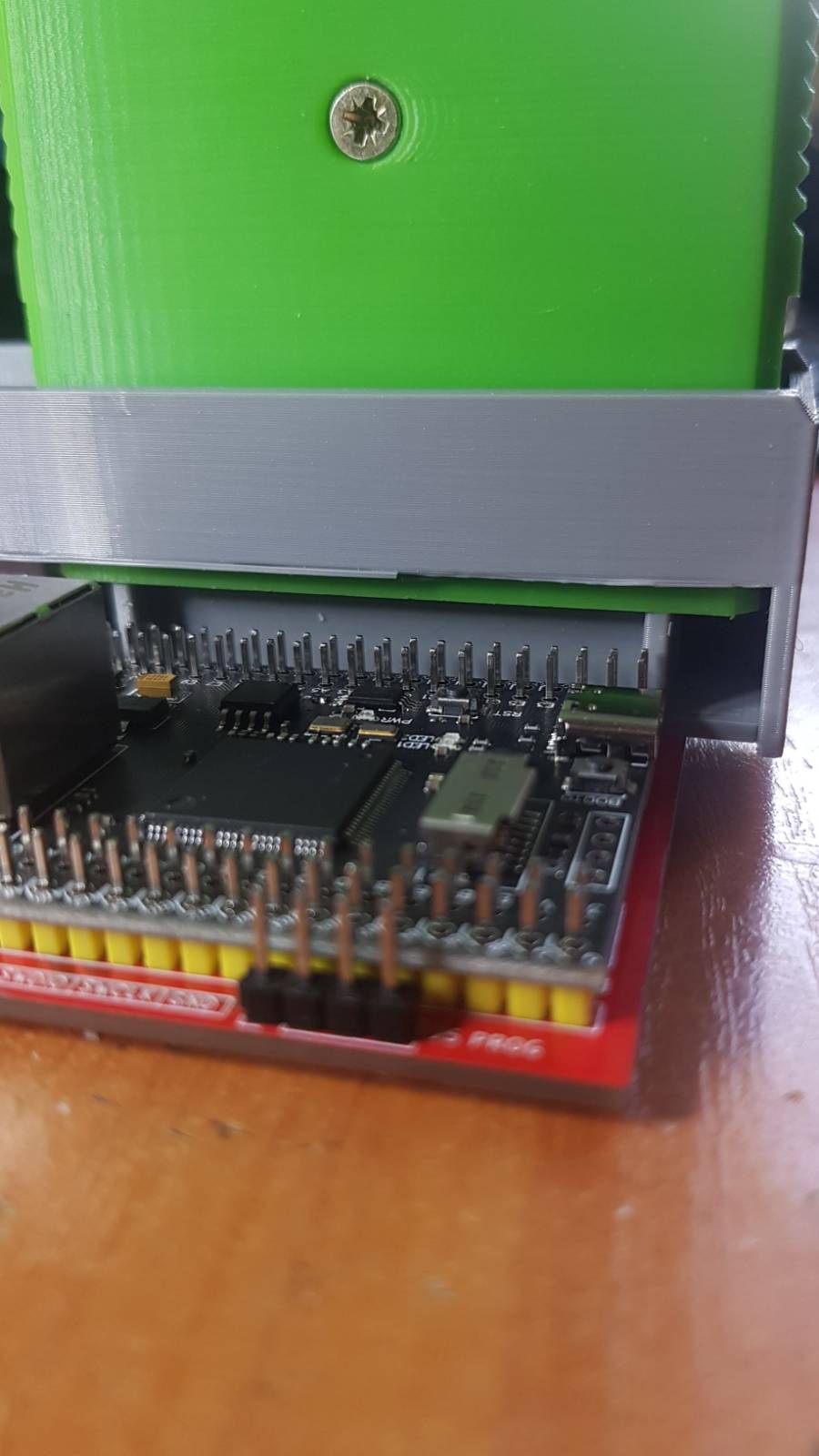

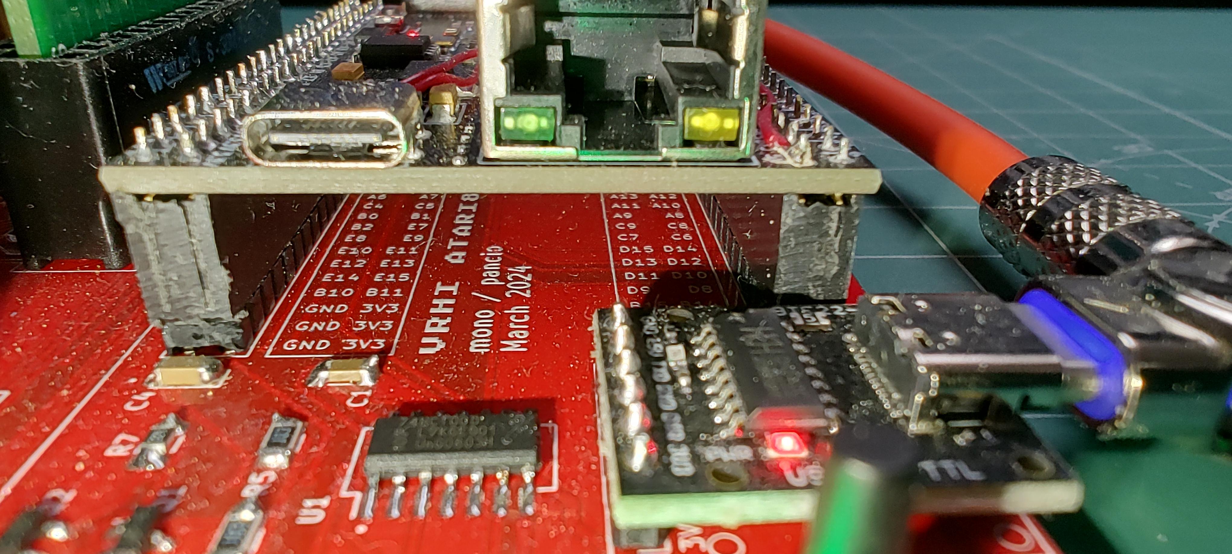

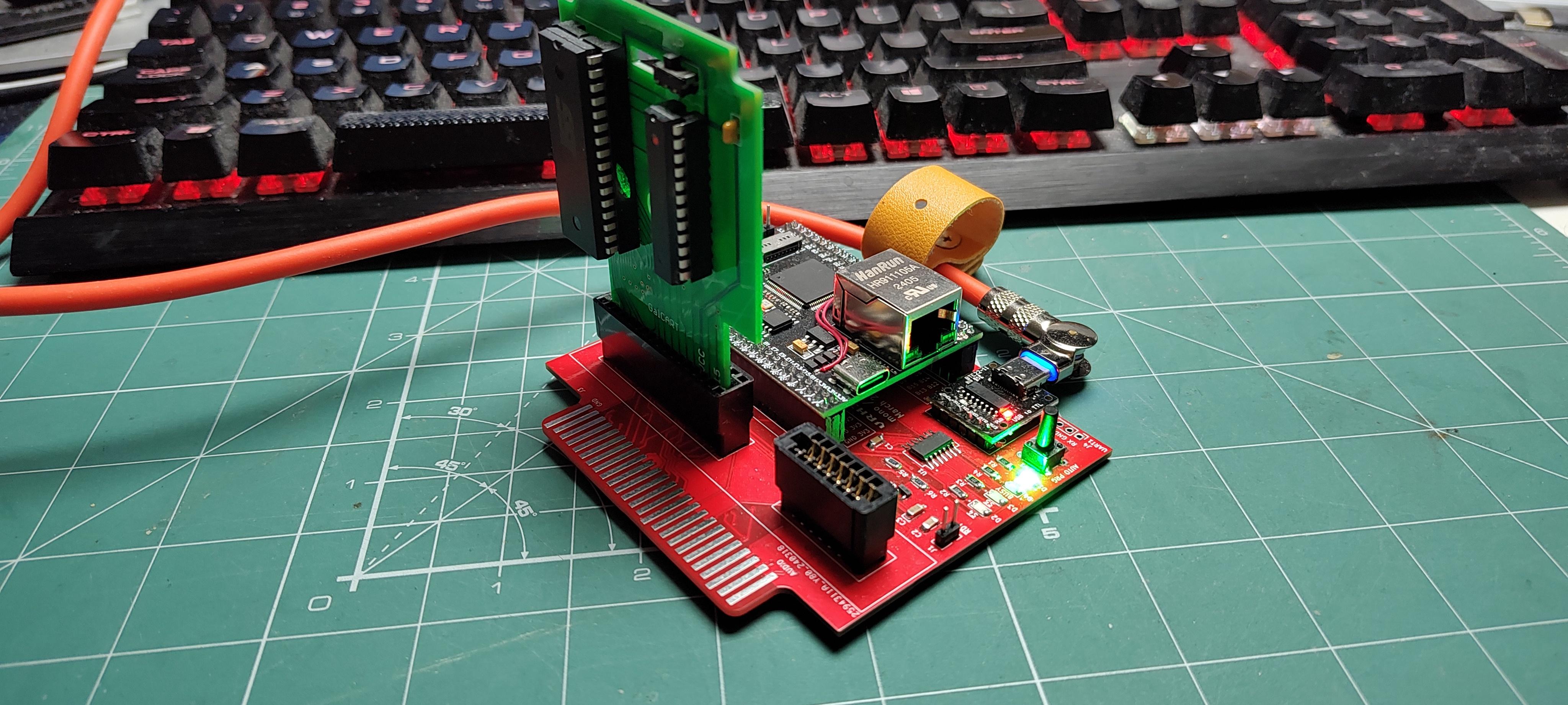

- the project was created as a development of the ATARino idea and initially used its PCB (see photo of the prototype),

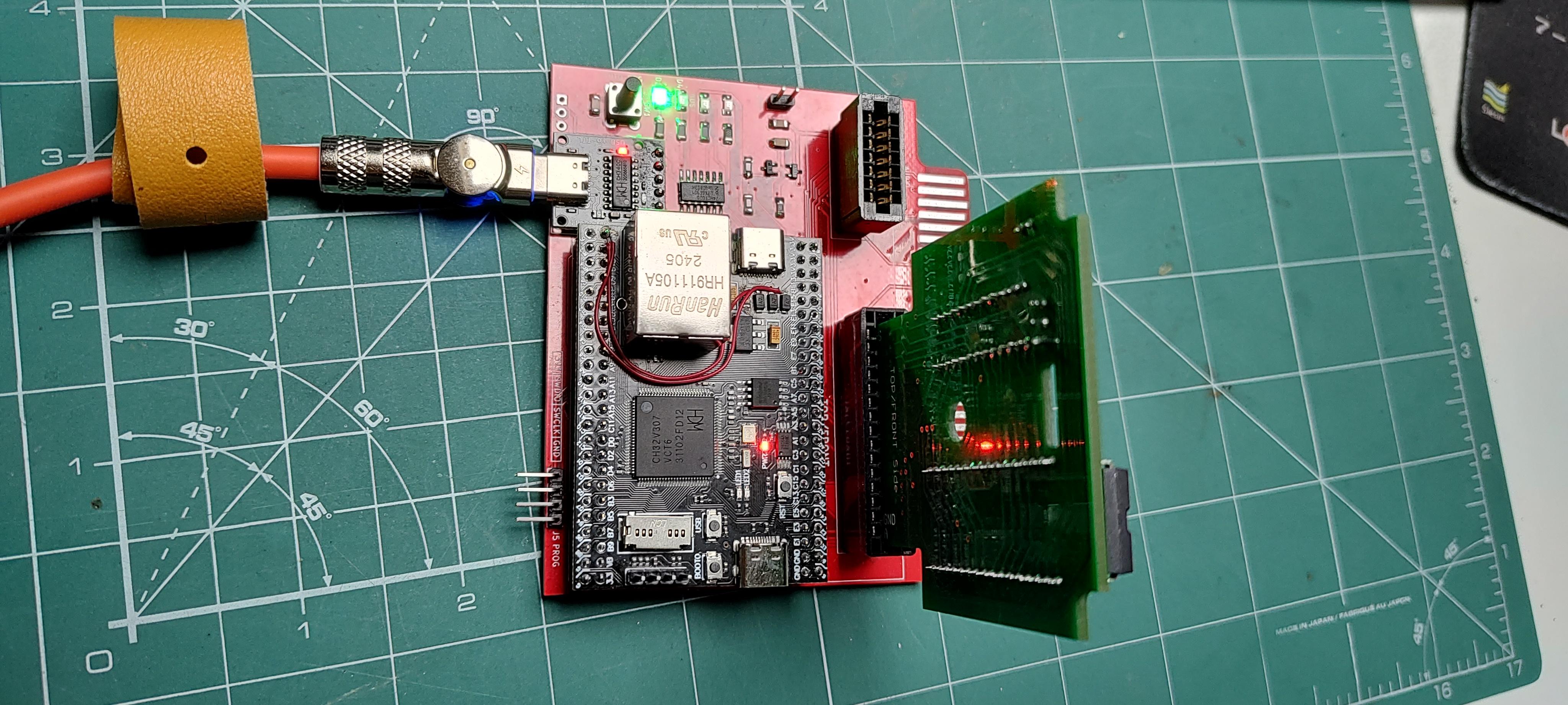

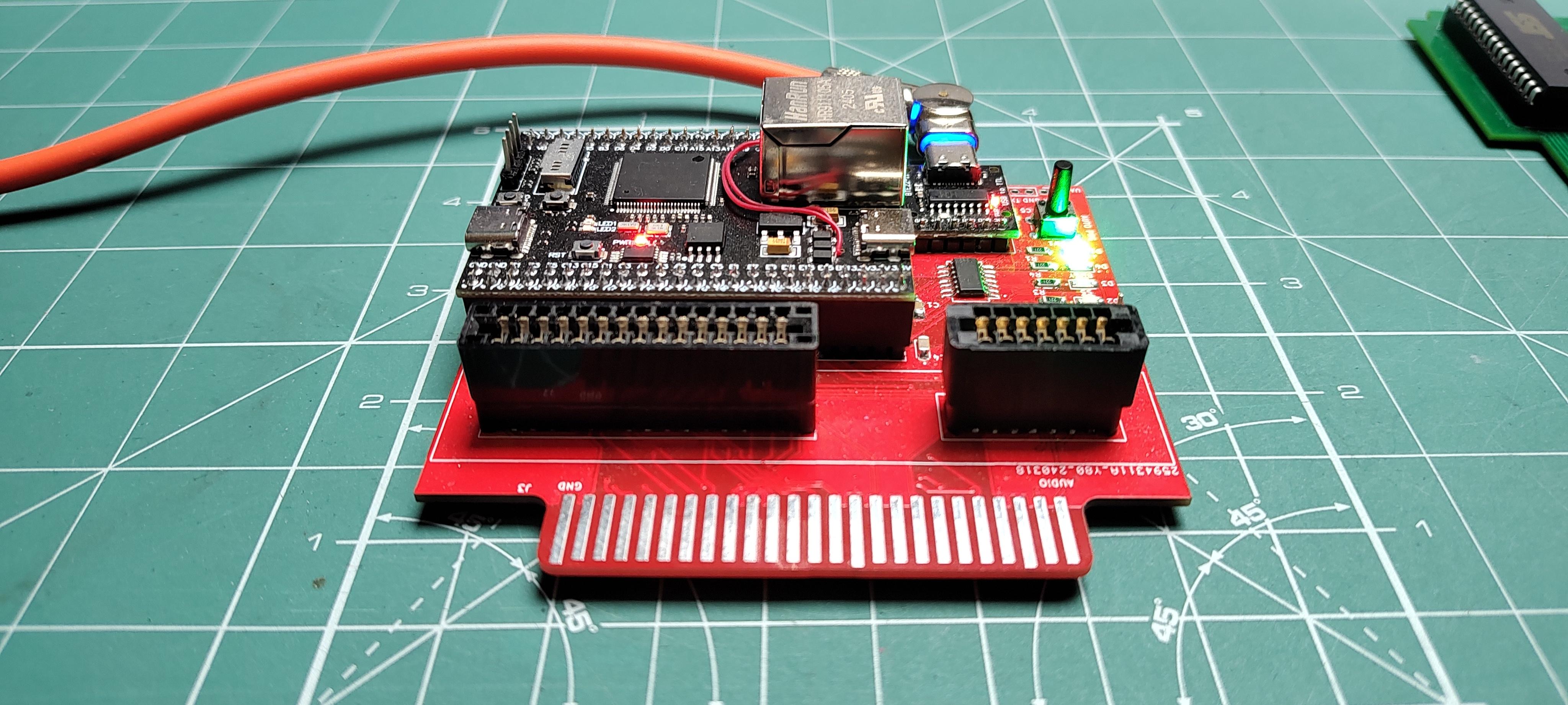

- the main element of VRHI is the module based on 32-bit RISC-V microcontroller, 144MHz with 64KB RAM and 256KB FLASH,
- additional elements: 16Mb of FLASH memory for cartridge data,
- EEPROM memory for configuration data,
- SD card slot (for cartridge images),
- ETHERNET 10Mb/s connector
- 2x USB HOST/DEVICE
Not all features are currently supported, but a few are planned...
There is one more cool thing if I use AtarINO... we can use VRHI as a sniffer, PC-controlled freezer or accelerator directly on Atari 🙂

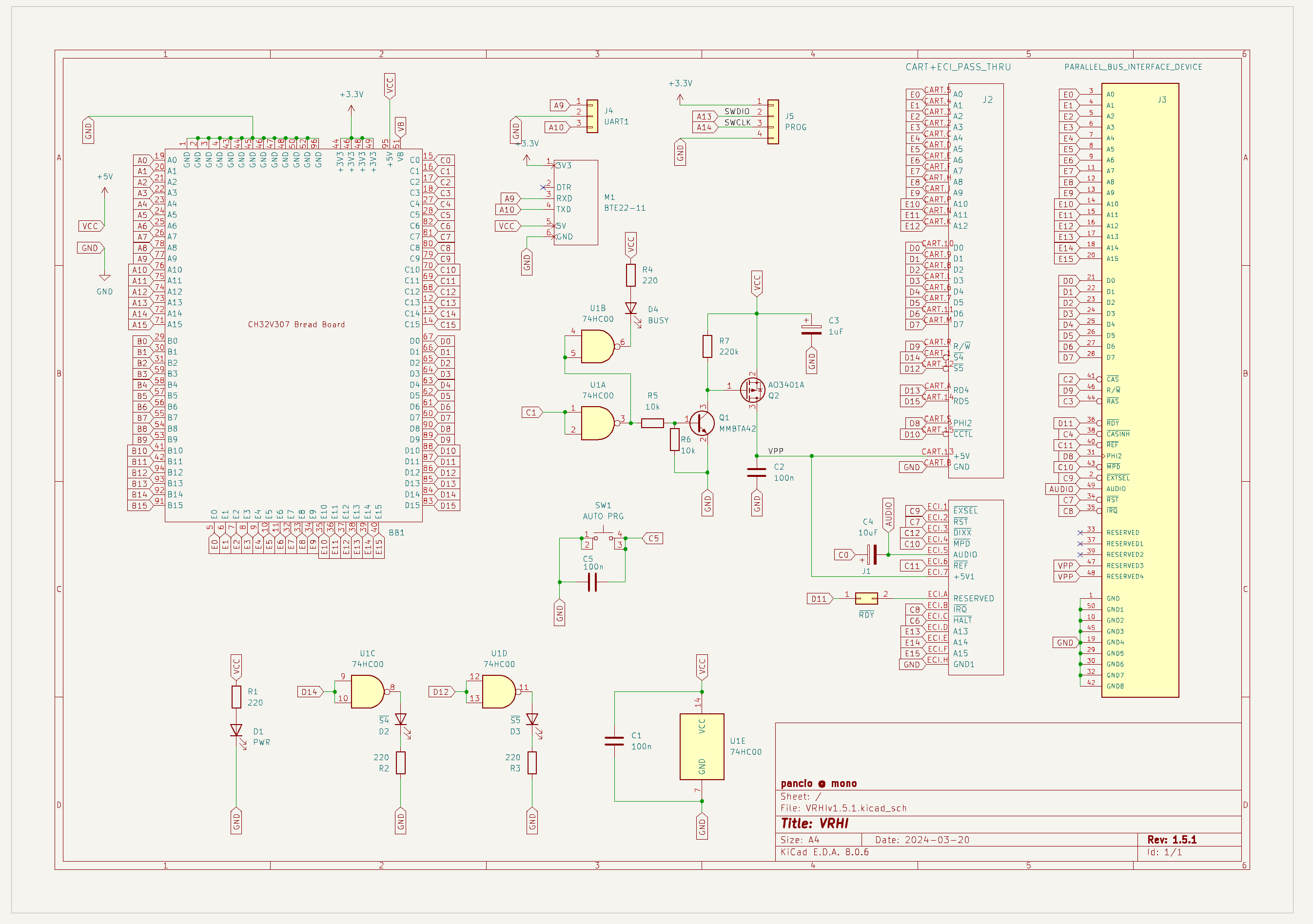

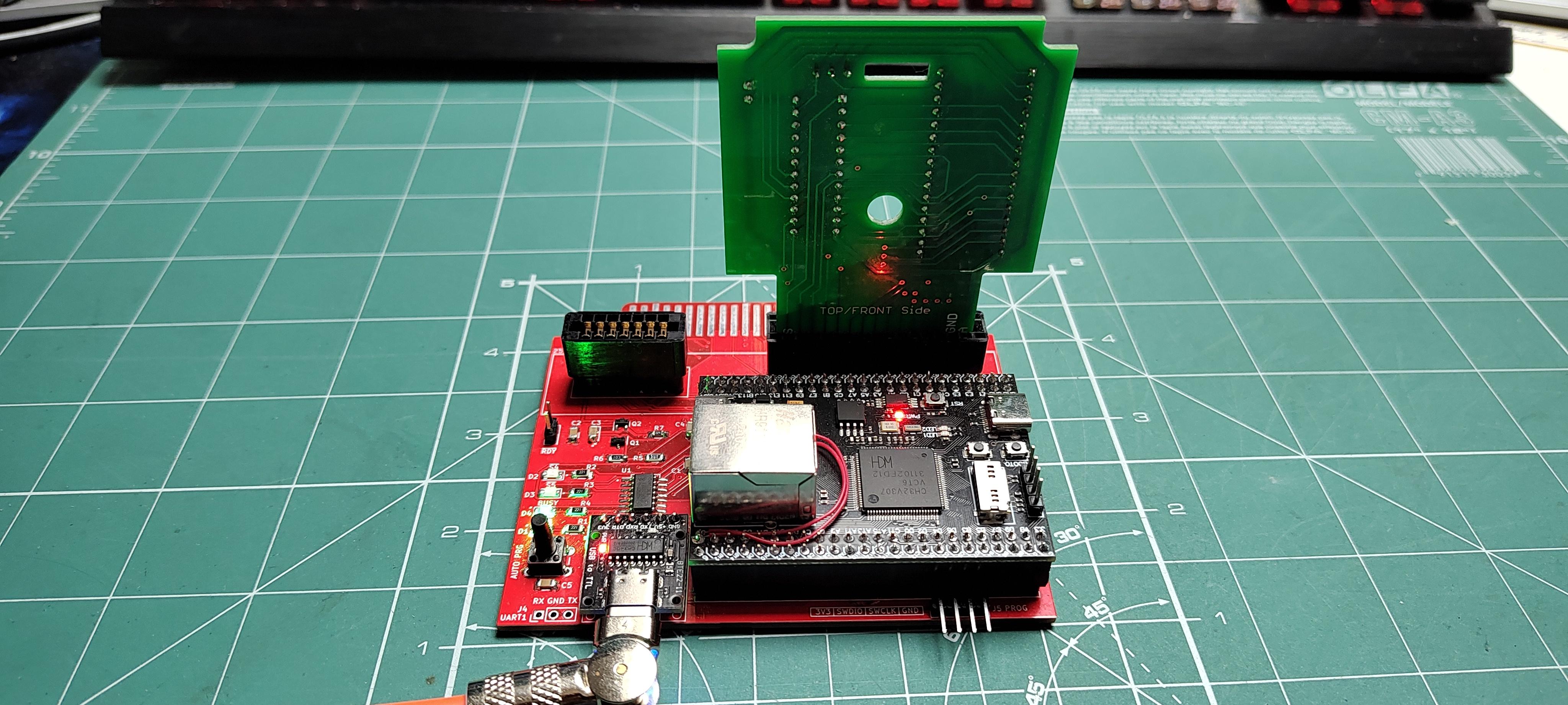

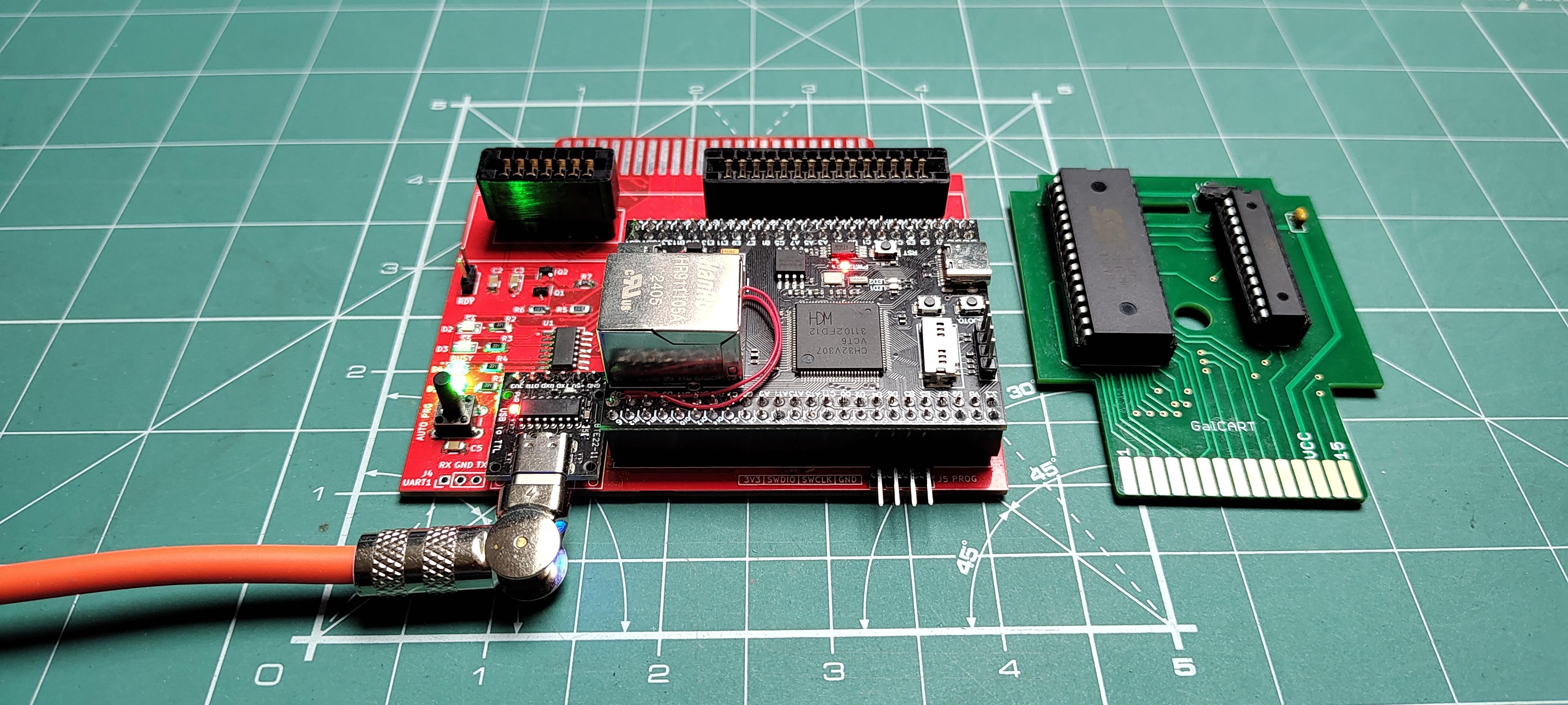

Schematic, PCB and RISC-V Module
VRHI is based on module (YD-CH32V307VCT6) contains CH32V307VCT6 microcontroller, cheap but powerfully chip. You may buy assembled module on Aliexpres or eBuy fro 6$. This is very interesting module because it's equipped with many additional resources.

Full schematic:

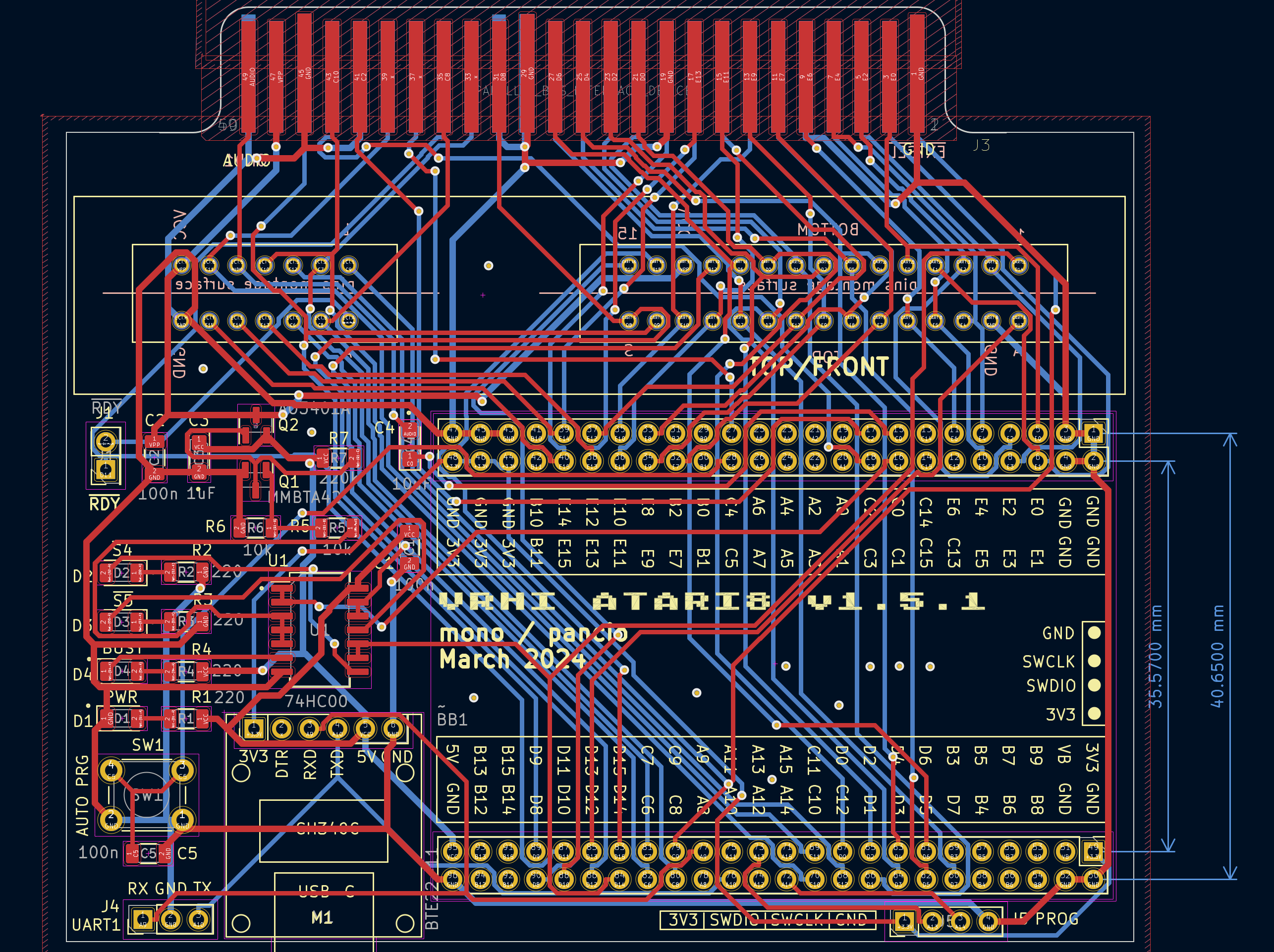

and PCB design:

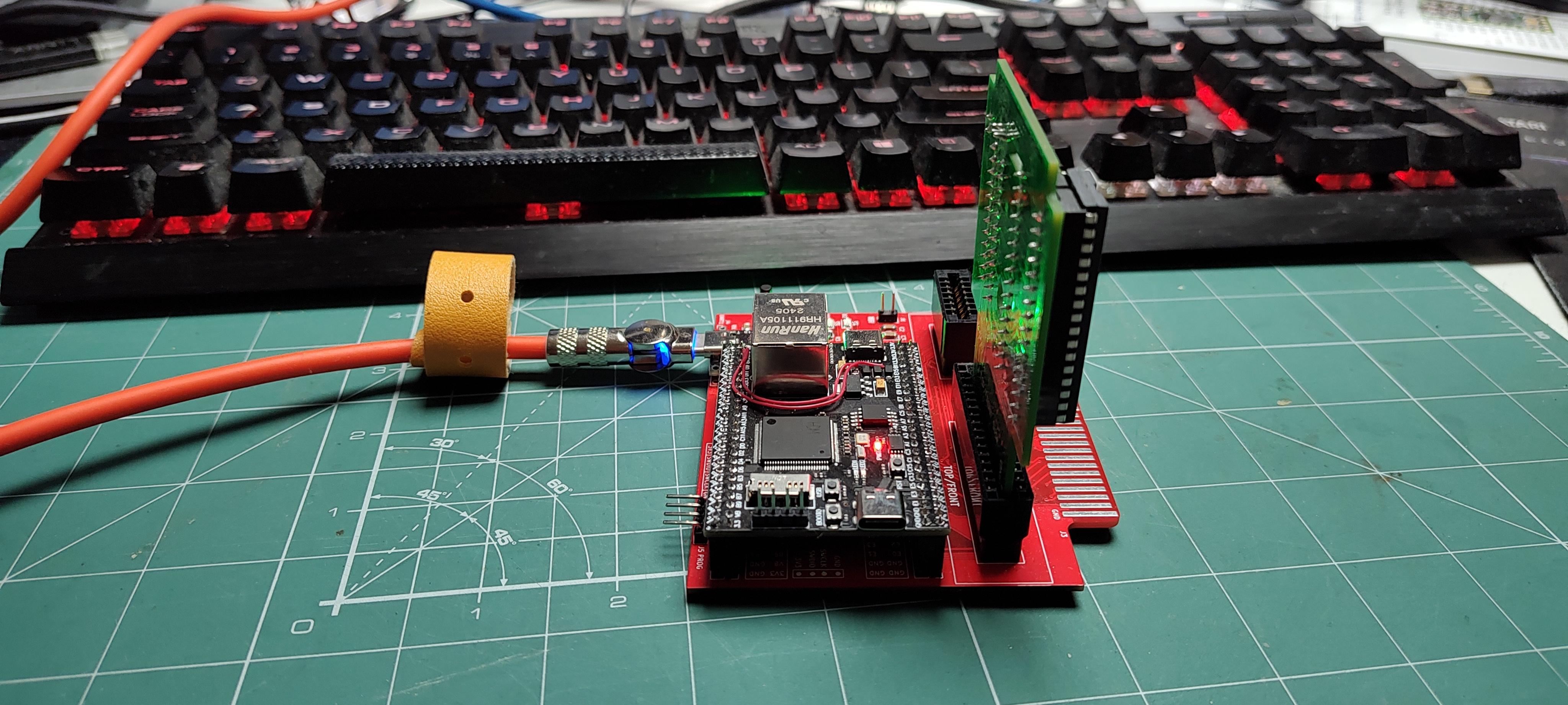

I decided to add additional module called BTE22-11 (also available on Ali/eBay) - this module is use as SERIAL2USB interface (we plan to use it only as debugger but at this moment it's main interface for communication with PC. YD-CH32V307VCT6 is equipped with two full speed USB interfaces but I need to learn how to use these. Maybe in the future we may switch to faster communication...

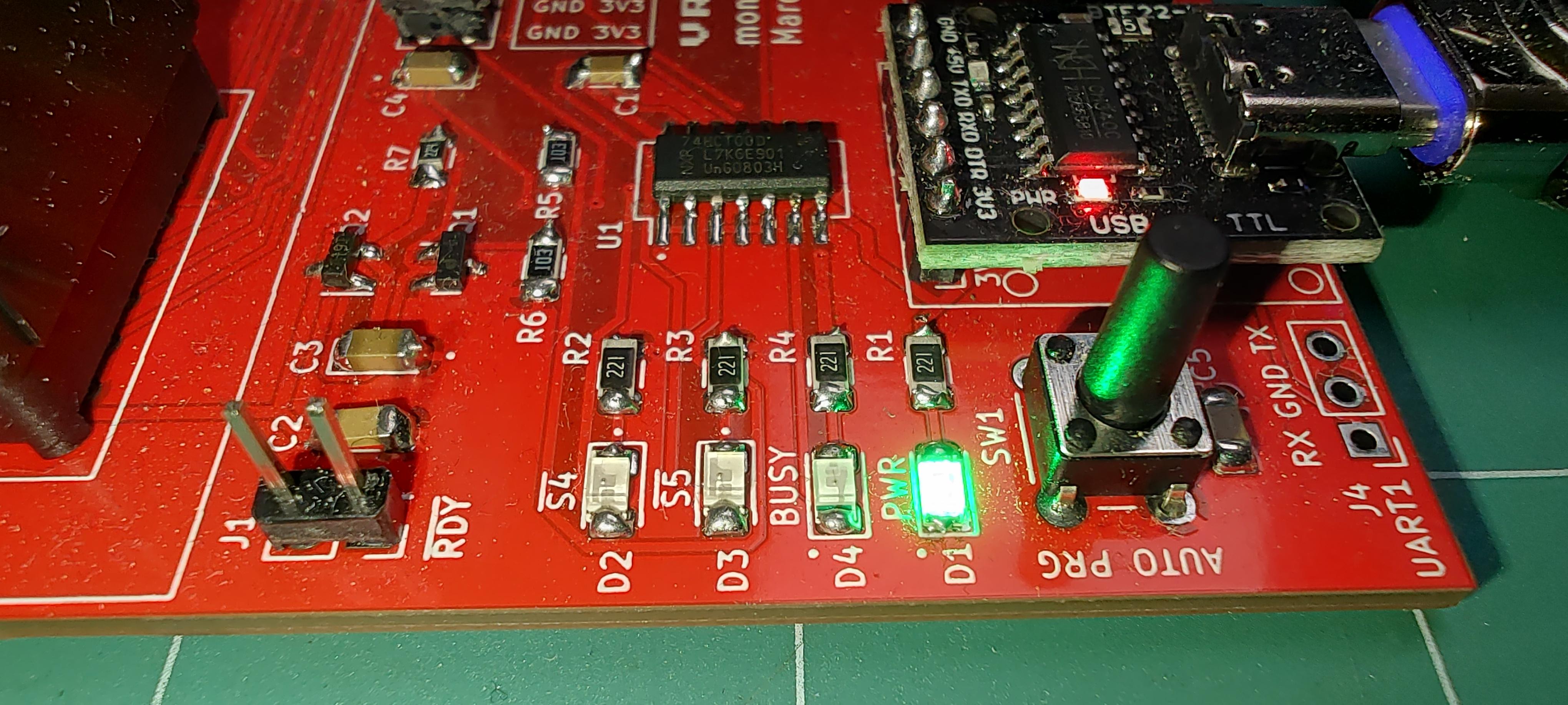

The VRHI is equipped with power control module for cartridge or other Atari's device. Powered device is active when LED D4 (BUSY) is lighting.
LEDs and button
On VRHI board we may find four LEDs:
- D1 POWER - always active when you powered VRHI,
- D2 /S4 - active if access to location $8000-$9FFF,
- D3 /S5 - active if access to location $A000-$BFFF,
- D4 BUSY - active when cartridge/device is powered.
We have installed one button SW1 - general purpose button for future use. I planned to use it for automatically flash cartridge directly from Winbond FLASH memory. In current version not active.

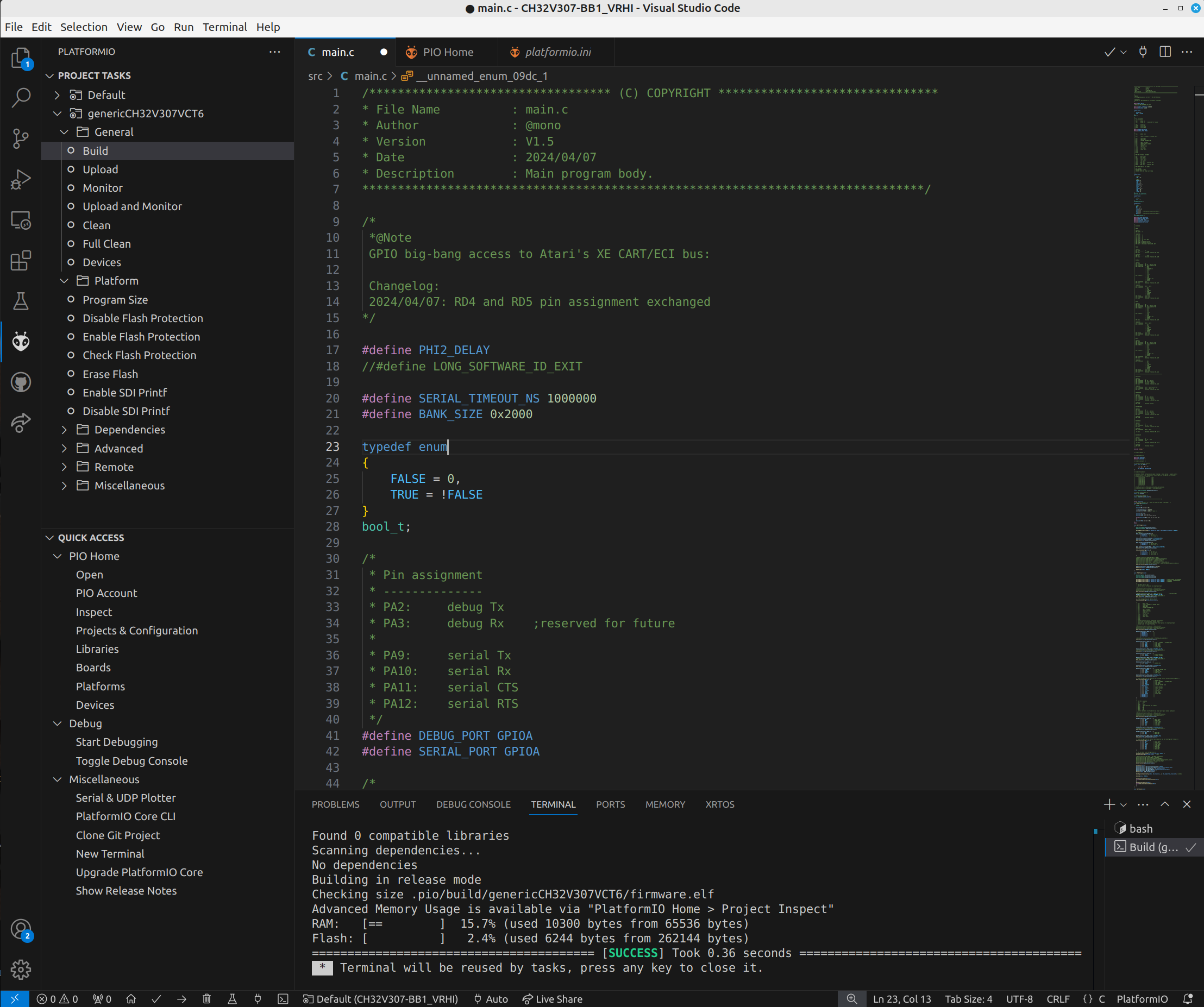

Firmware and software
Everything VRHI can do depends on the software, both the firmware and the library and the program. The entire software was written by my colleague @mono, Jerzy Kut - famous programmer, author of many utilities on Atari and other platforms. Thank you very much @mono, without you this project would be useless!
At the begging the firmware was made in native MounRiver IDE but finally I decided to switch to more convenient environment like VSC + PlatformiO:

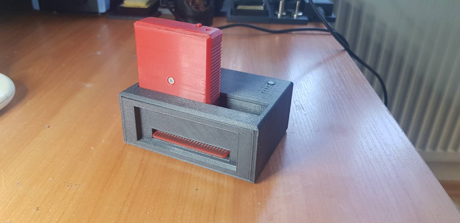

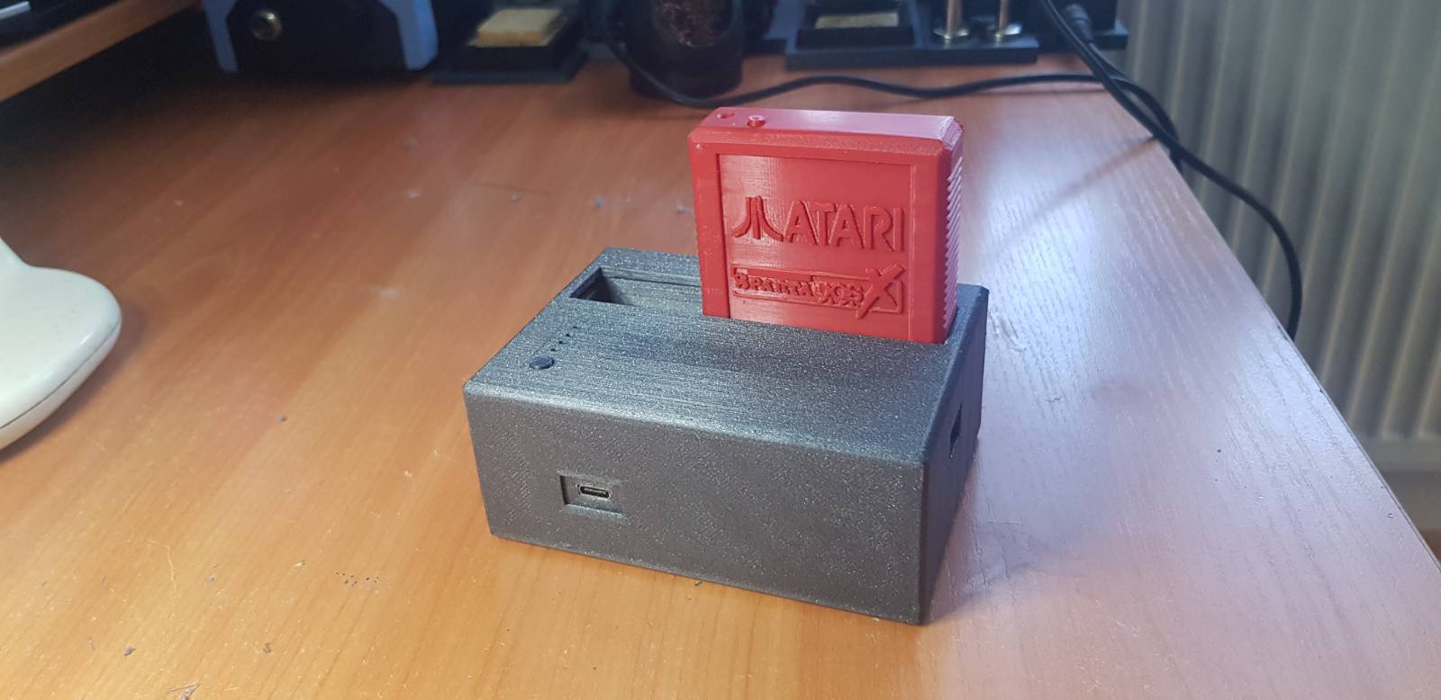

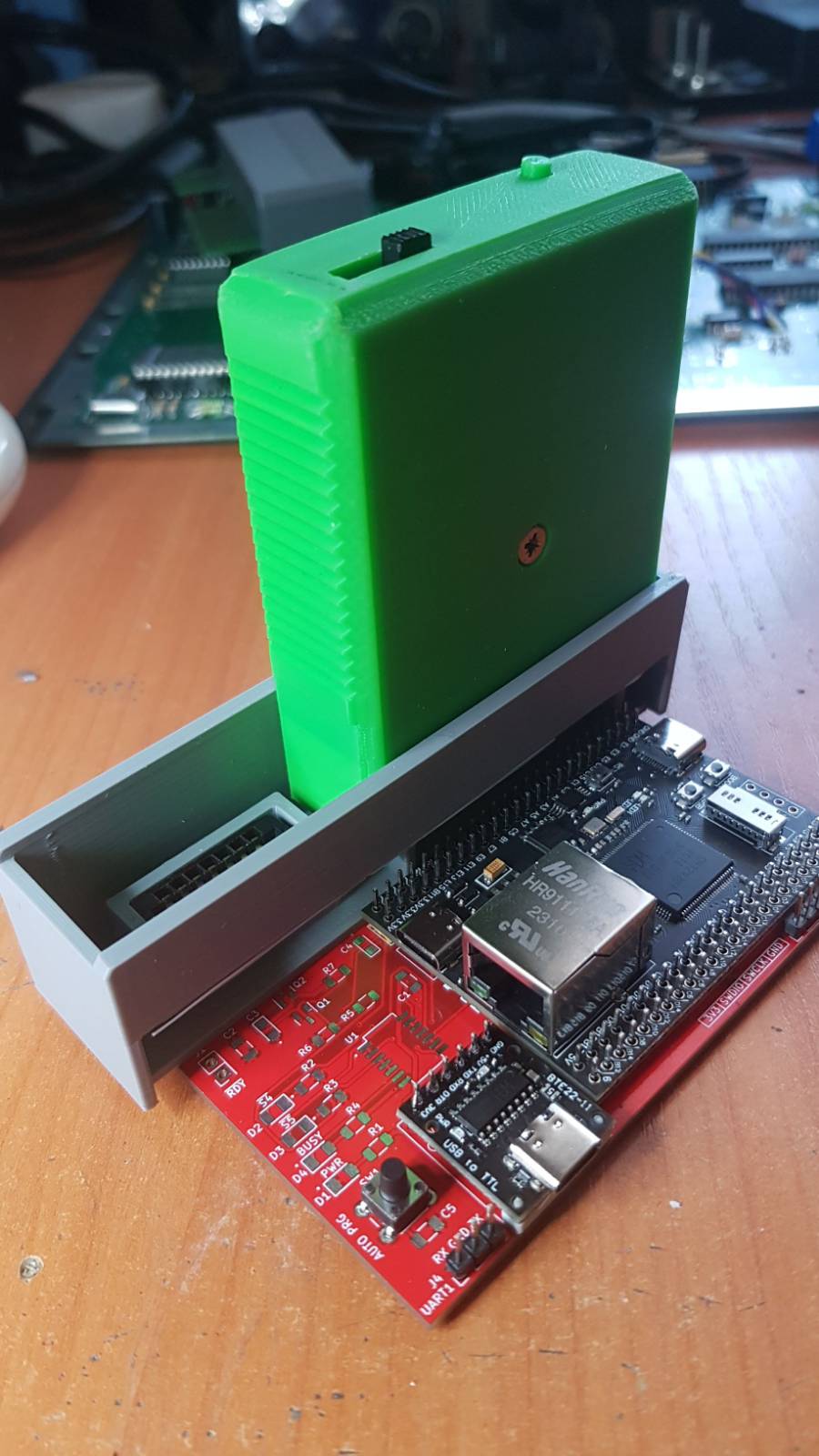

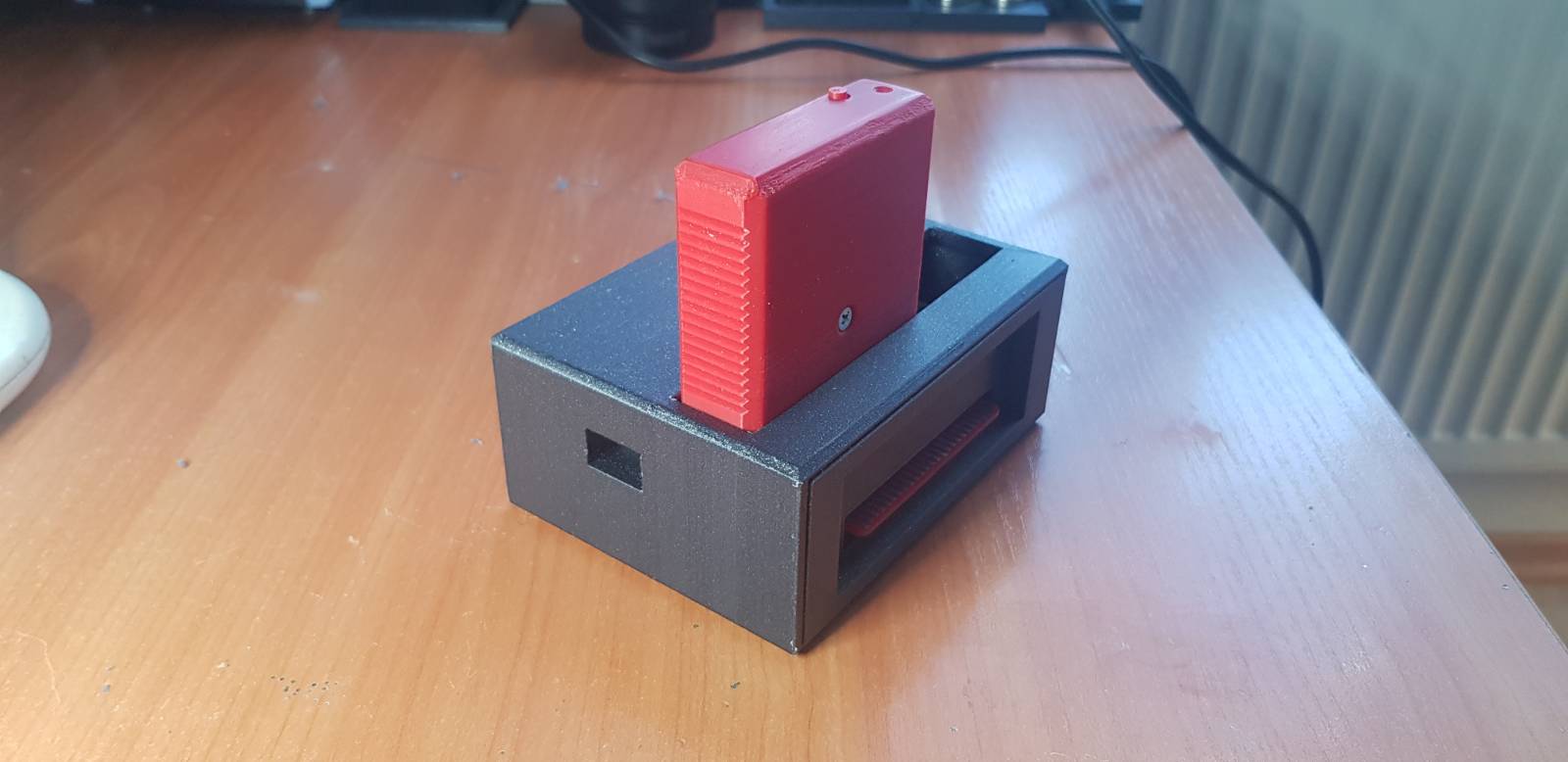

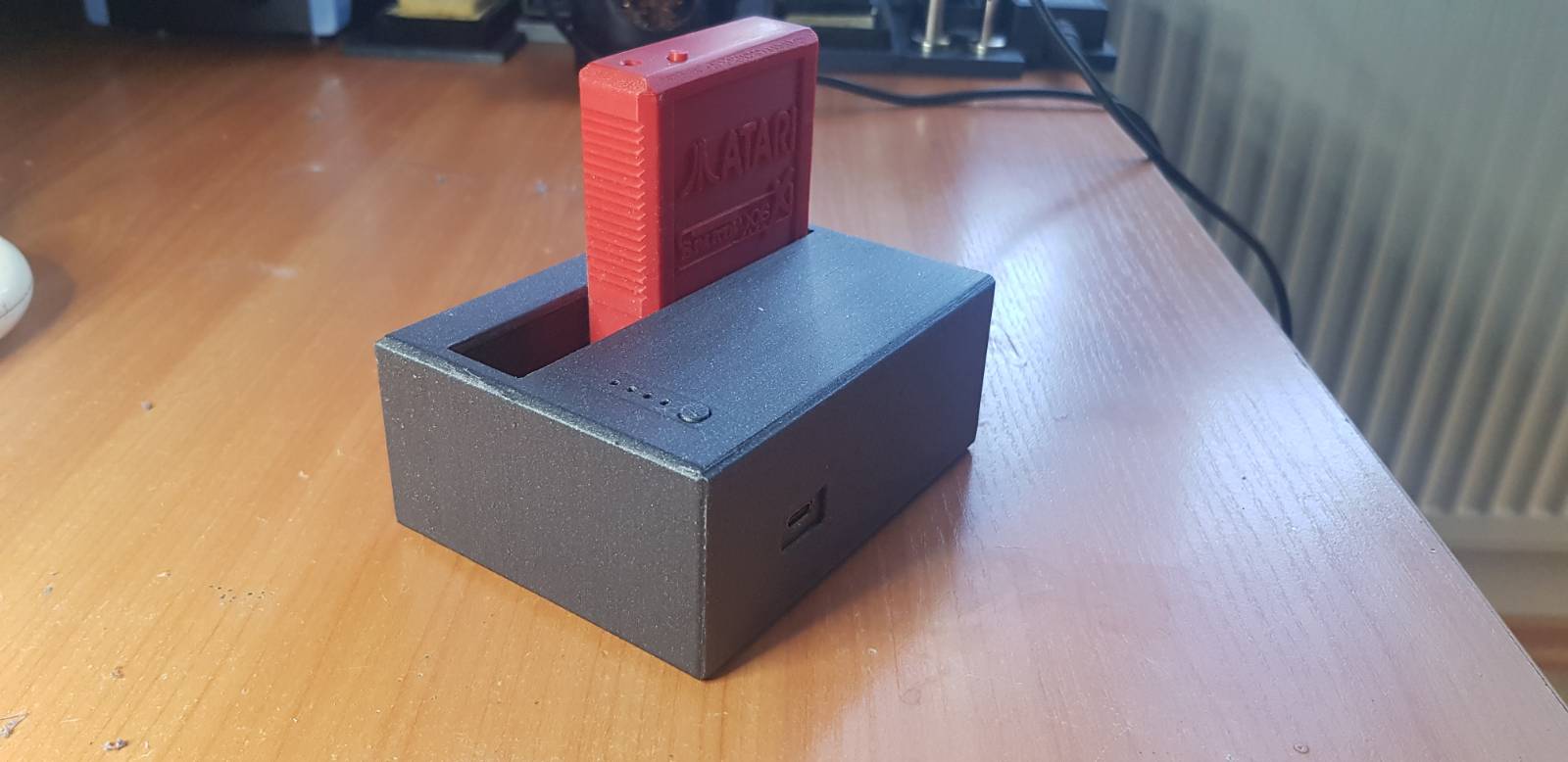

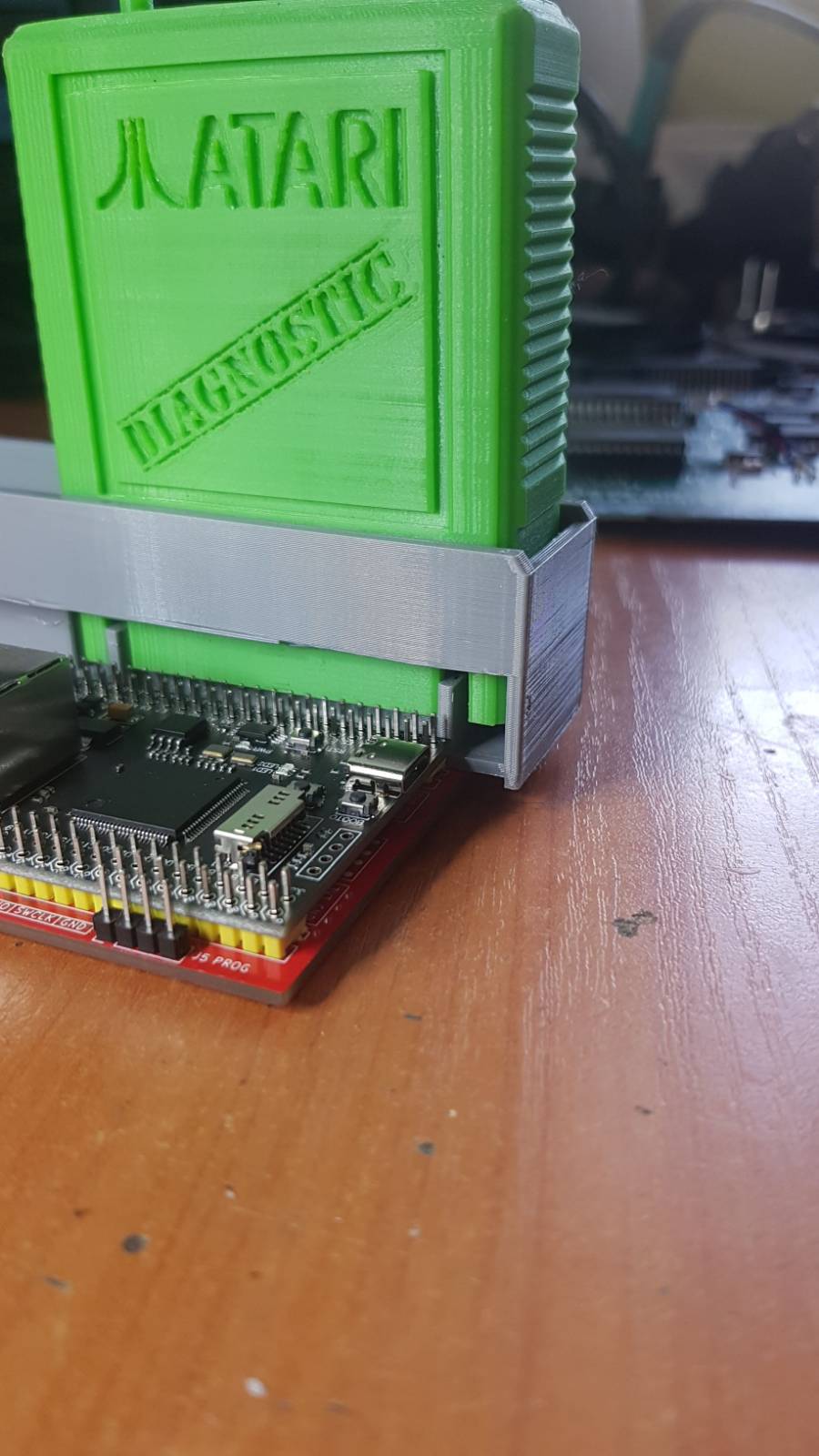

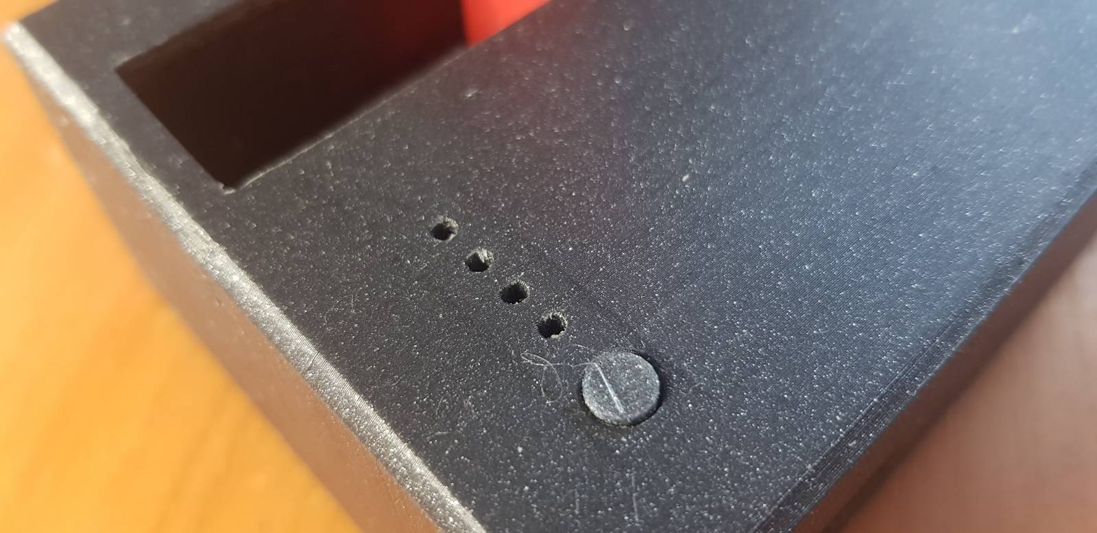

The case
Case was made by @kkrys - still under development....
