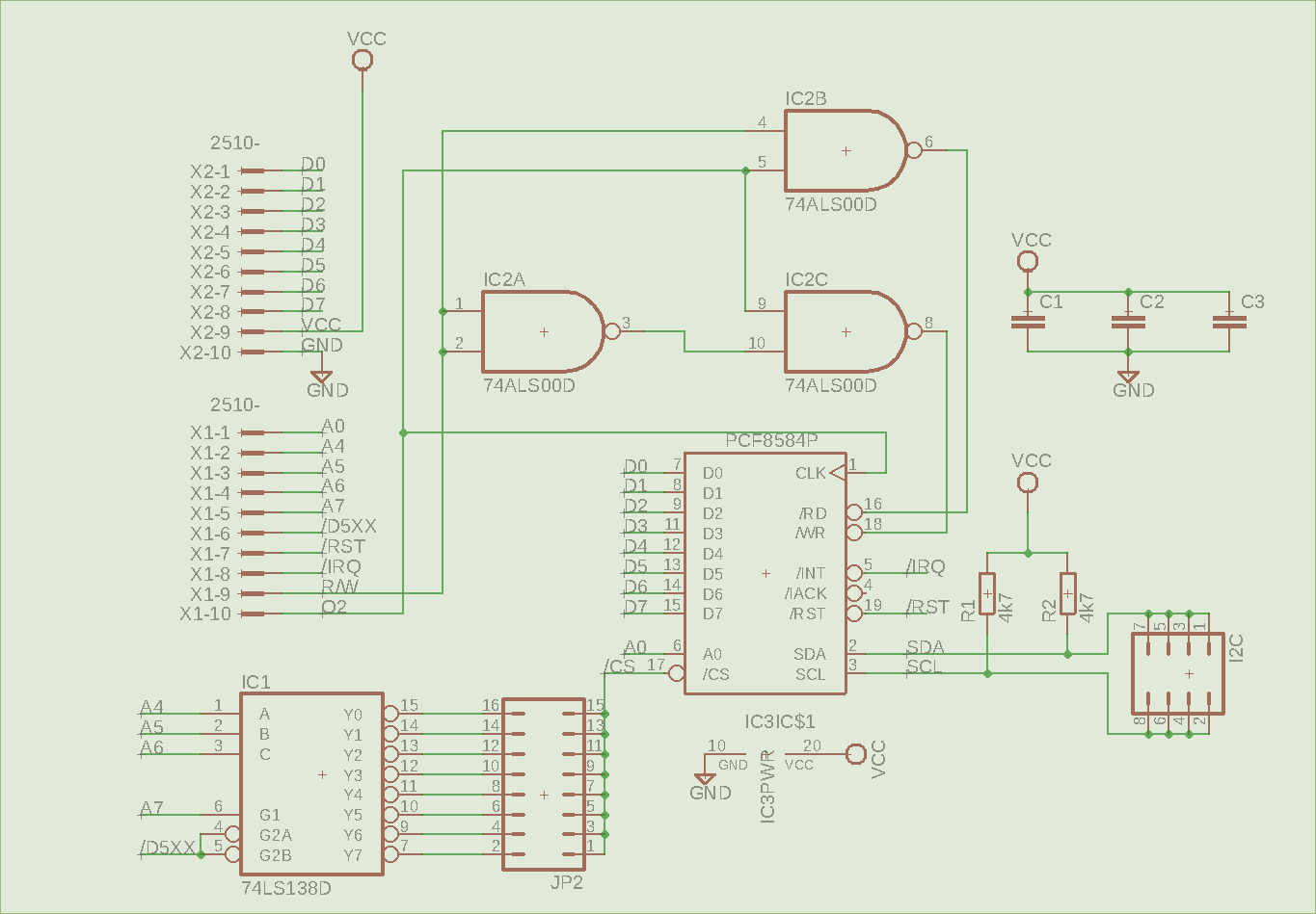

I found IC which will be very helpfully, his name is PCF8584. This IC might work with two different modes, IMC 6800(0) which should be default and 80XX for others processors. Unfortunately 65C02 is working with little bit difficult time frames so the default mode doesn't work with Atari computer. I decided to build additional decoder for /OE and /WE signals and finally to use the 80XX mode.

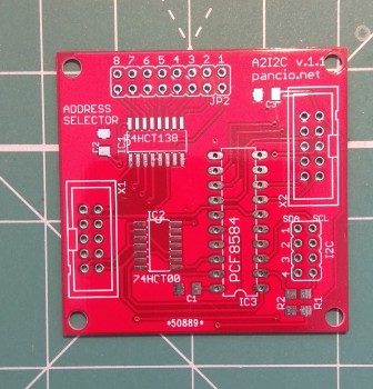

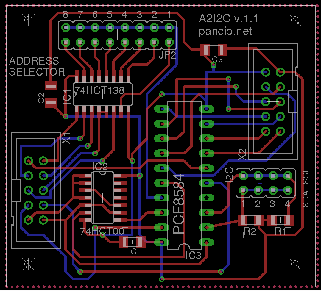

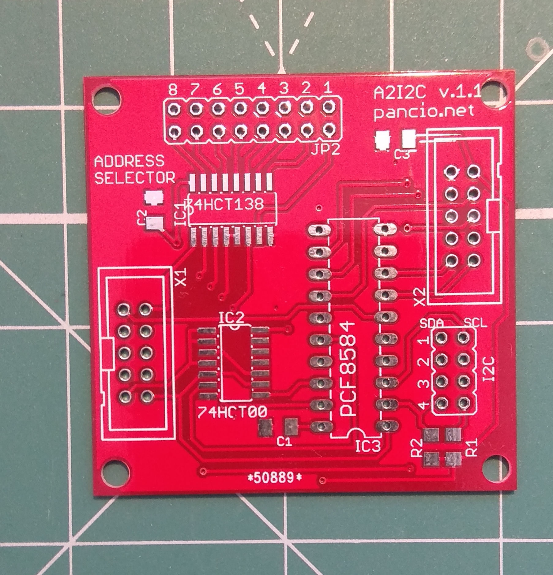

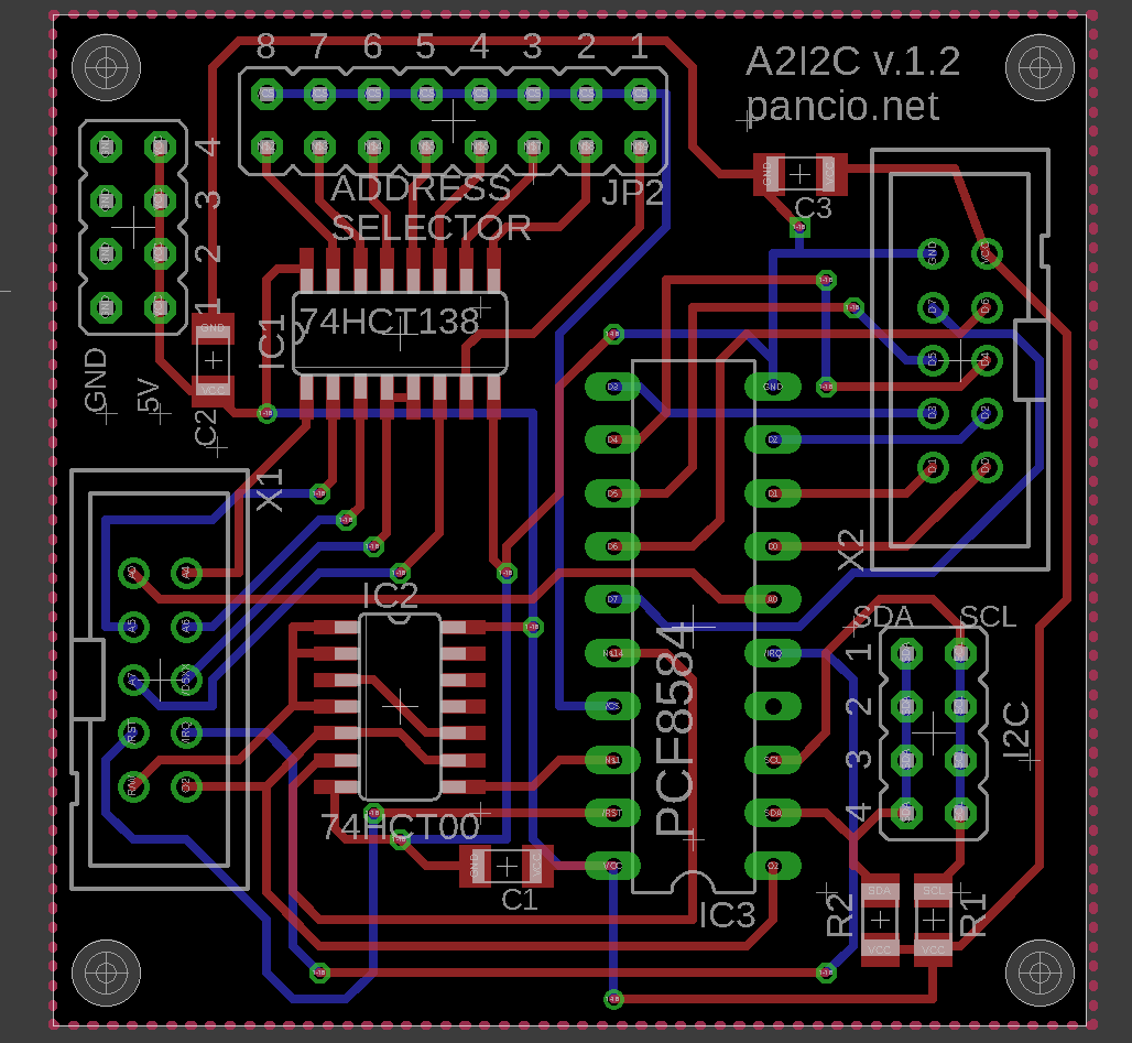

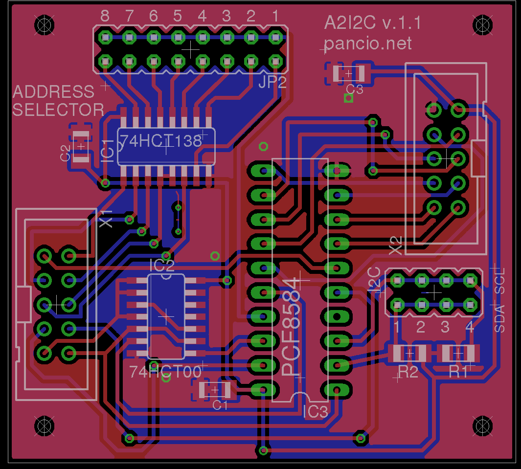

version 1.1 PCB:

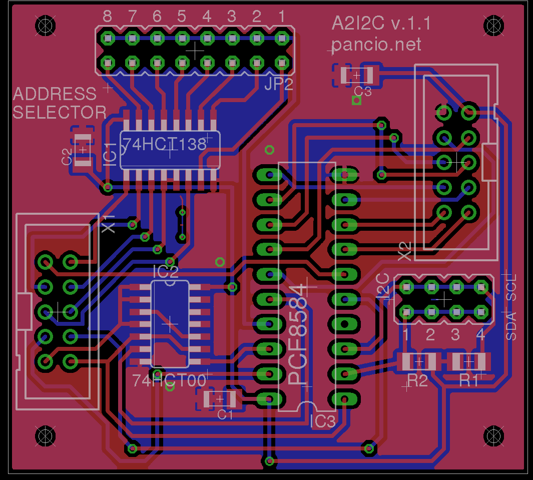

version 1.1 PCBpoly:

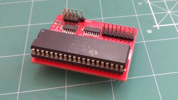

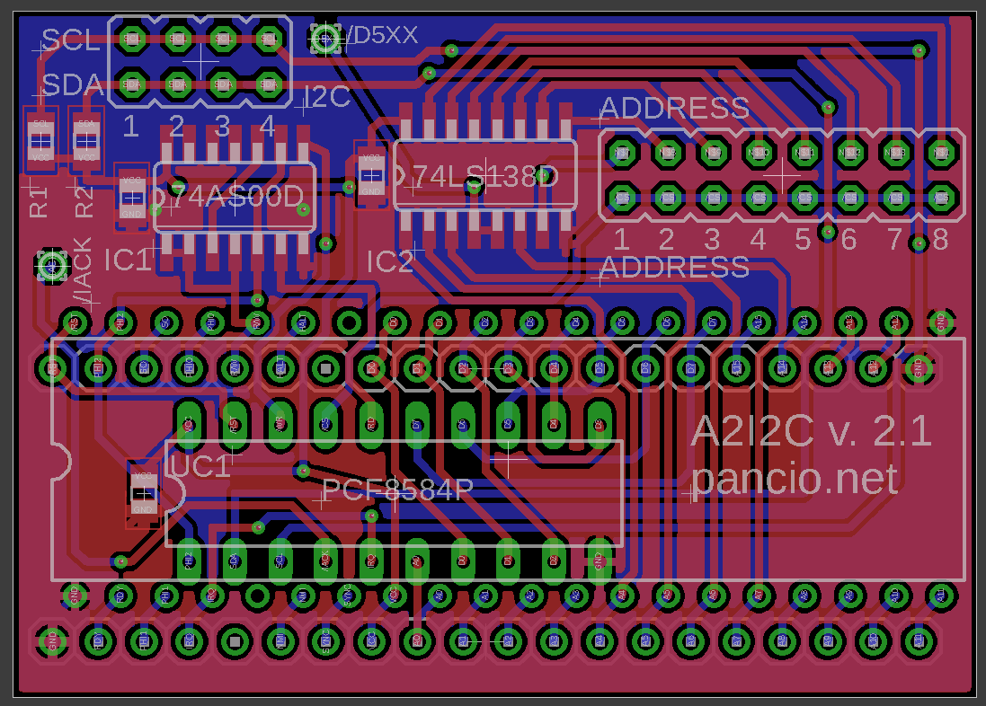

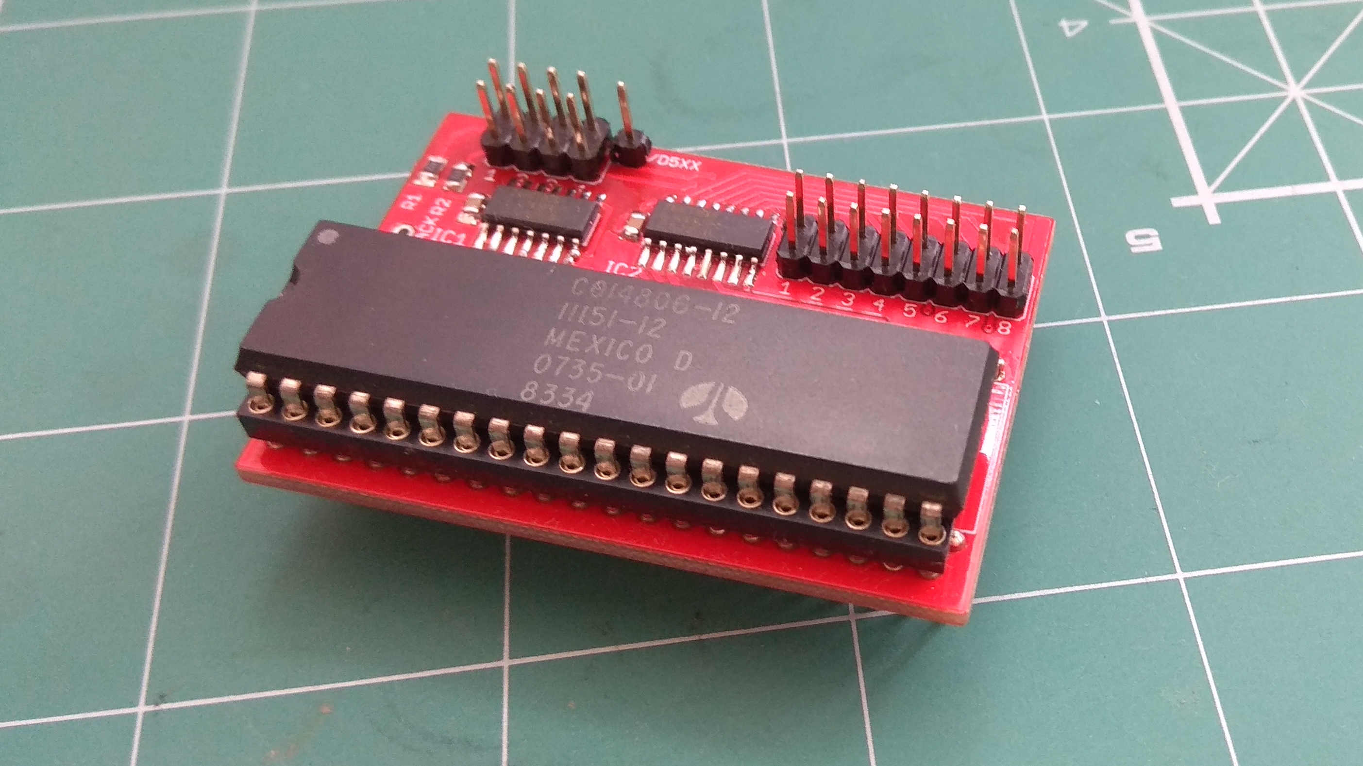

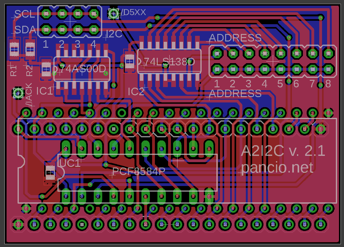

version 2.1 (PCB mounted on CPU):
Quick User Guide for version 1.1:

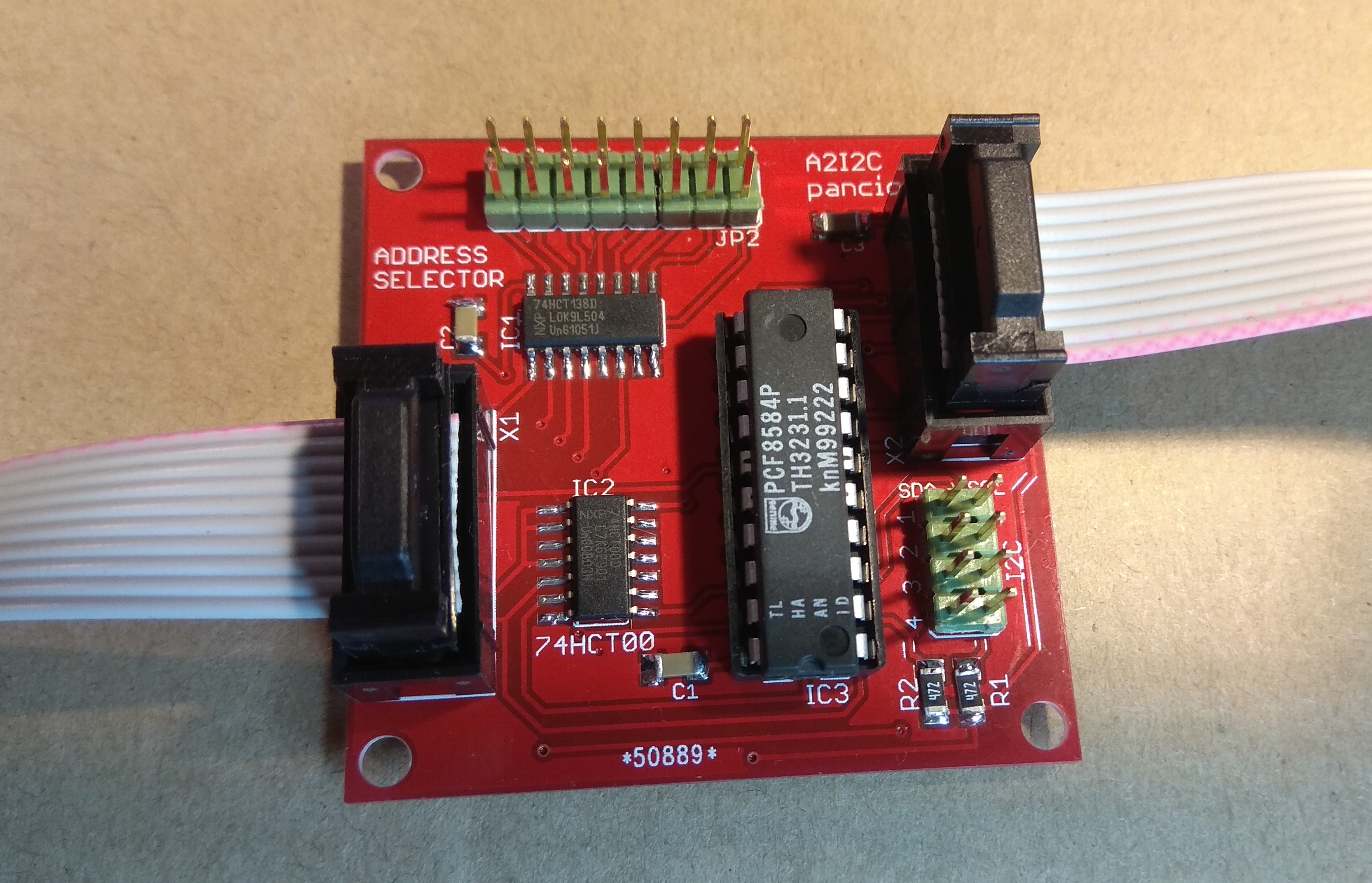

The PCB is prepared with full description so assembly process should be very easy. Just iron required elements on PCB.
Then you must build IDC plugs on strips (one plug per strip) and connect cables to required signals. Most signals you may find directlu on CPU socket on the bottom PCB side.

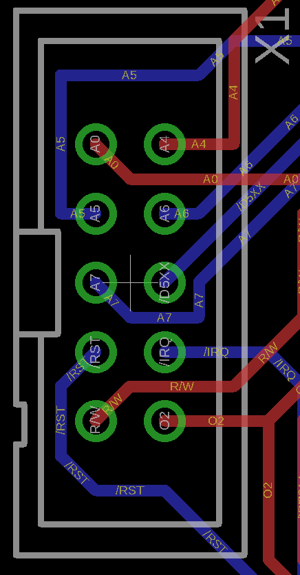

Socket X1:
1 - A0
2 - A4
3 - A5
4 - A6
5 - A7
6 - /D5XX (from cartridge socket or memory decoder)
7 - /RTS
8 - /IRQ
9 - R/W
10 - O2

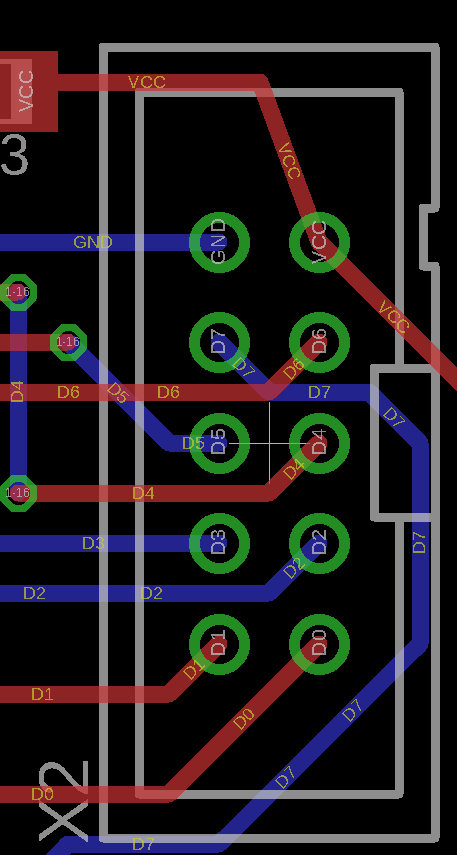

Socket X2:
1 - D0
2 - D1
3 - D2
4 - D3
5 - D4
6 - D5
7 - D6
8 - D7
9 - VCC
10 - GND

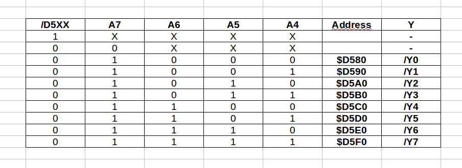

JP2 - address selector (1 jumper!)
Socket I2C:
1,3,5,7 - SDA
2,4,6,8 - SCL
JP2 is determining ADDRESS as provided below:
One important note, decoder which I build is not fully decoding, It's mean that you should to expect shadow register. (e.g. $D580, $D582...$D58E are using to address the same PCF register),
If you were avoid any errors you may connect I2C device directly to I2C socket :-)

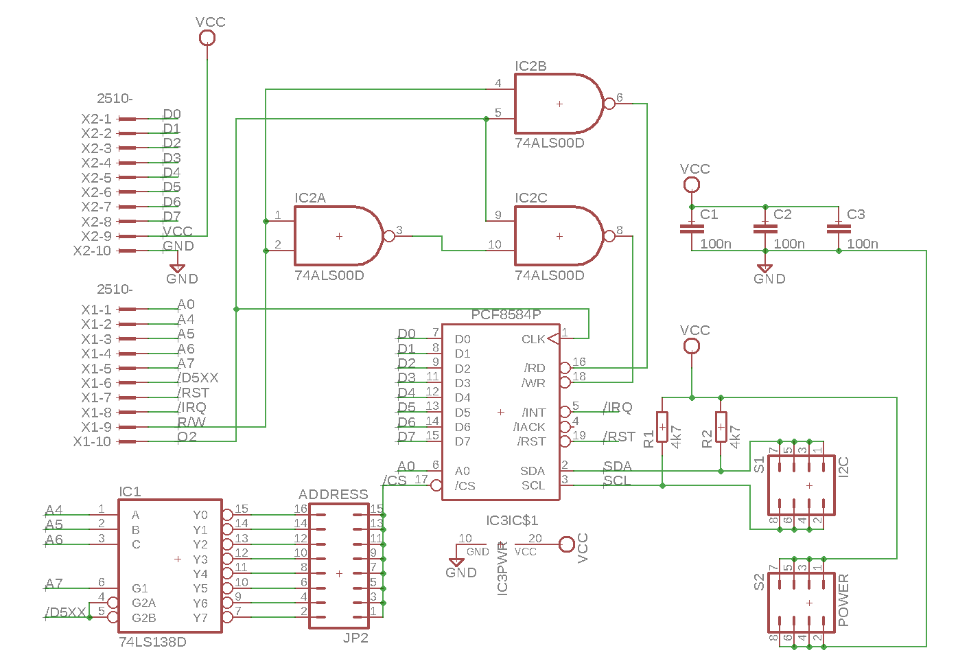

Update for version 1::
If you are planed to mount any I2C device outside the Atari I would to recommend use little bit modified PCB which contain separately socket in order to power I2c devices:
A2I2C v1.2 schematic
A2I2C v1.2 PCB
A2I2C v1.2 PCB
Quick User Guide for version 2.1:
All required signals are available on CPU sockets so only one signal (/D5XX) you should wire from CART socket or memory decoder IC.
Please select address by using 1 jumper (truth table is the same as for version 1.1).
One important note!
There is no possibility to use version 2.1 and close cover for 800XL. If you plan to have closed Atari 800XL - you should to consider to use version 1.1.
I didn't test the interface with XE series, so maybe it's possible for that :-).

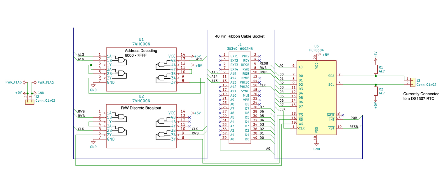

Sorry for the messy photo. Last night I created a schematic for it. Currently I have it wired directly to the 6502 and have it accessible on addresses 6000 - 7FFF. I believe this should work.

Generally it's look very good... (KiCAD)?
Actually I see one issue... please clarify if I'm wrong. You are using the same CLK signal for 6502 and PCF? If yes, PCF will not be capable for so quick operations at all. Nice address decoder but in case you have many shadow registers :-). Did you connect input gate e.g. 4A directly to 5V power? Consider to use resistor 1k-5k :-)

Yup, I used KiCAD and then used Photoshop to add some notes to it.
I'm using the same CLK for the 6502 and PCF currently. I don't need to send very much data via the PCF so I thought it should be fine, at least for testing. Would I be able to use another CLK source if i wanted it to be faster?
Haha, yeah, I know, I got a ton of shadow registers. I'll eventually improve on that part of it and shrink it's addressable space down once I get the rest of the circuit working :)
That's a good suggestion about connecting input gate 4A to a resistor. I'll make sure to do that :D
