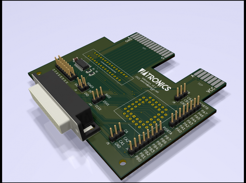

PCB based on standard CART/ECI slot contains VIA6522 two 8-bits parallel ports with control signals. Additional IC 74HCT138 is use as address decoder. All required by printer signals are connected to DB25 female port. On the PCB you may find selector for device address which can be selected from $D100-$D1E0 or $D500-$D5E0 with $20 step ( for INTari version it's $D180 to $D1F0 or $D580 to $D5F0 with $10 step ). Additional four pin header are connected to PA/PB/CA/CB signals and might be use for other task depend of your idea :-) If you are using cartridge e.g. Koala Illustrator or some text editor, you may use it together with VIAtronics but you need to check addresses used by cartridge to avoid conflict with VIAtronics. There is a few differences between VIAtronics CART/ECI, VIAtronics CART and VIAtronics 2.2 (INTari) which were described below.

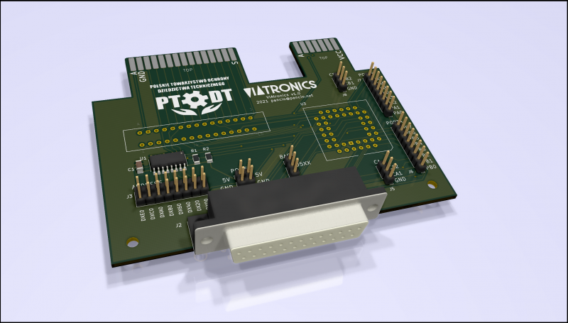

Design - VIAtronics 1.0 CART/ECI version
On the begging I planned make the CART/ECI version only for 65/130XE but when under tests - first page was printed, I decided to make the interface more available for other users... but now let's talk about the first version...
VIAtronics 1.0 3D project

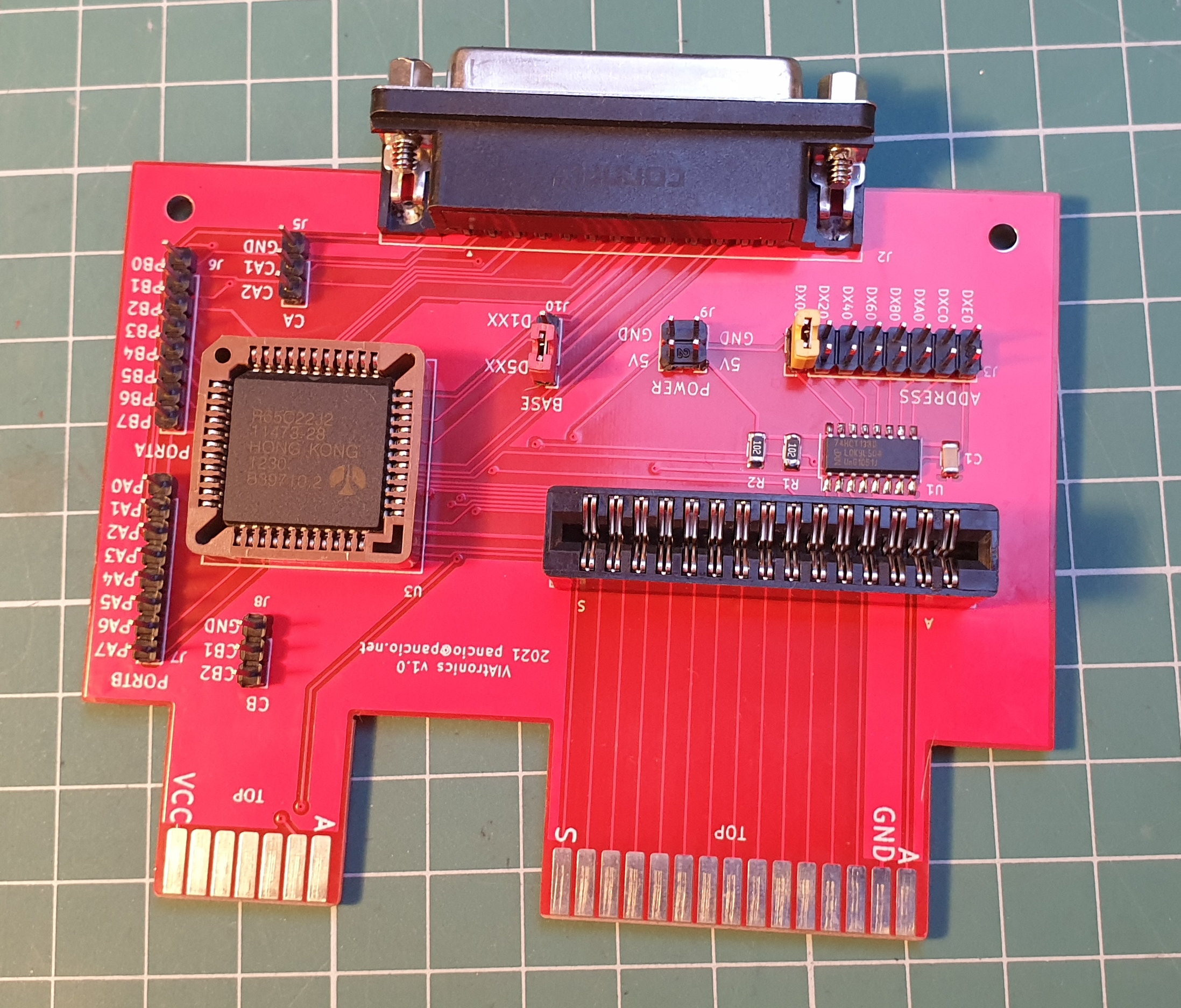

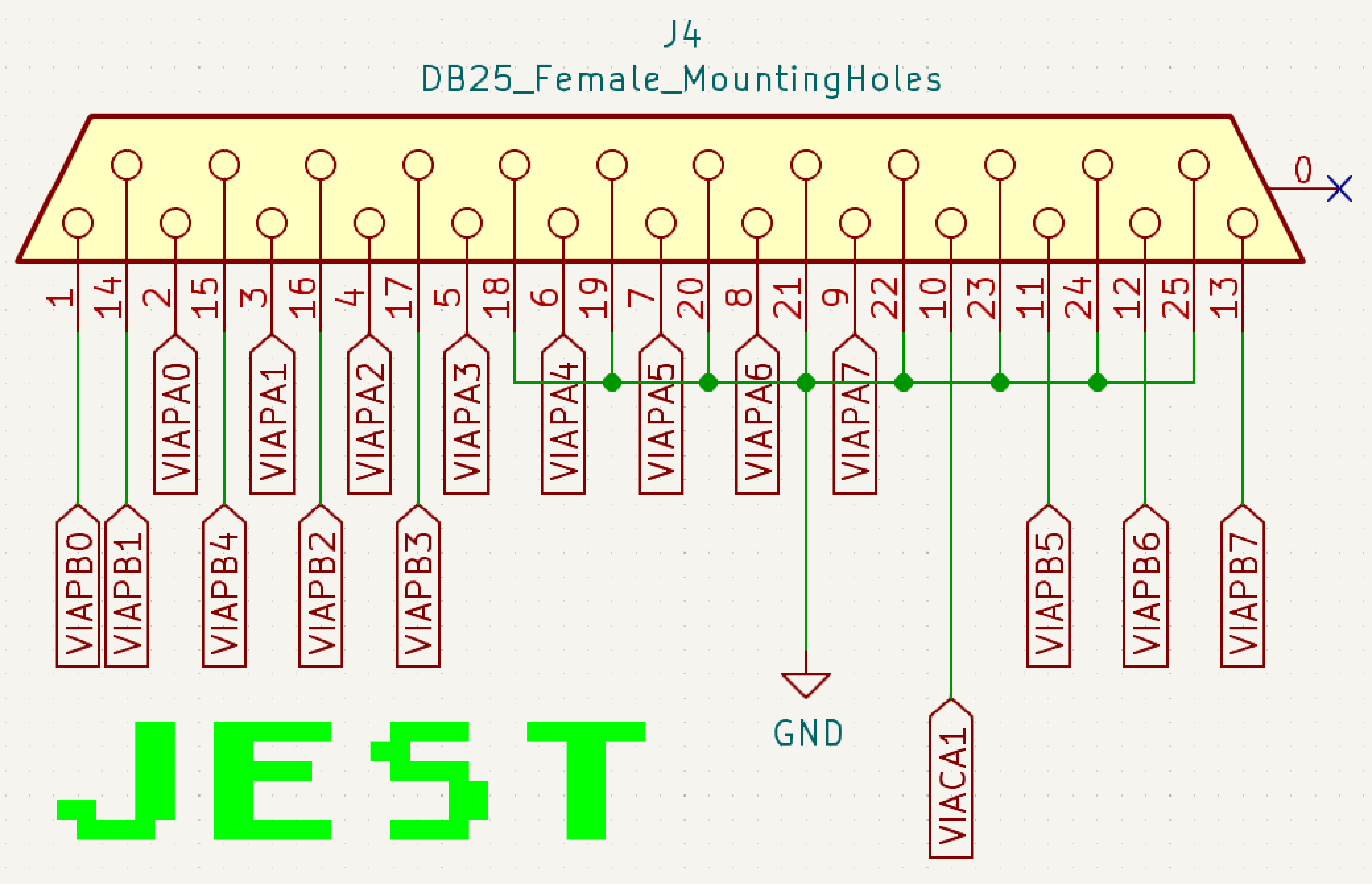

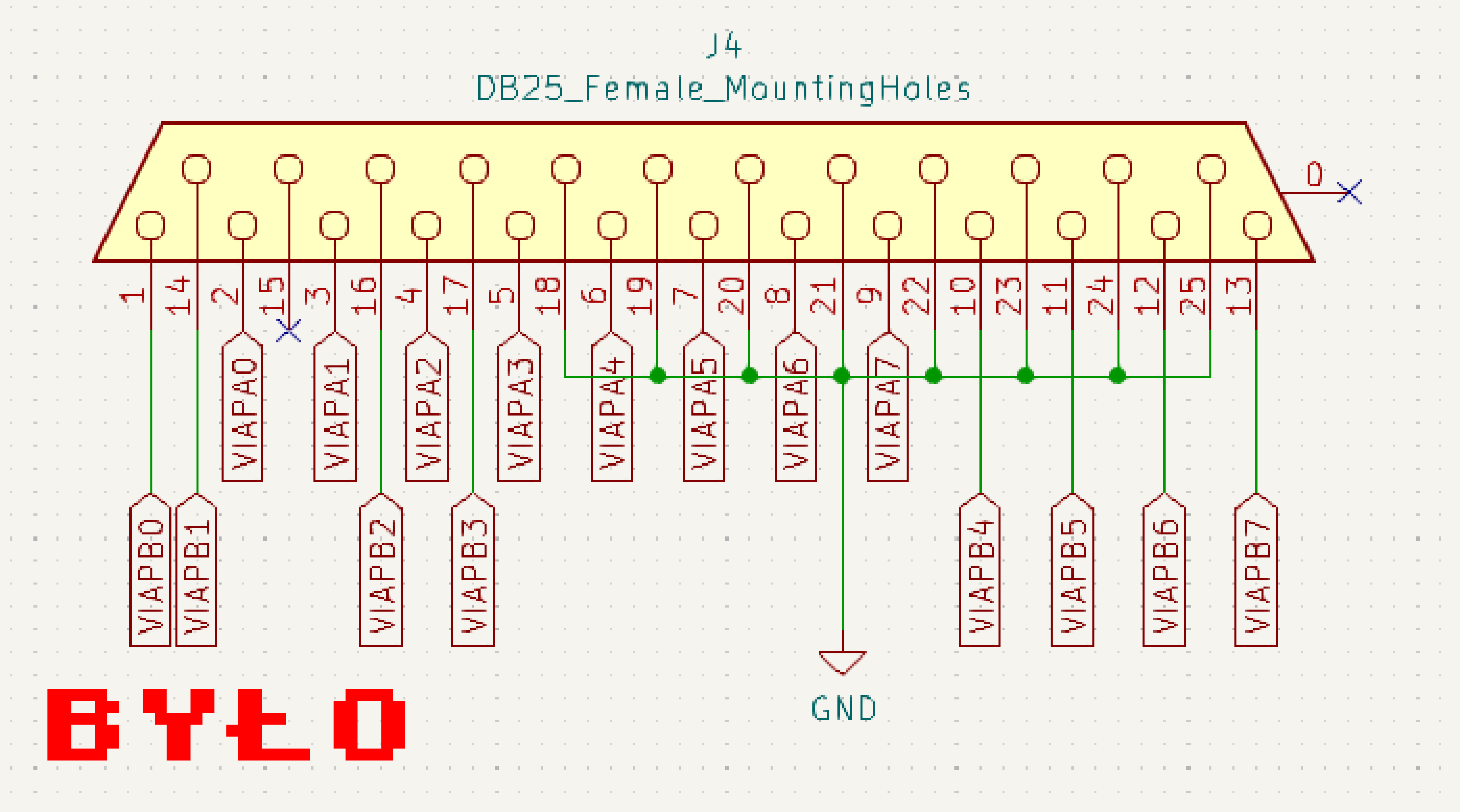

The idea is that you may use interface not only for printing... you may use this device for everything you want to connect to parallel two ports! e.g. display, COVOX, speech synthesizer... anyway, when I received PCBs I found description's mistake on the board:
Description mistake
Description mistake
Don't worry, it's exist only on my developing board and has no influence to working device. Attached schematic and board has eliminated this issue. So, assembled board looks like:
Assembled VIAtronics 1.0

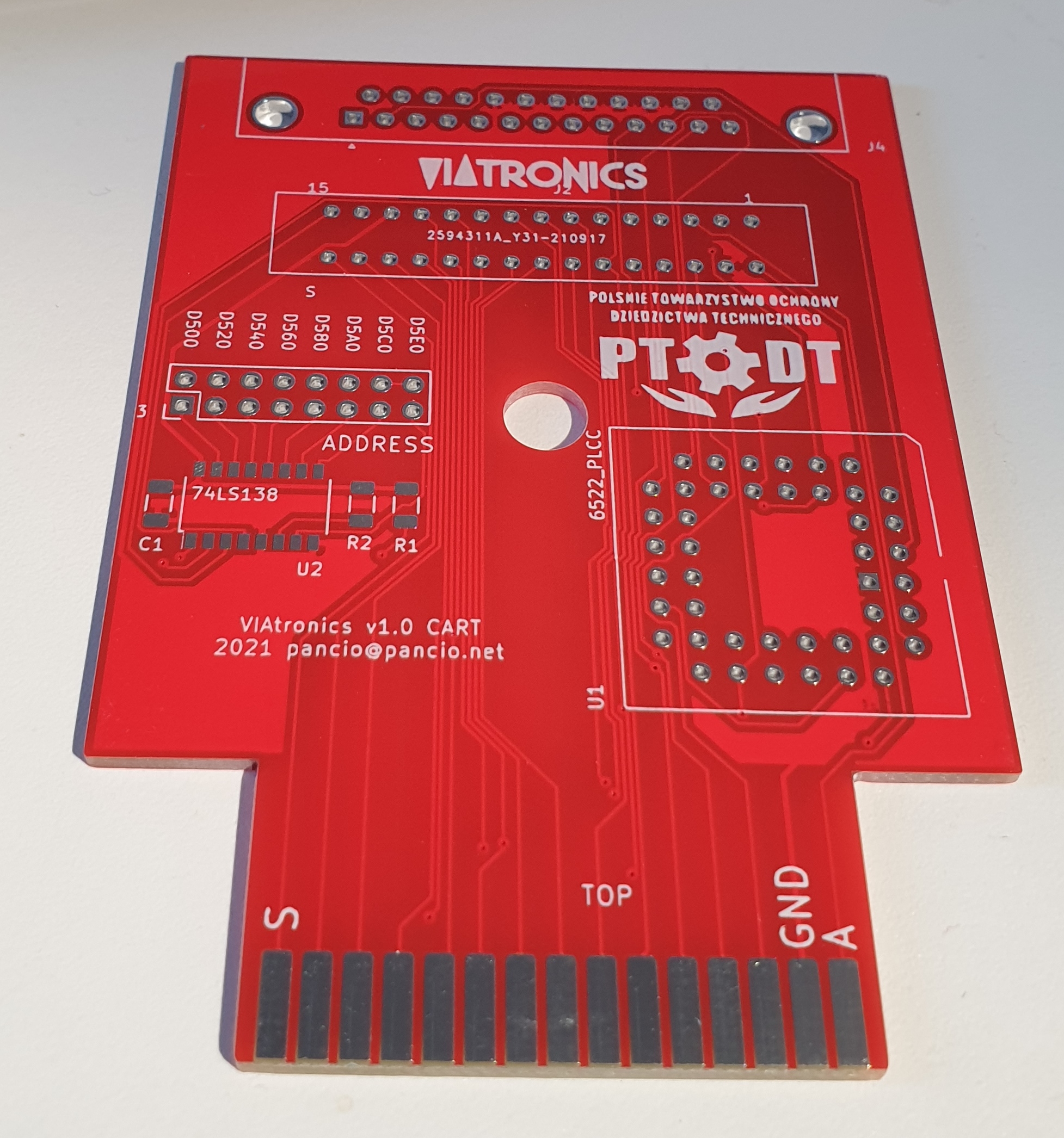

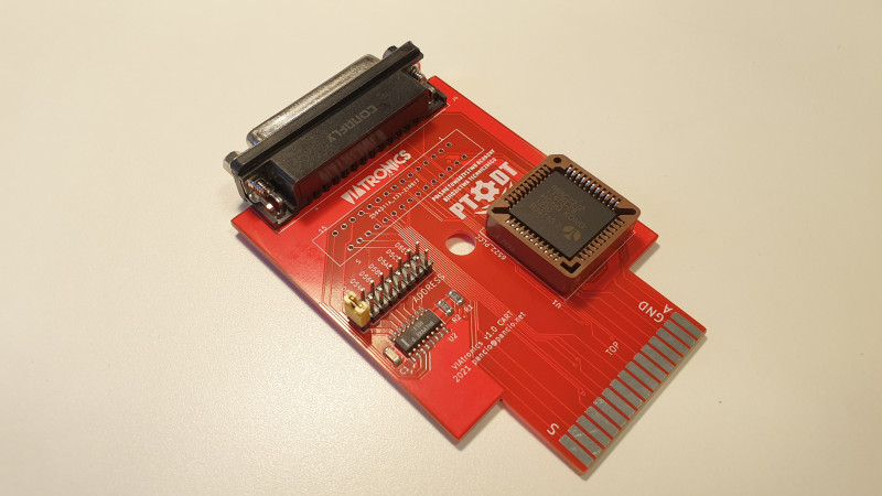

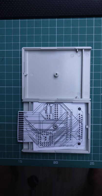

Design - VIAtronics 1.0 CART version
This is most flexible variant of VIAtronics! It may be use with any Atari XL/XE and probably with Atari 800 too. We (me and PTODT members) decided to make pretty looks board closed with modern cartridge and delivered to users with professional user manual. So, in case I spend much more time to arrange PCB layout...
Dimensions test
Dimensions test
VIAtronics 1.0 CART board
The differences with VIAtronics 1.0 CART/ECI:
- lack of signals /IRQ and /RESET
- only D5XX addresses might be use.
I understand that some functionality was dropped but the CART version is still developers friendly without /IRQ and /RESET... don't forgot! Printing is the most important feature and it's the same as in previous version.
Completely assembled device:
Assembled VIAtronics 1.0 CART

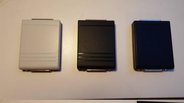

Possible case variants:
VIAtronics cases
VIAtronics cases

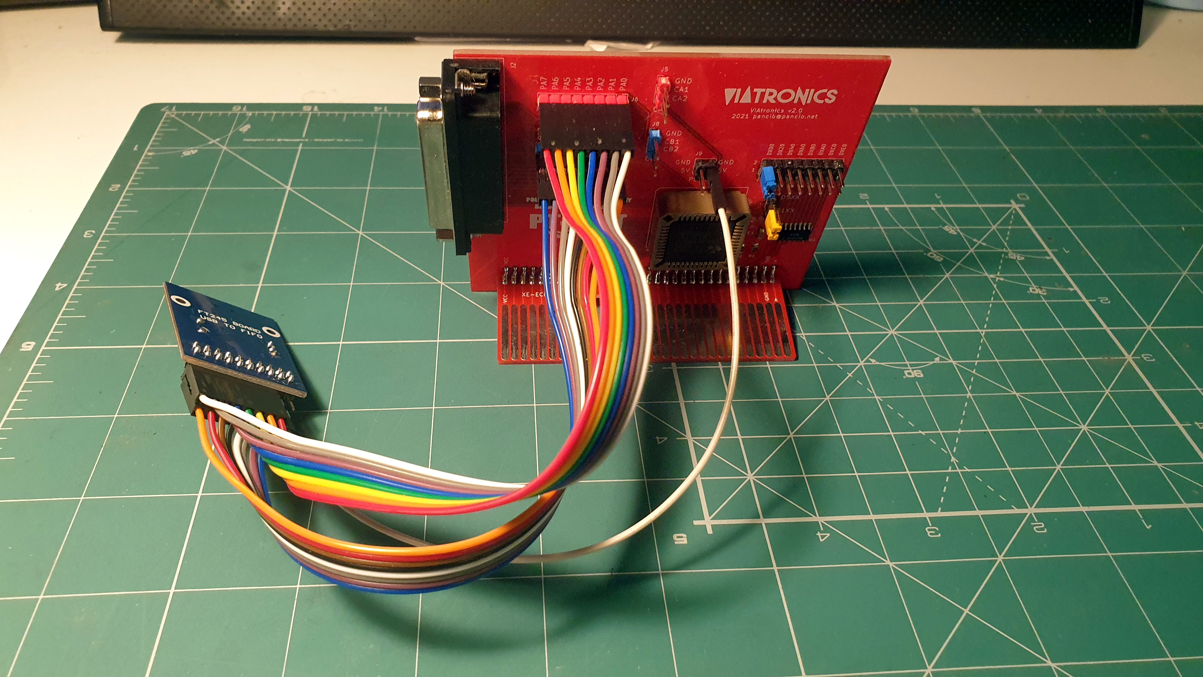

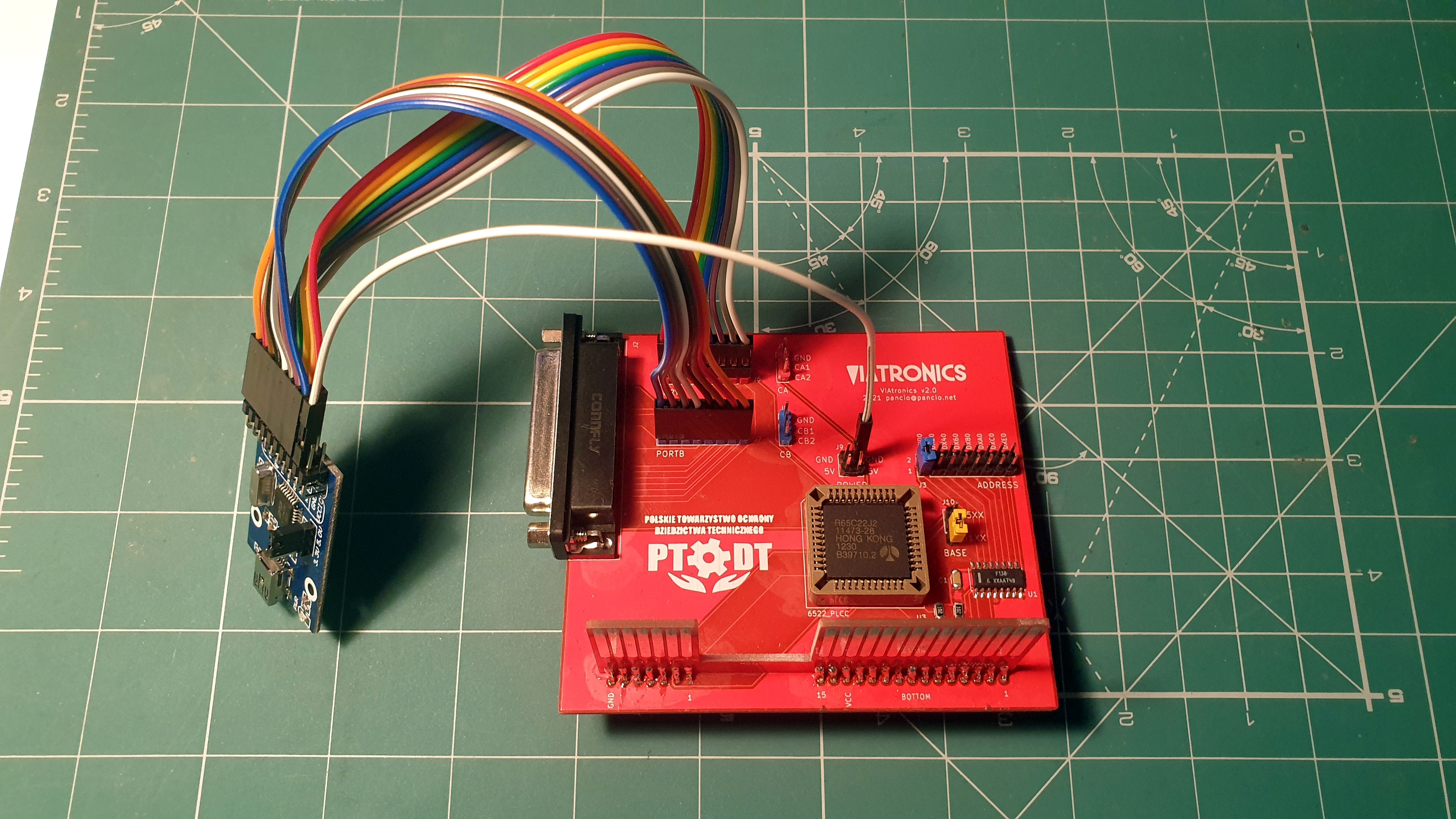

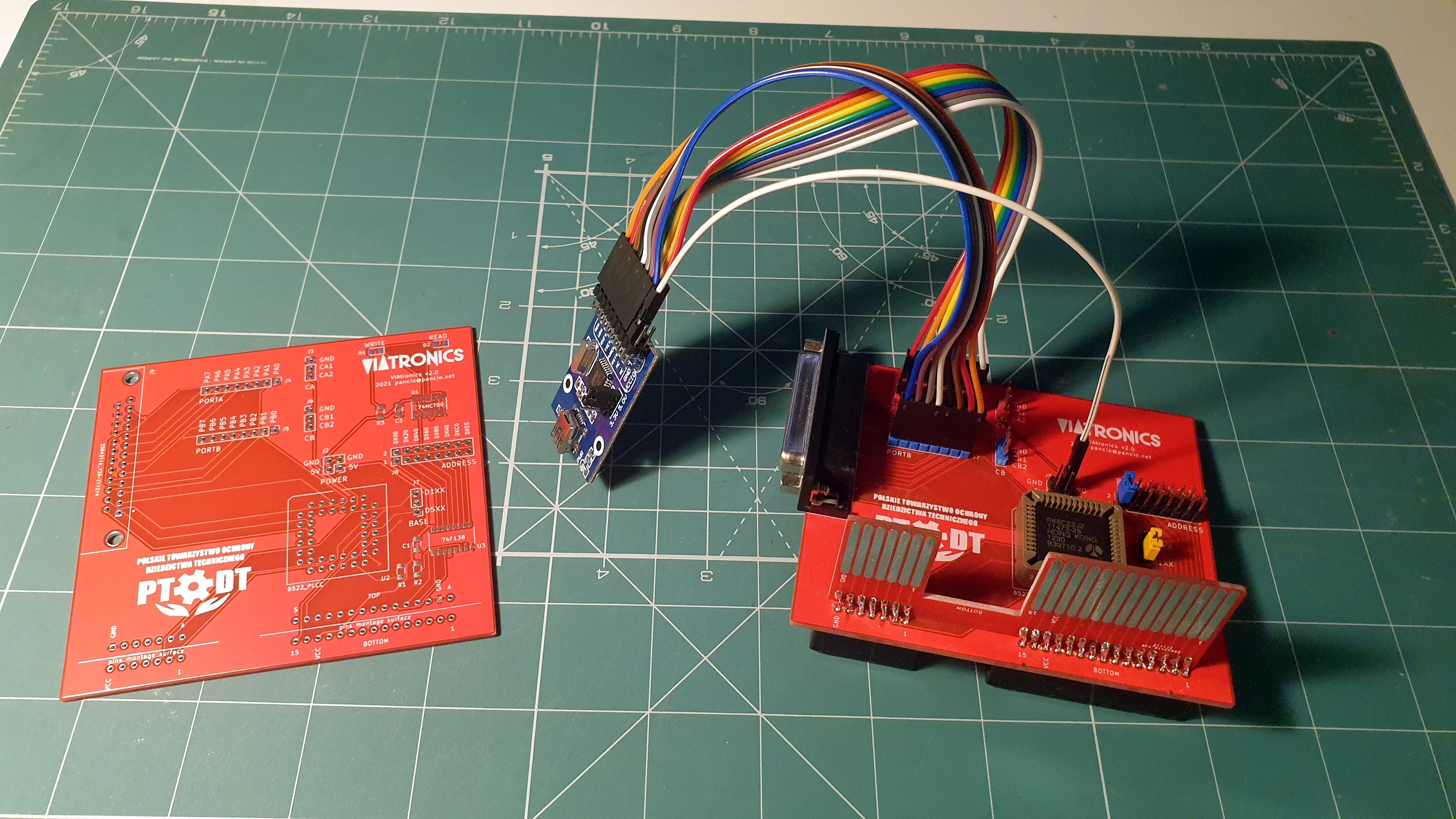

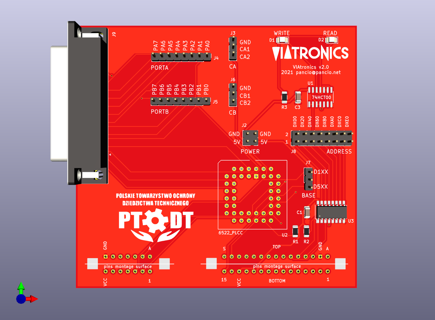

Design - VIAtronics 2.0 CART/ECI VERTICAL
Somebody ask me why not vertically version... well... my desk is big but somebody need to connect more than one device to CART/ECI slots...
VIAtronics CART/ECI VERTICAL board
VIAtronics CART/ECI VERTICAL board with FT245 connected

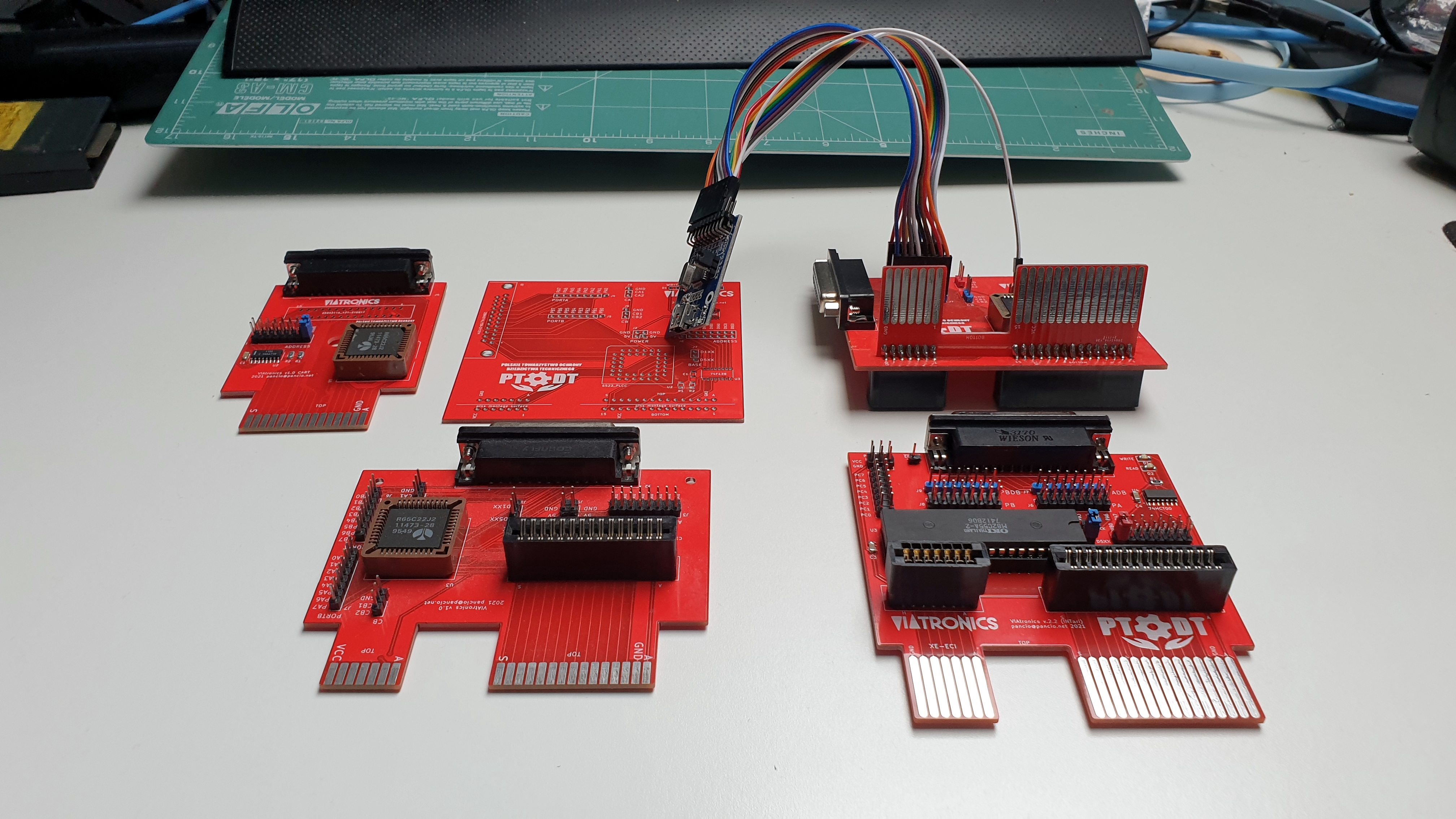

Unfortunately under tests, the DB25 socket was too close to Atari case and it's rather not possible to use it with top case (without socket you can use it!). Additionally I found description issue... all issues were corrected and new PCB arrived (not assembled jet):
VIAtronics CART/ECI VERTICAL board with some issues eliminated
Additionally I added READ/WRITE indicators (I hope it work)

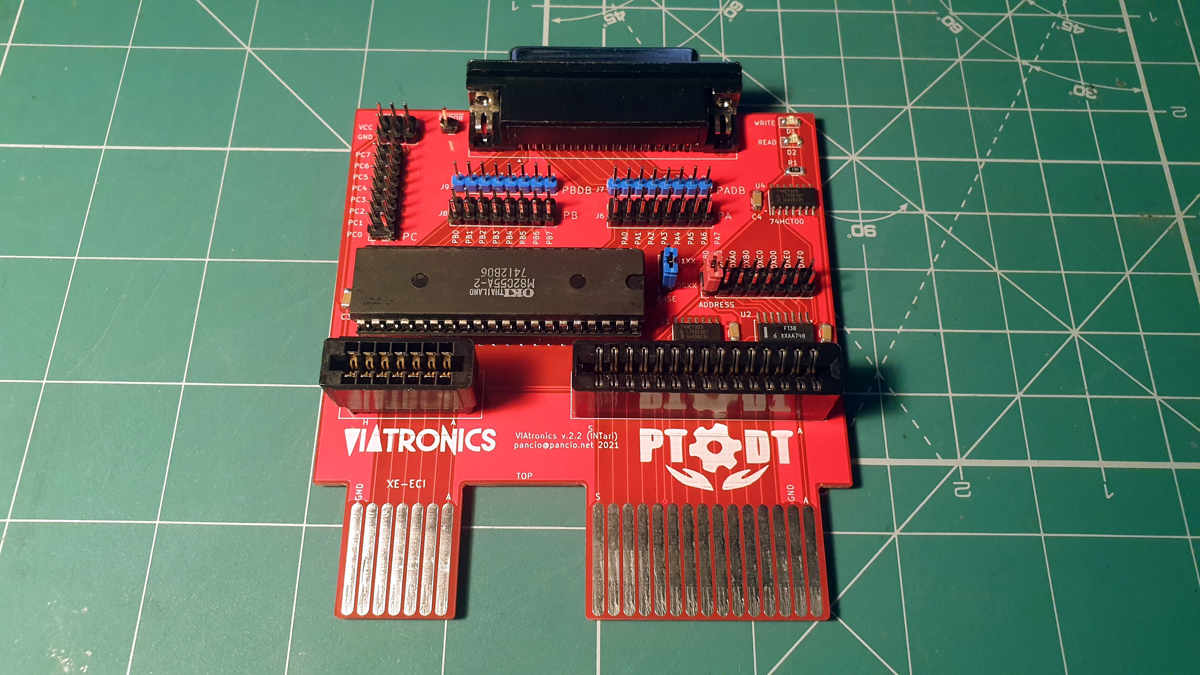

Design - VIAtronics 2.2 CART/ECI INTari
I hope, it's the last one project related to printing... This one is strange different.. it using Intel 8255 peripheral interface which contains three independently parallel eight bits ports without pull-up. There is most important, because you may use it with some devices like CH376 USB Host Controller. Of course printing(*) is possible as well. 8255 is cheaper and still available on many markets so it's good alternative for VIA6522.
(*) At this moment, Drukarz software can't print using INTari but it should be changed shortly.
VIAtronics 2.2 - INTari assembled
Finally... whole VIAtronics family together :-)
VIAtronics family :-)

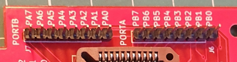

VIAtronics - modification for new print driver
Hi!
Our colleague @mono in cooperation with @atarifun made new very useful driver for VIAtronics (and JOYSTAR - very funny Centronics port based on Atari's joystick ports). In order to be fully compatible with this driver, easy modification should be made:
Before fix
Before fix
After fix
After fix
This modification adding data flow control between printer and Atari.
