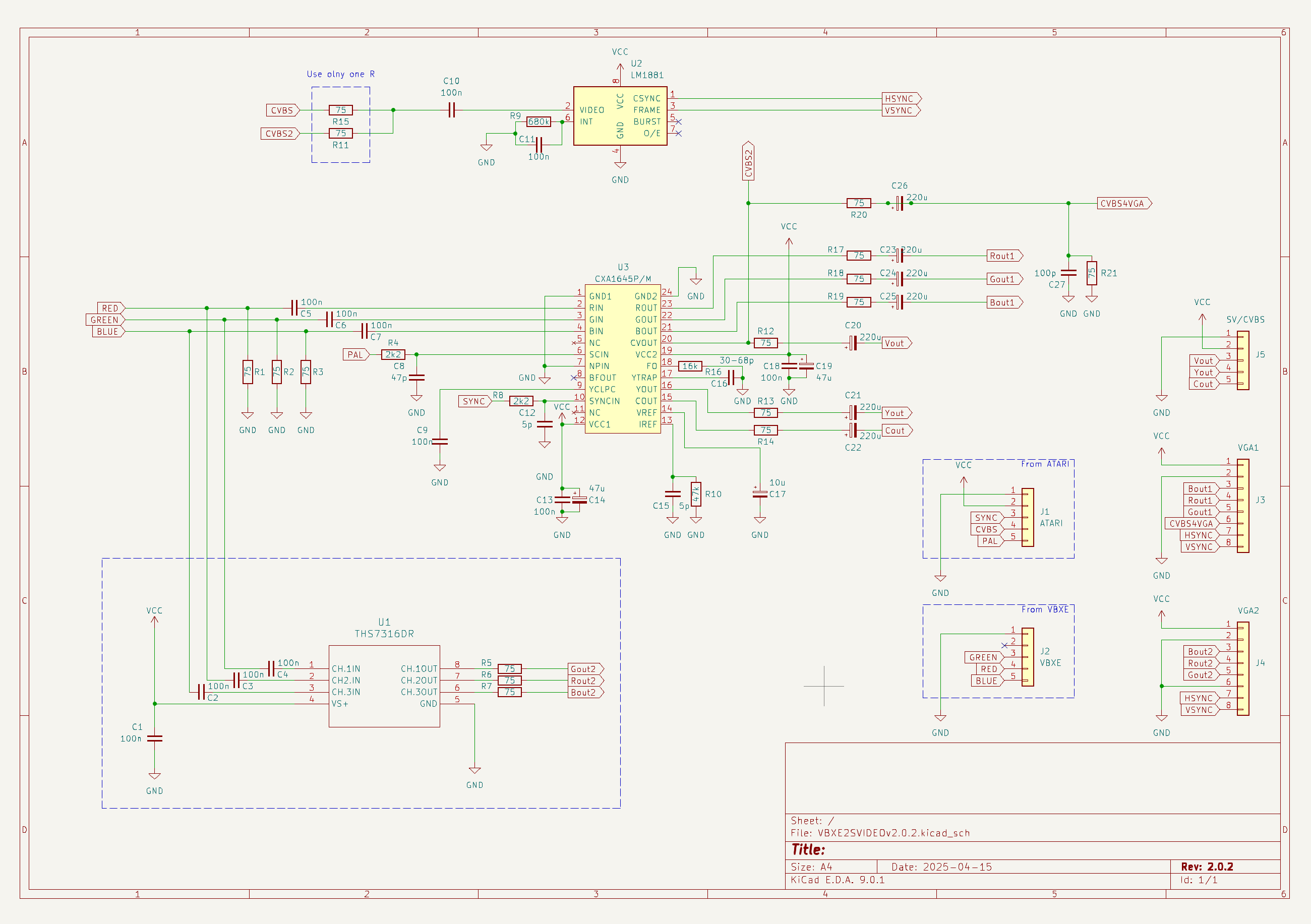

I would like to present another interesting interface that allows the processing of RGB signals from VBXE into very good quality SVIDEO and CVBS signals. The interface described below also allows you to connect two VGA receivers or a receiver and a converter to HDMI without compromising the quality of the SVIDEO and CVBS output.

Schematic
The device structure is shown in the diagram below:
SavoNARA: VBXE2VGA Schematic

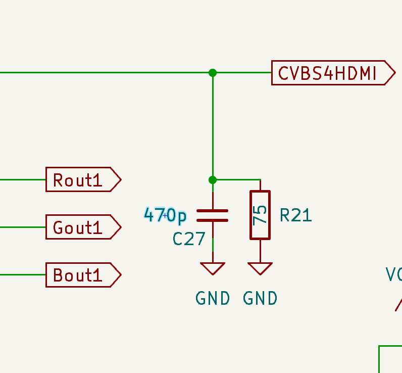

FIX 1.
We are discovered one issue with synchronization when black picture were displayed. C27 shall be changed to value 470pF instead 100pF as shown on schematic:
Fix 1
