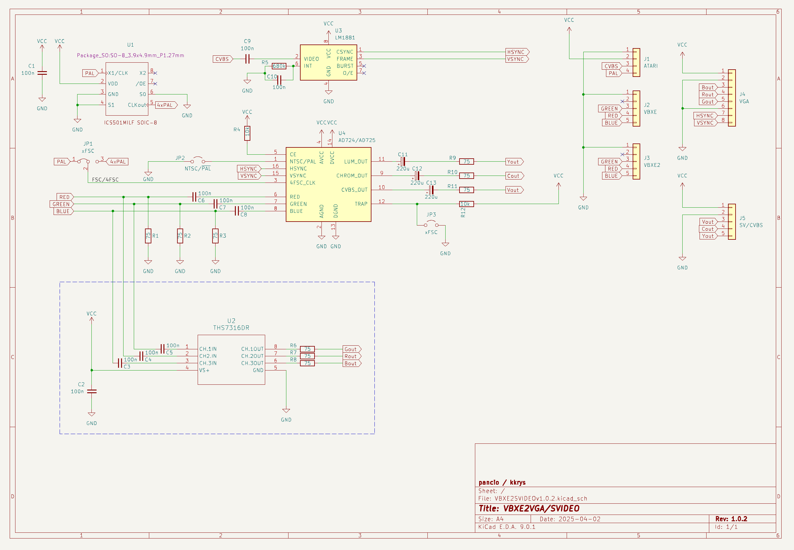

The device structure is shown in the diagram below:
The main element here is the AD724 or AD725 chip, which is an integrated decoder of RGB signals on SVIDEO and CVBS.
For correct operation, the AD724/5 requires additional synchronization signals H and V generated by the LM1881 chip - these signals are also needed to create a full VGA. Additionally, the RGB signals are amplified and improved using a video amplifier THS7316DR.
It is also worth mentioning the PAL x4 frequency multiplier implemented on the ICS501 system - it allows for better processing of RGB signals and, consequently, obtaining a nicer SVIDEO image.
The NTSC/PAL operating mode selection is connected by creating a jumper JP2 (shorted for PAL) and the frequency conversion by jumper JP1 (open for 4x PAL). If we do not plan to use the quadruple PAL frequency, we do not need to install the ICS501 integrated circuit

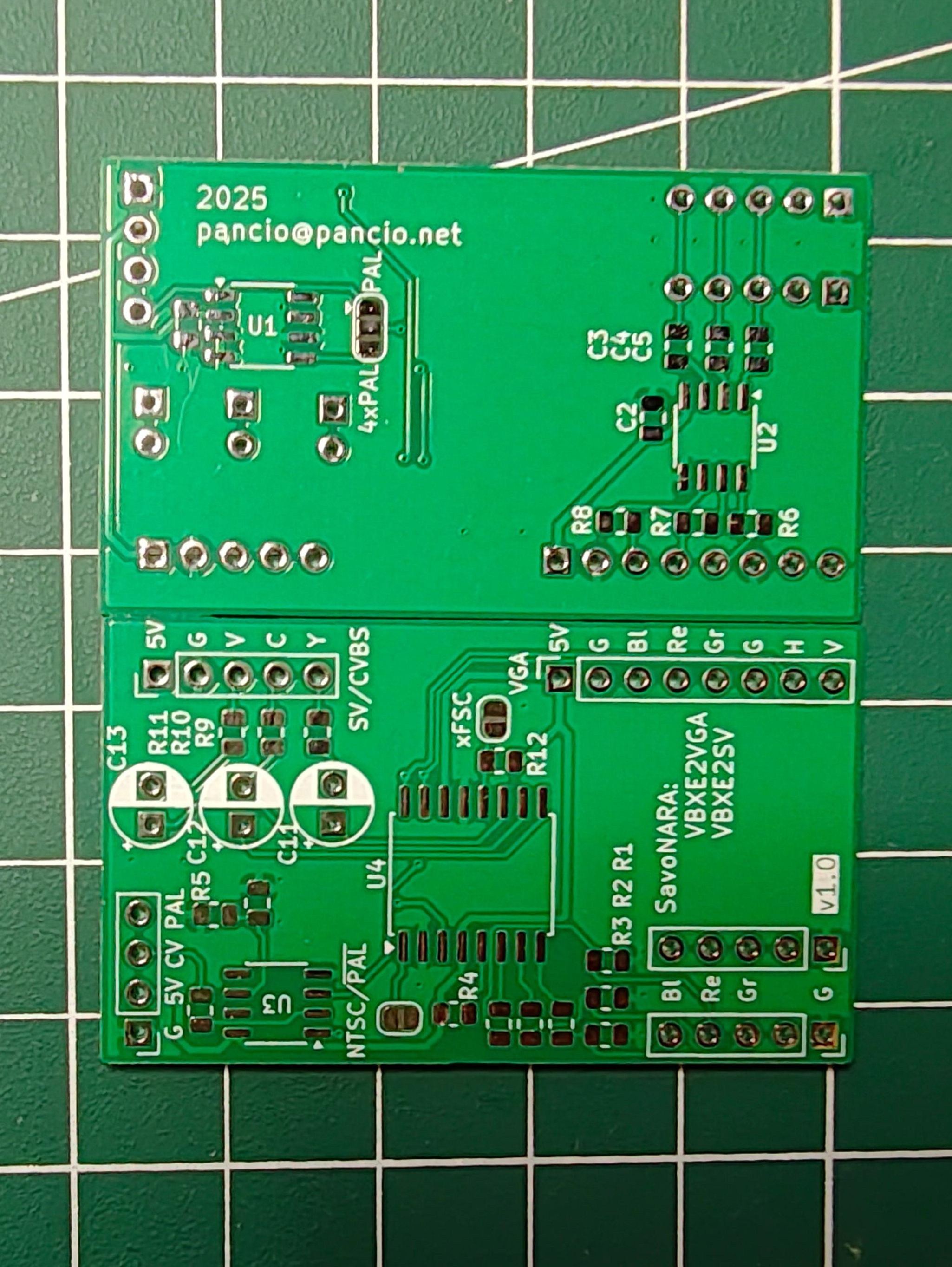

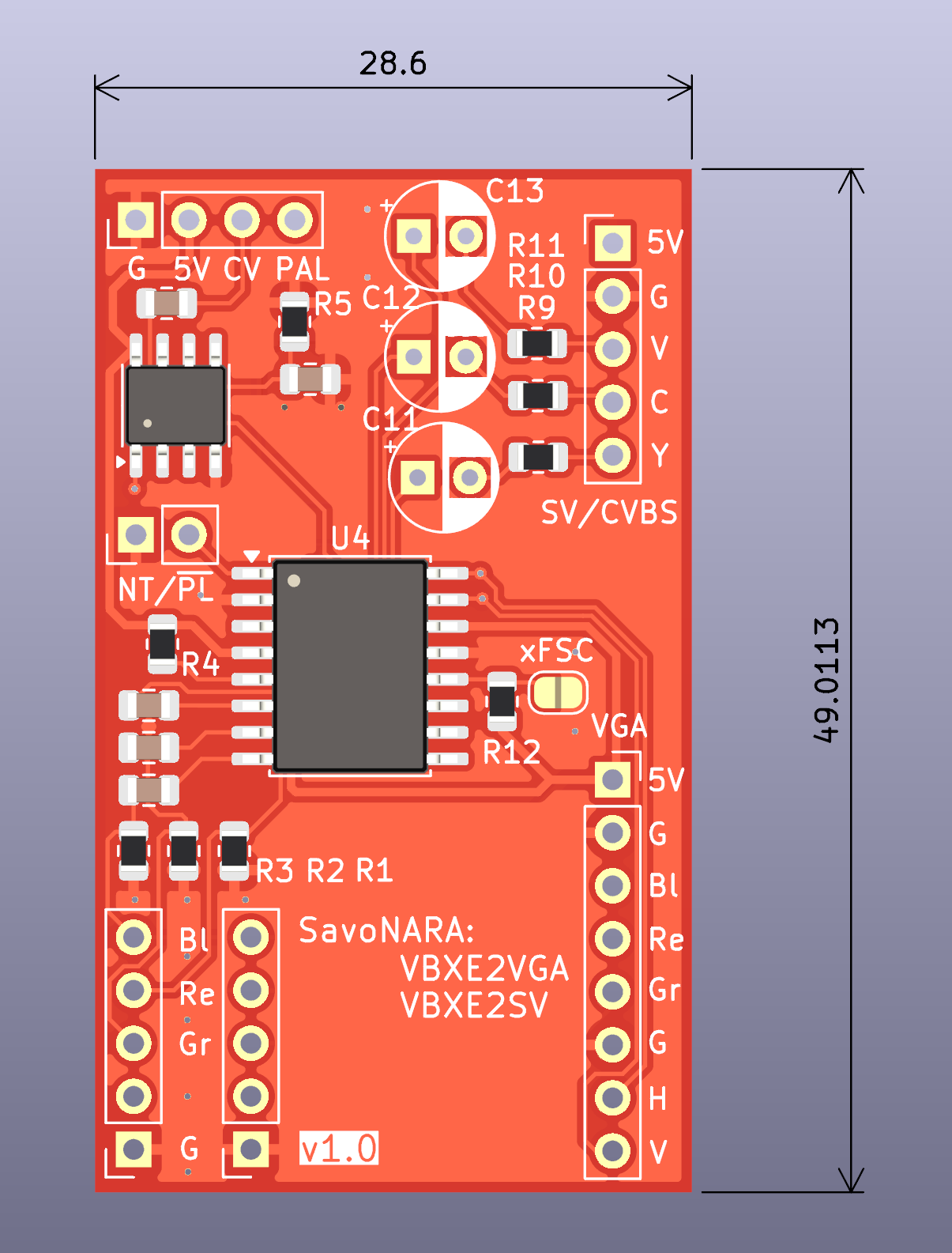

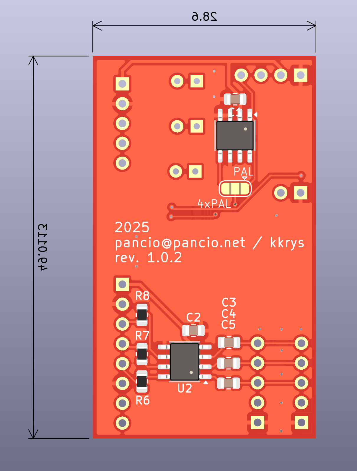

PCB layout
The PCB has dimensions 28.5mm x 49 mm and can be directly connected to VBXE RGB SLOT.:

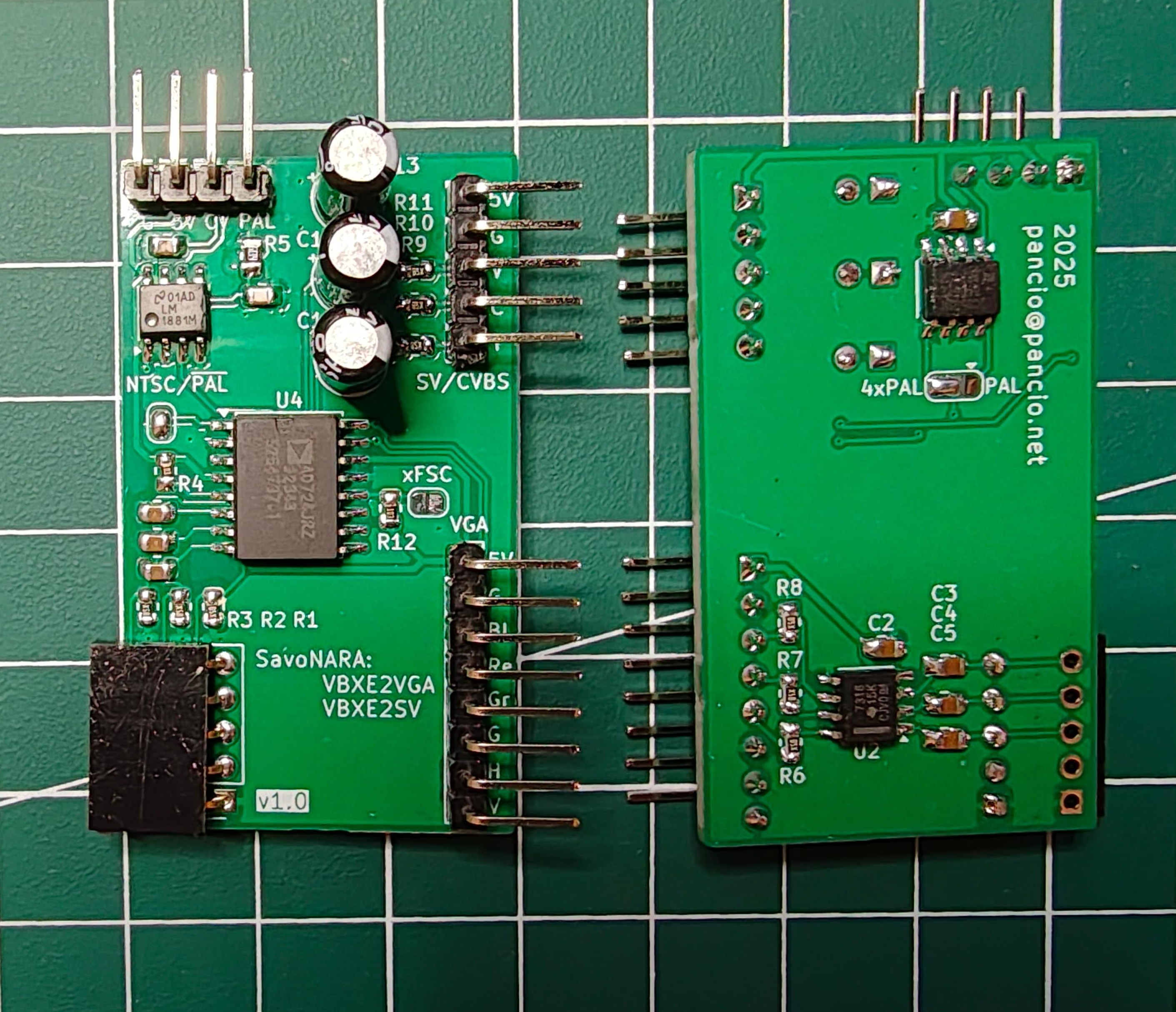

It is best to start assembling PCB with passive components. The board is relatively large, so there should be no problems. I used mostly solder pads for 0805 components, but it is much more convenient to solder 0603 components on them. In the next stage, we assemble integrated circuits and in the last stage, sockets/pin strips.

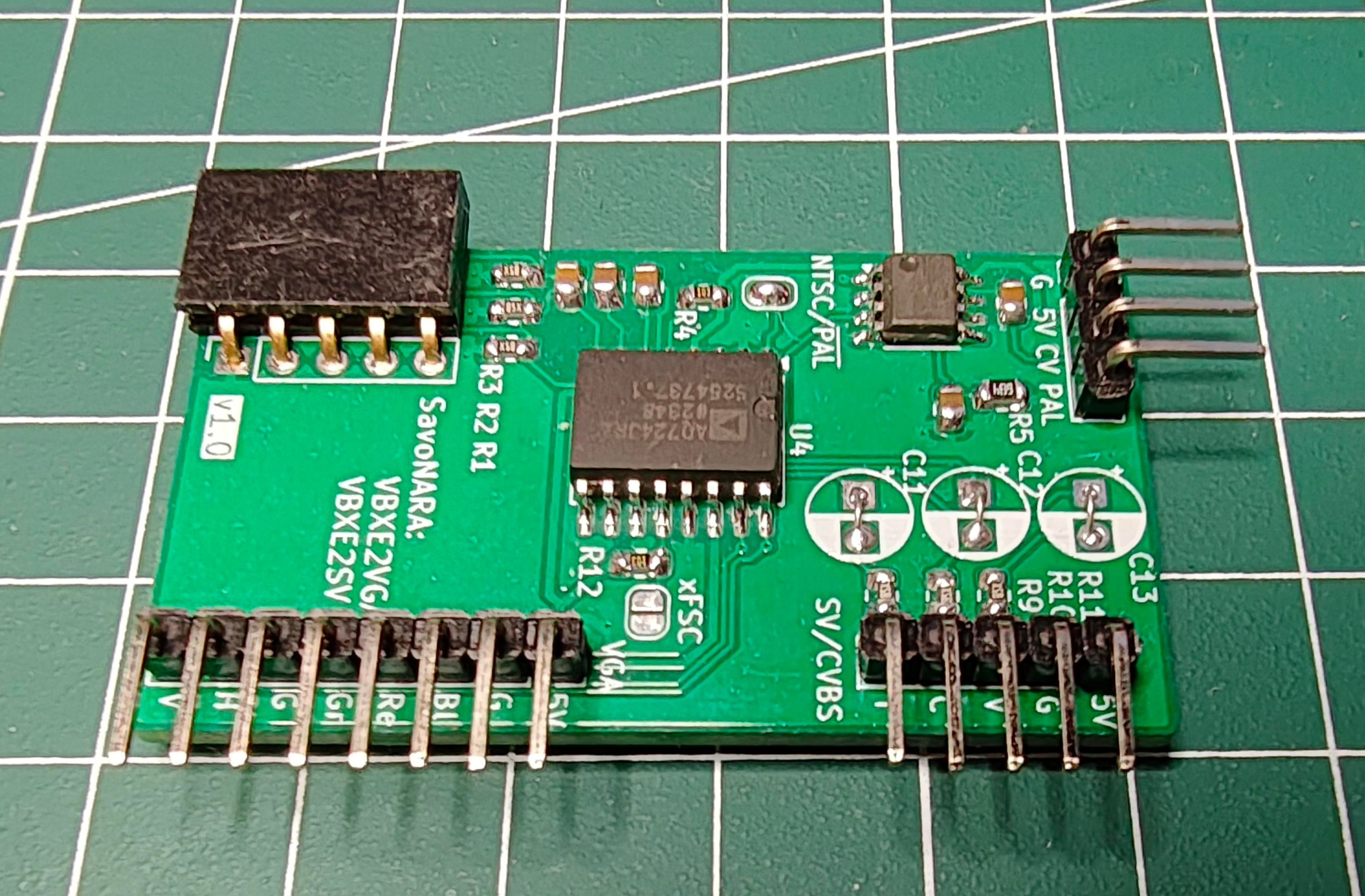

Completed and fully equipped board configured for PAL system:
One notice here regarding variant v1.0.x... there is no need to have big capacitors (220uF) on the output on SVIDEO and CVBS for PAL - it shall be replaced by short circuit by using wire - I leave these capacitor's footprints because I have no idea that these shall be use for NTSC or not. Probably not but I have no one NTSC TV at home for test:
