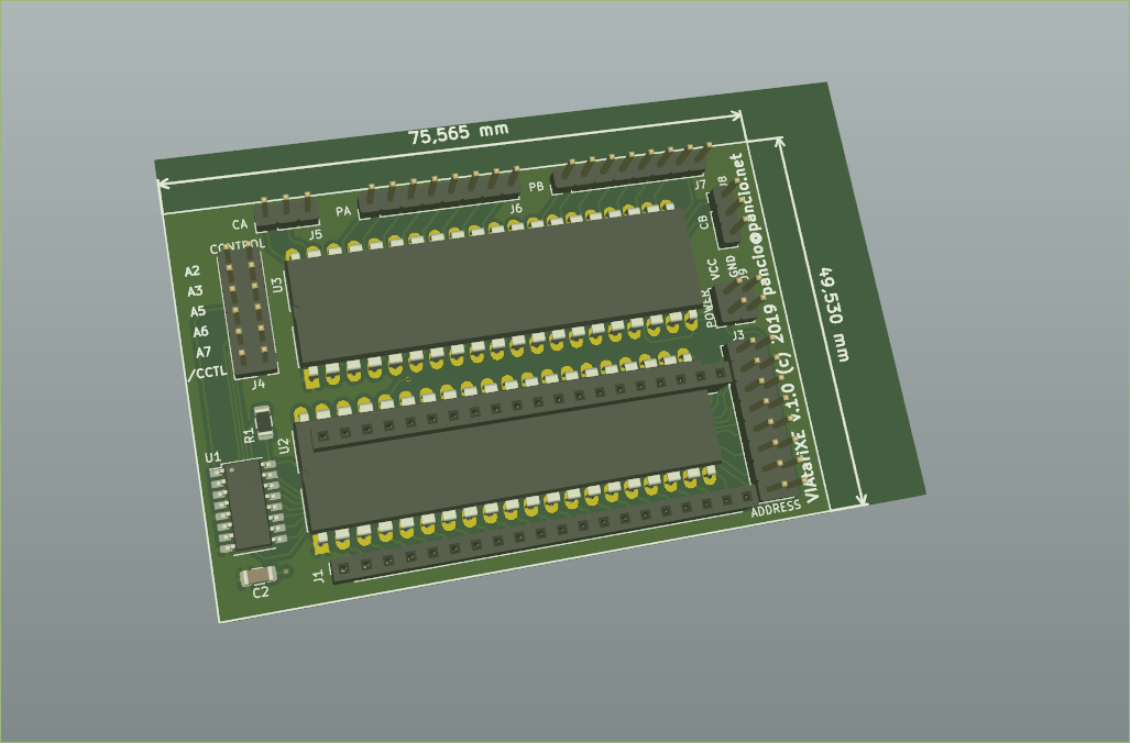

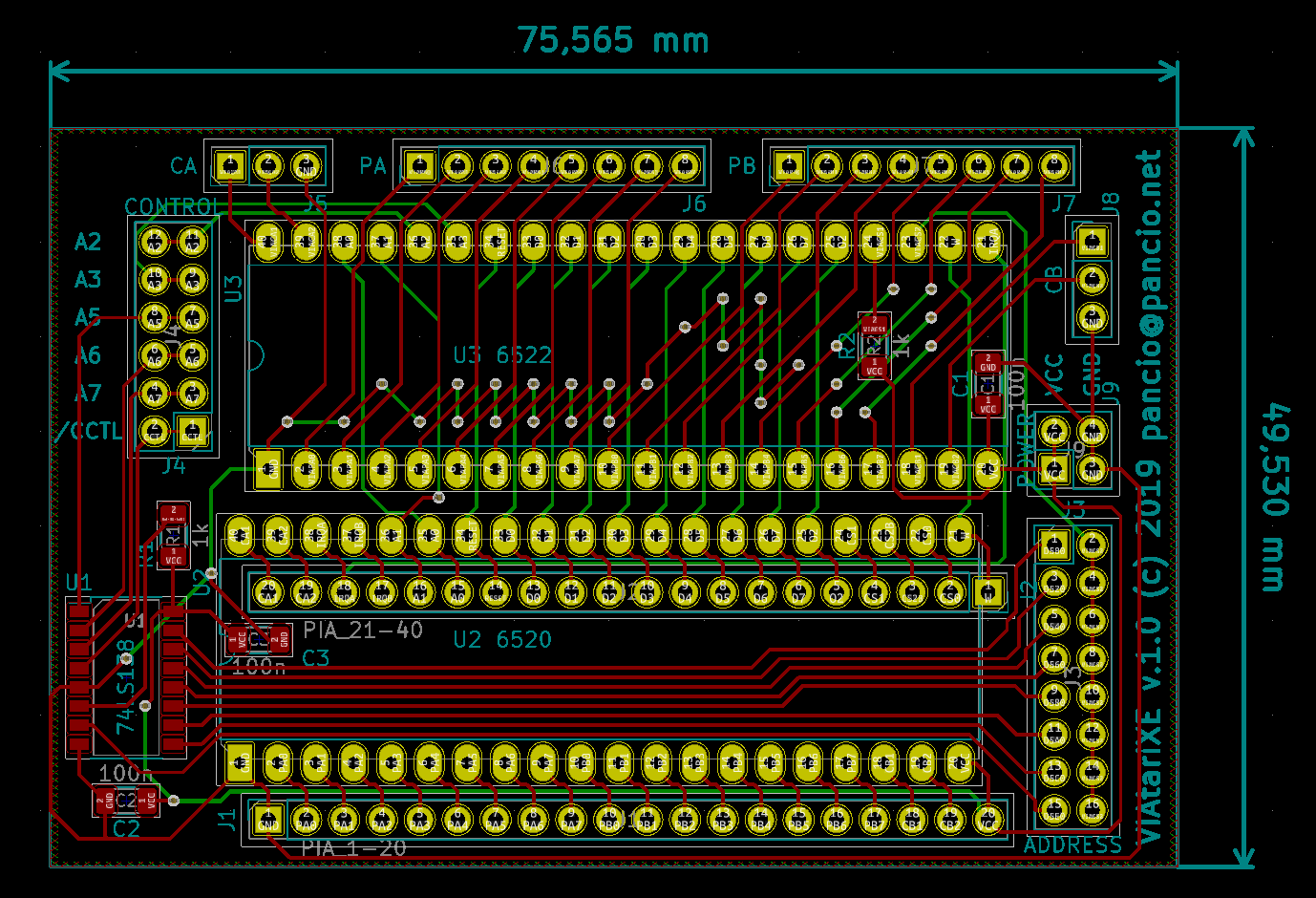

As last time (SRAM 512k extension module) I made the schematic and PCB using KiCAD (actually I'm so surprised how good is this software!). Below you may find schematic and PCB layout:

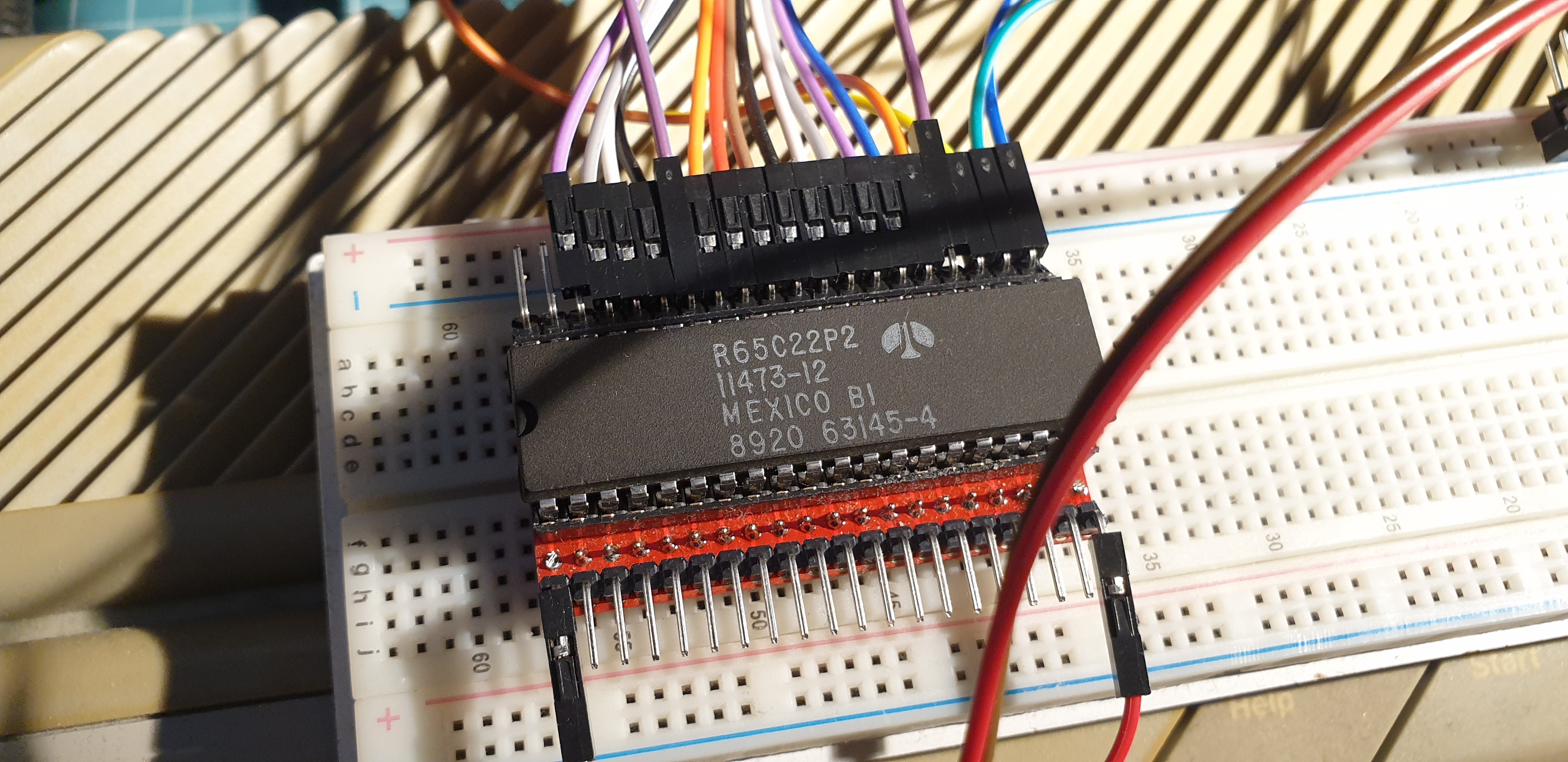

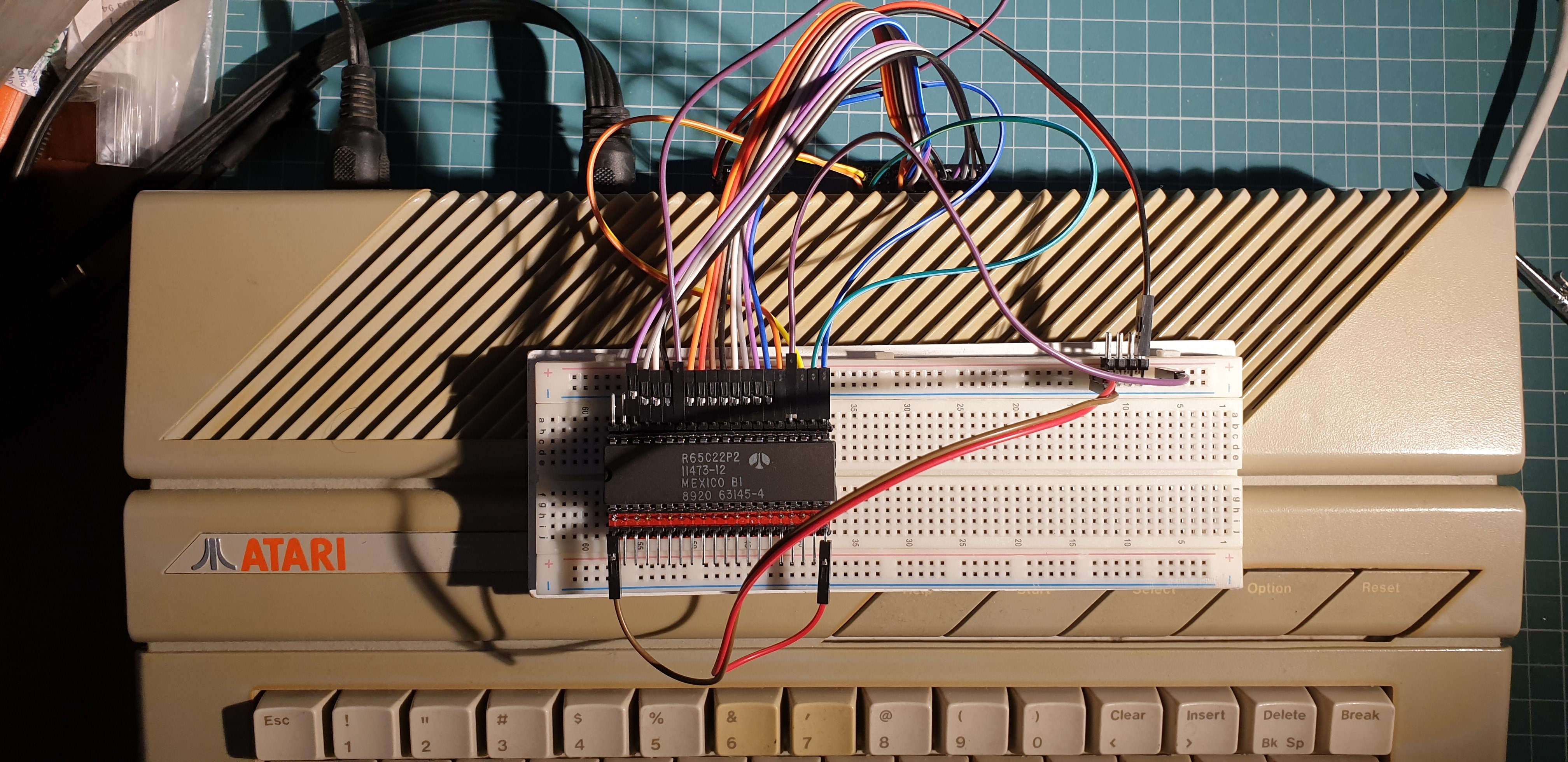

Prototyping on the breadboard:
Prototype on the BB
Prototype on the BB
Prototype on the BB
Prototype on the BB

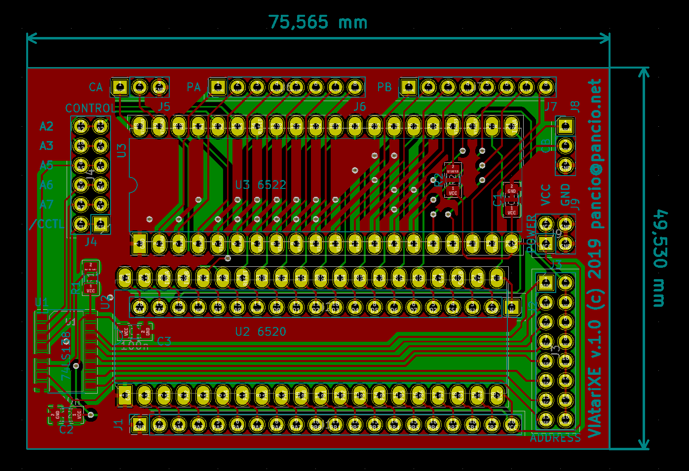

PCB layout:
Prototype on the BB
Prototype on the BB
PCB without polygons
PCB with polygons
PCB with polygons

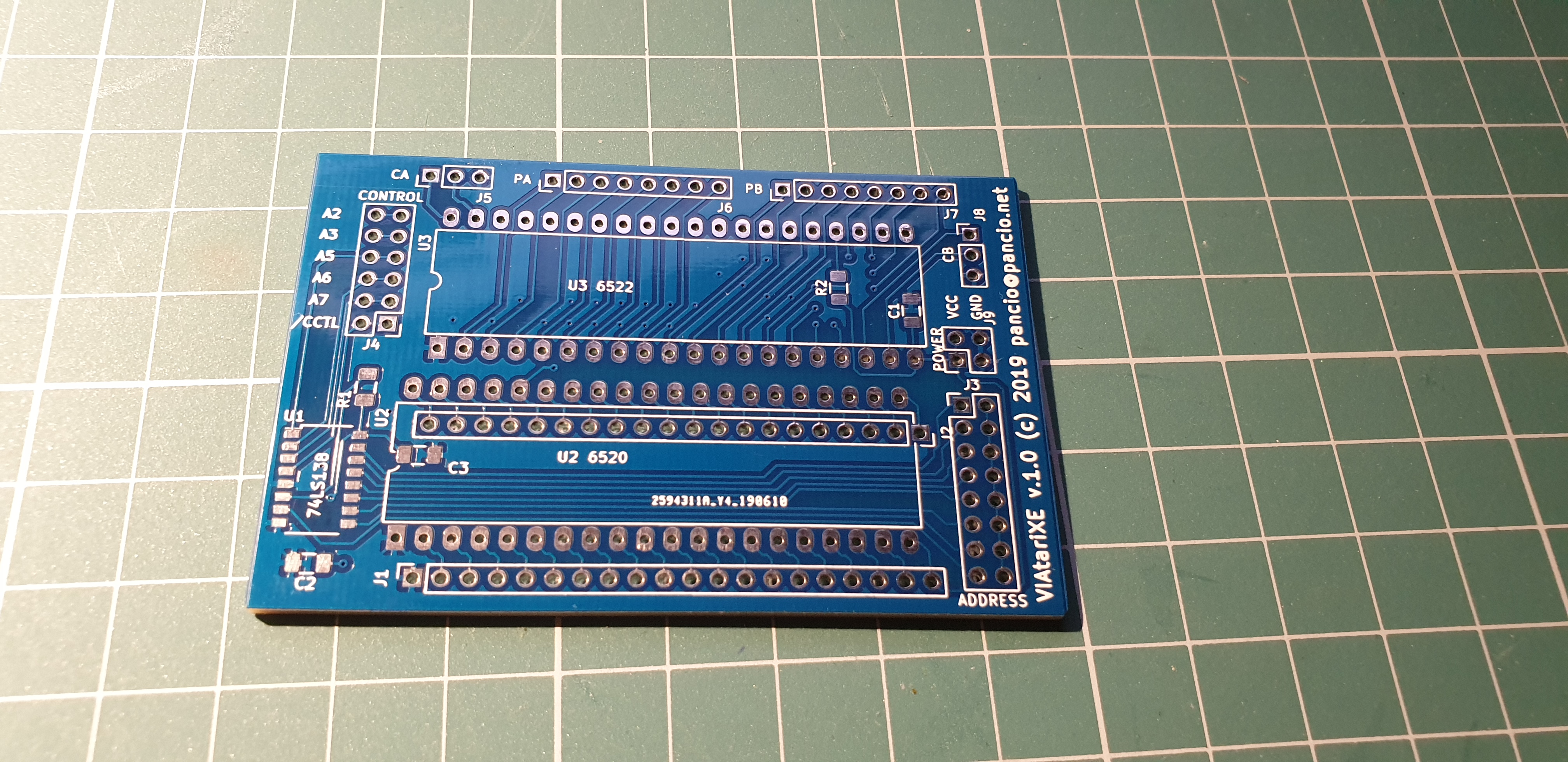

PCB without elements:
3D view
3D view

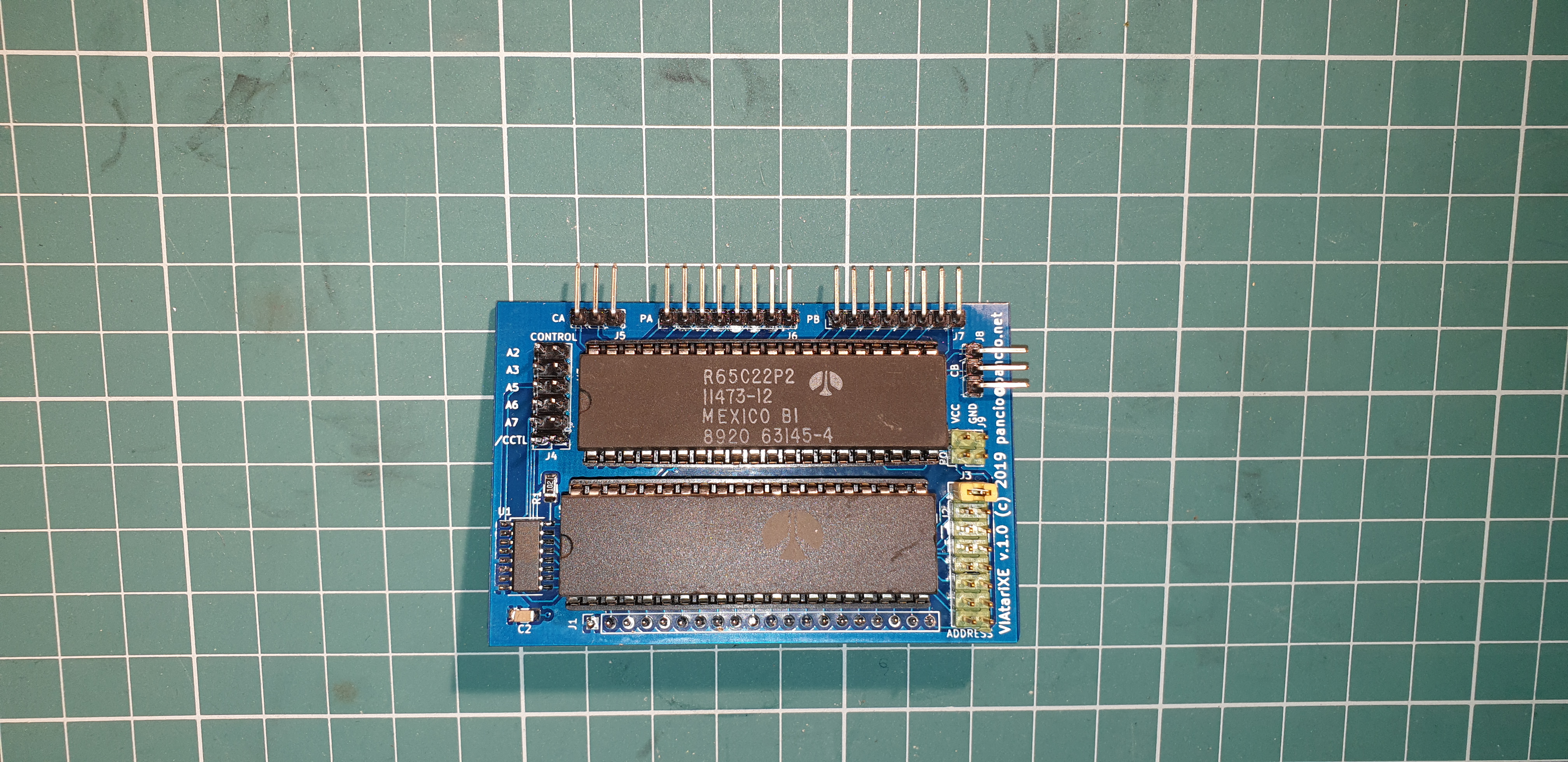

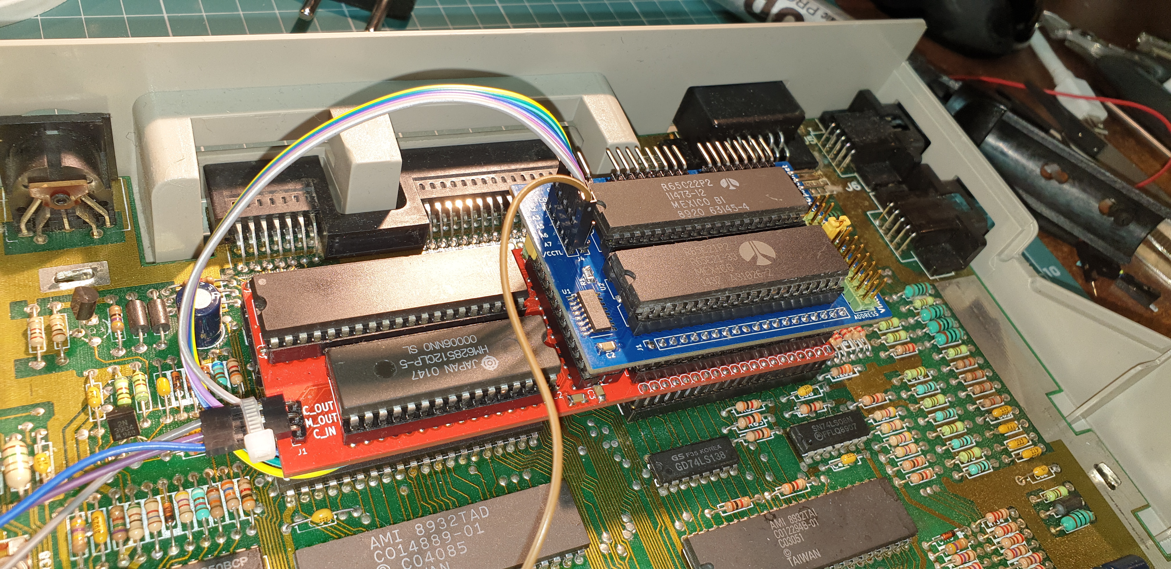

Assembled PCB:
Arrived PCB
Arrived PCB

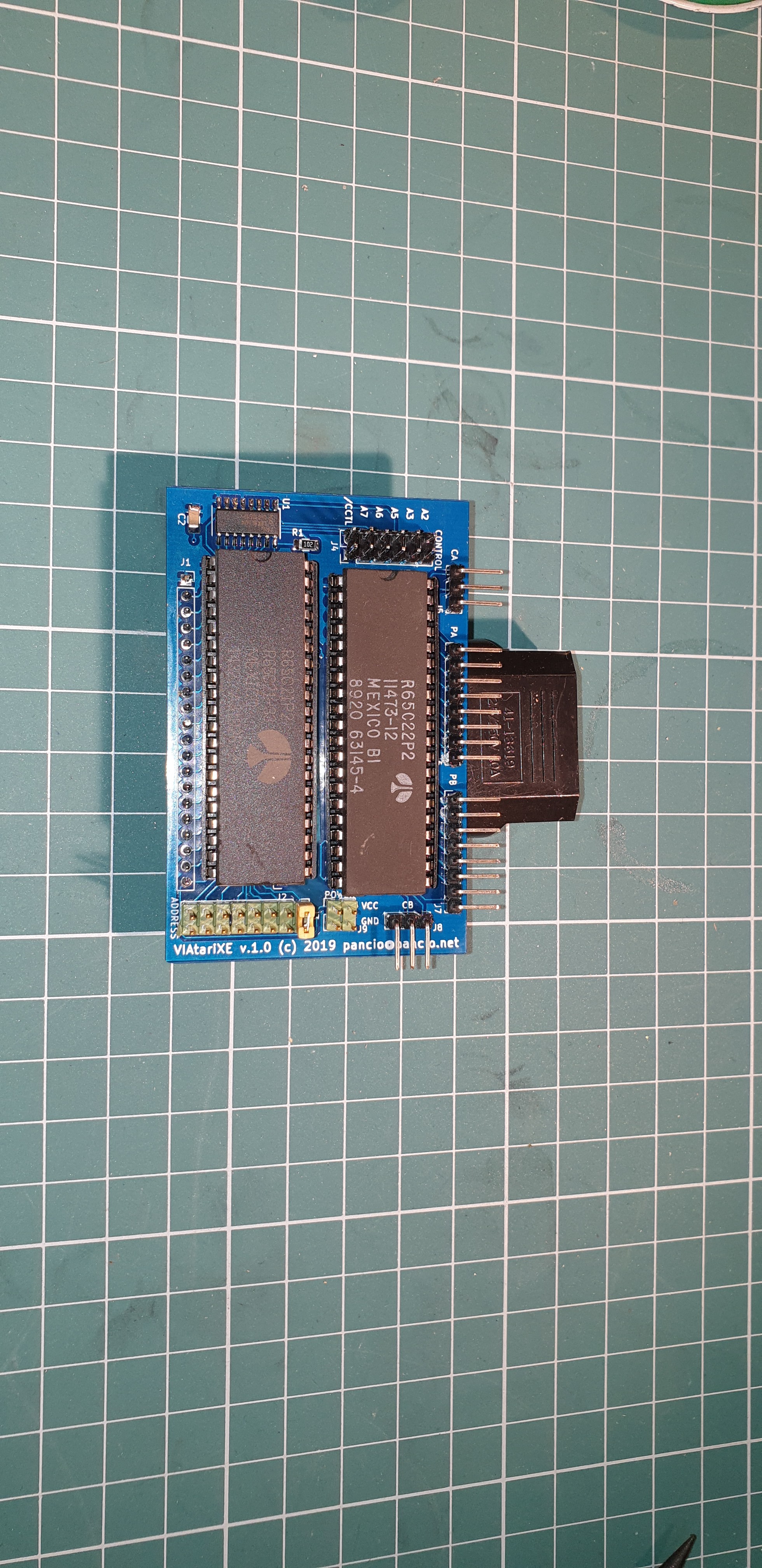

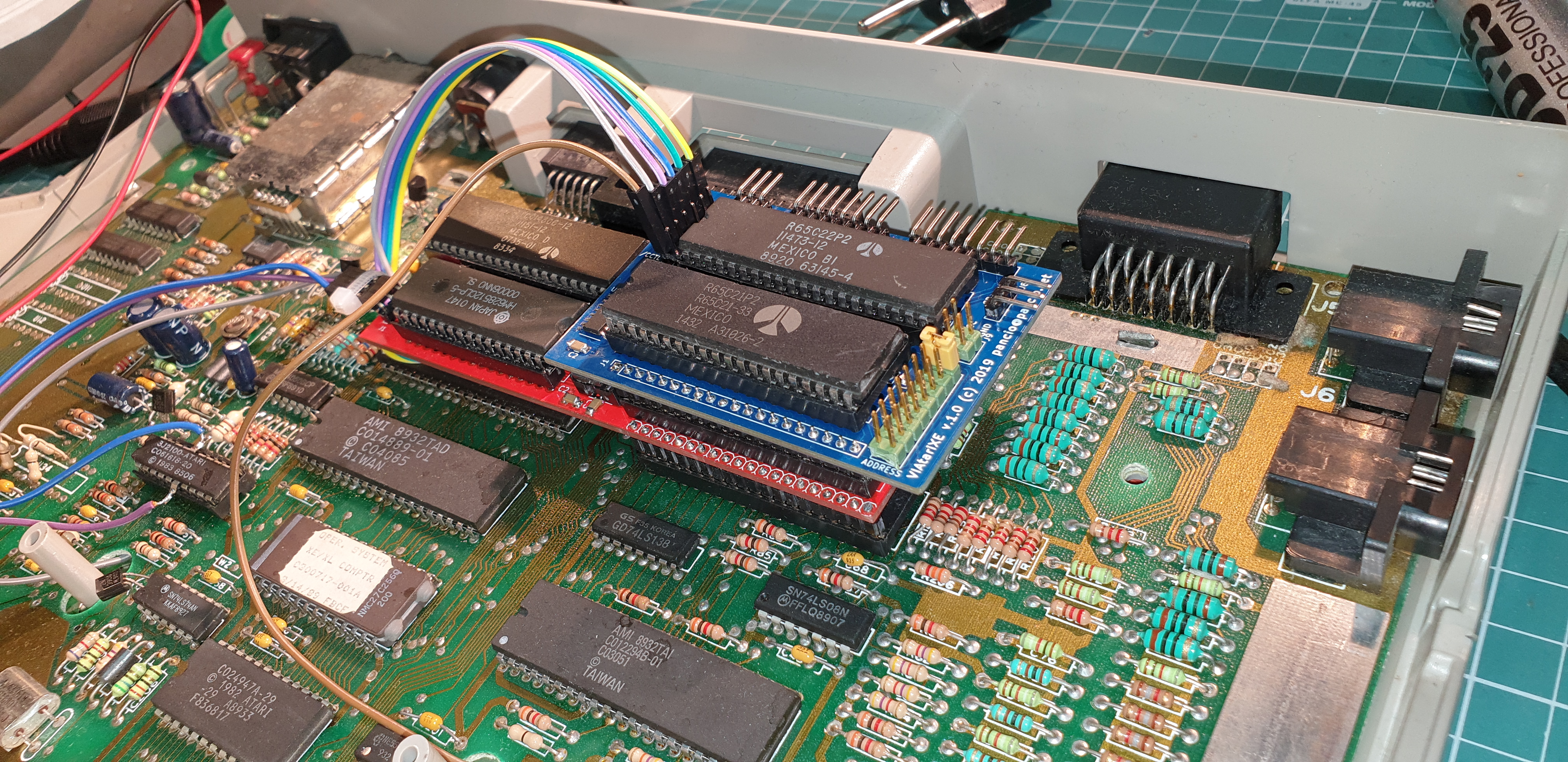

And finally, mounted into Atari:
