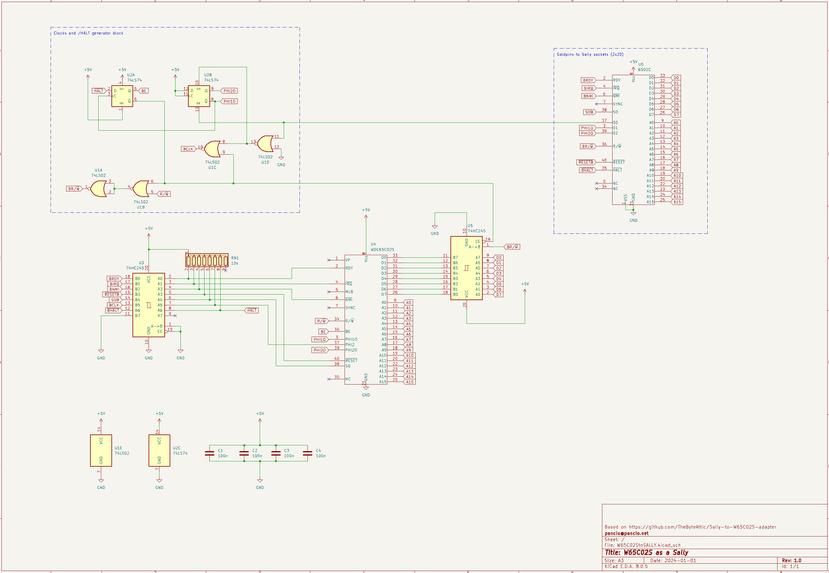

3. Dedicated board under the processor with full buffered buses and signals - we can use the entire buffered signal, e.g. as in W65C02S for the Sally adapter: https://github.com/TheByteAttic/Sally-t ... Schematics %20W65C02S%20to%20Atari%20Sally%20Adapter%2020%20August%202020.pdf
Of course, this is just an example - you need to prepare a mezzanine. See "Clocks and /HALT generator block" on attached schematic.

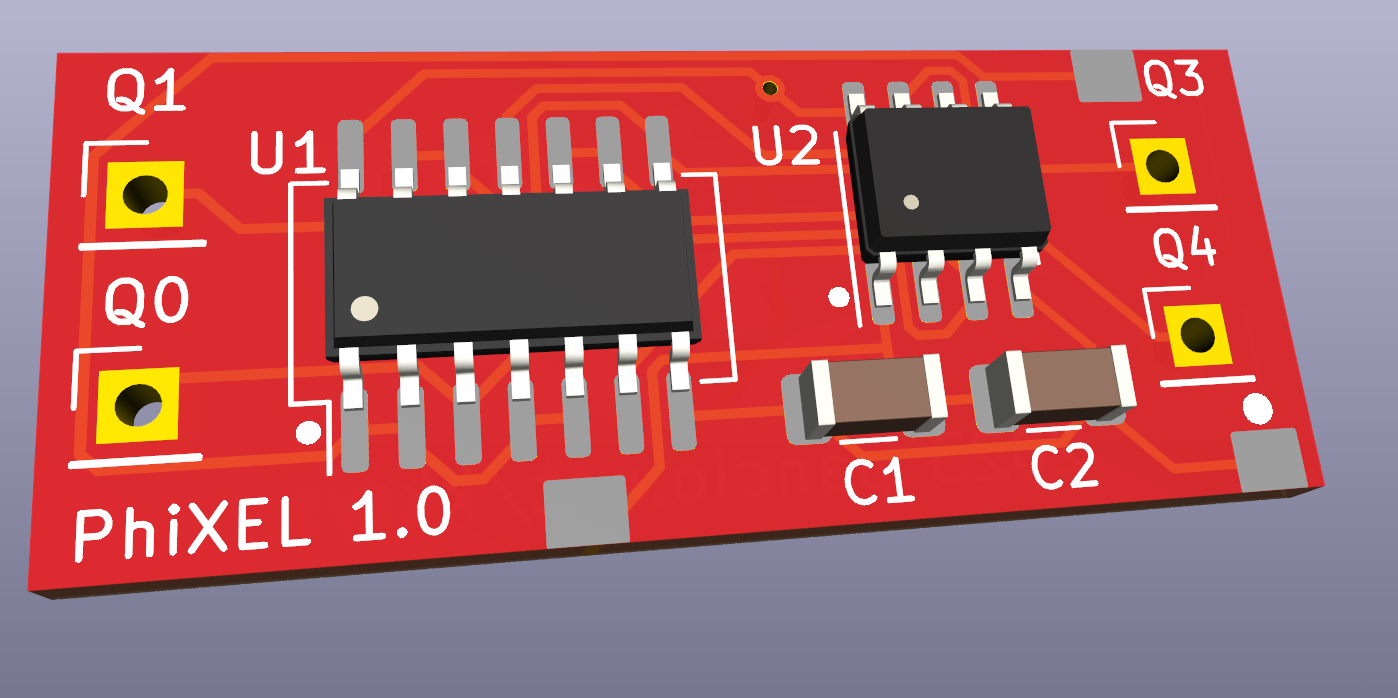

PhiXEL-PCB-3D Visualization
PhiXEL-visualization.mp4
PhiXEL 3D View Visualization

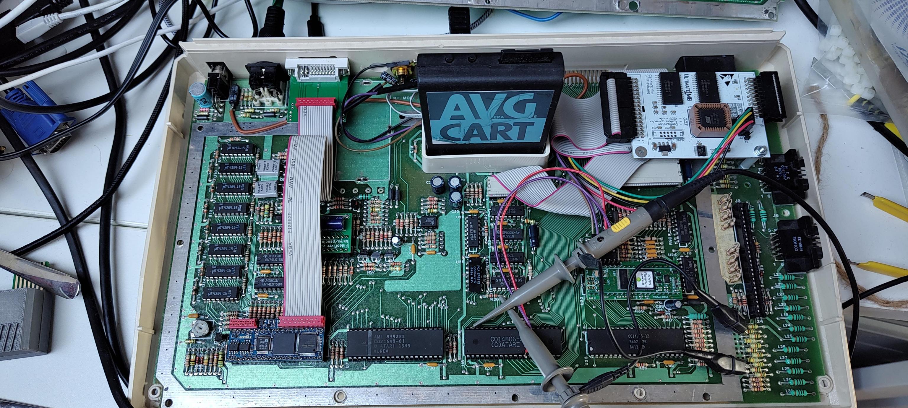

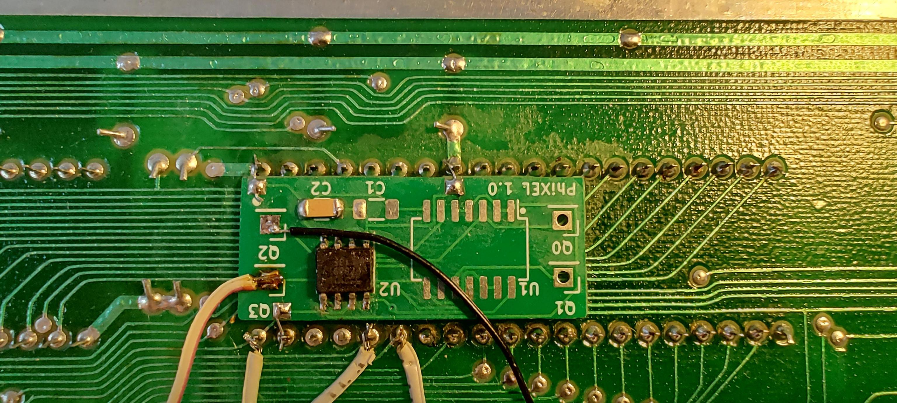

I decided to install PhiXELv1 in my 800XL (without Freddy) because on board I've U1M, PokeyMax and other additional equipment... At First I use only Phase-Locked Loop chip only.
PhiXEL with PLL chip only
PhiXEL with PLL and A800XL

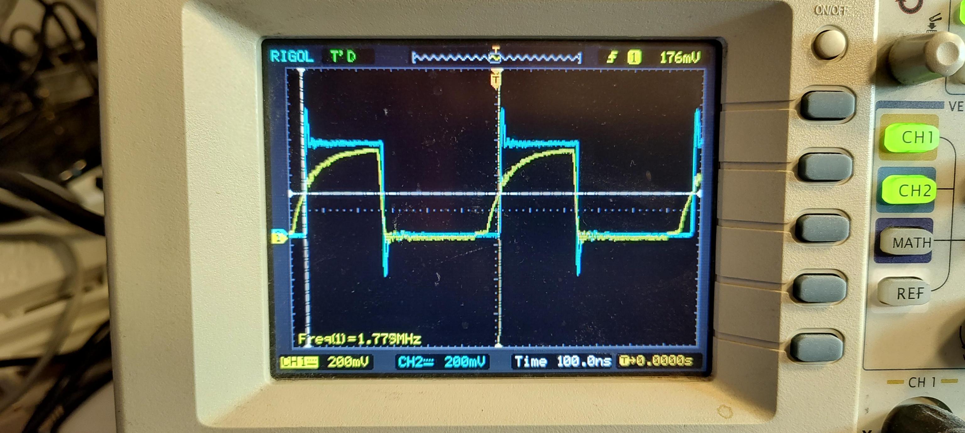

In the picture below you can see what PHI2 should look like and what it looks like in reality... It's amazing how pure it is directly on CPU pin 39 (yellow one)!
PHI2 buffered vs. original
